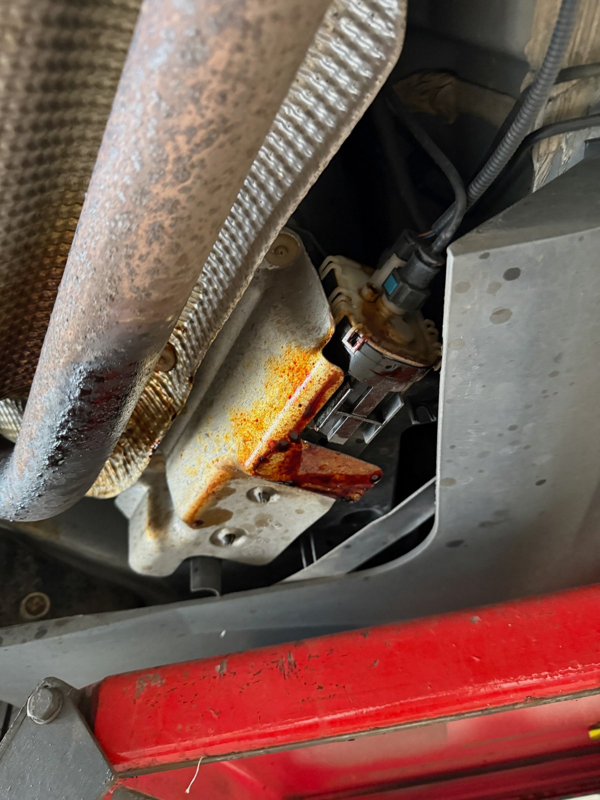

Hello,
I have noticed that my DS4 has a orange liquid leak near the rear wheel, but I have no clue what component is it. Could you guys help me to figure out and tell me how critical is it?
Thanks in advance.

Is your car a diesel? I wonder whether it might be leaking Eolys.

On your car the eolys fluid might be in a pouch which could be leaking and need replacing.
