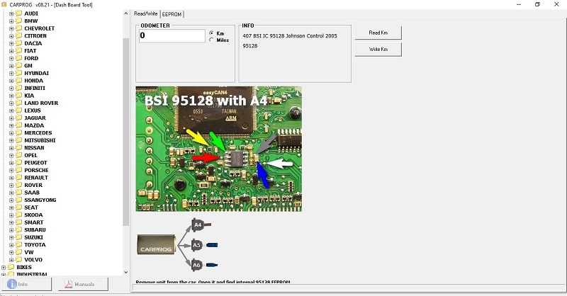

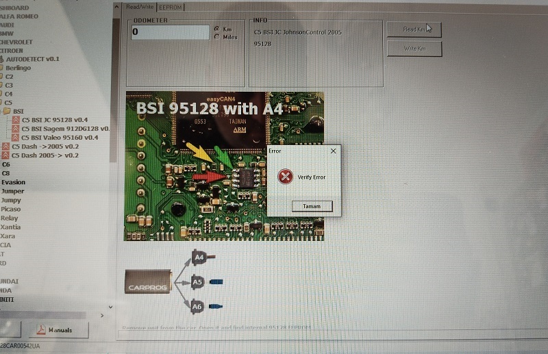

hello friends, 2007 citroen c5, how can i read BSI 95128 eeprom with carprog, i try the connection diagram shown in chinese clone carprog but it doesn't work, please help me

Have you tried with a SOIC clip?
If its not reading with that you may need to de solder the chip & read out of circuit.

Is it resin or lacquer? Would be unusual to see resin on a component used inside the car.
If Lacquer just carefully run the tip of your soldering iron down each leg of the chip then clean with a fibreglass pen.
Should read ok in circuit with SOIC clip.
