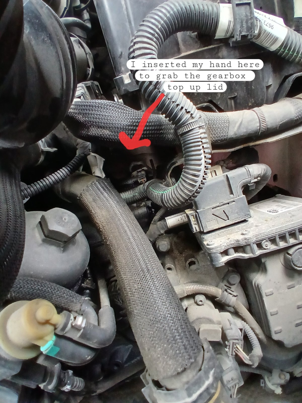

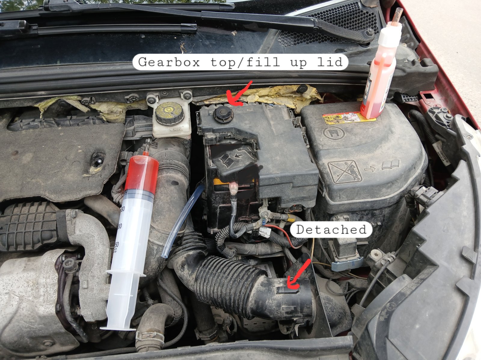

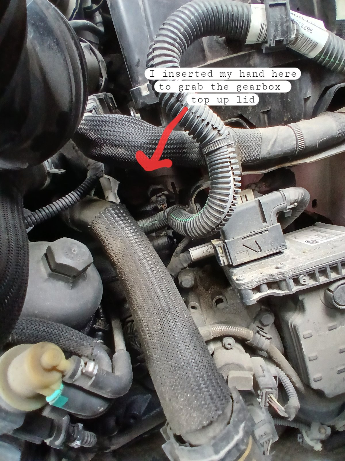

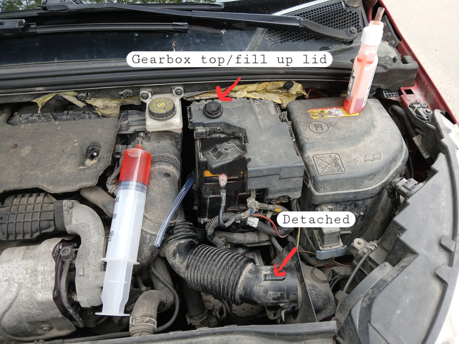

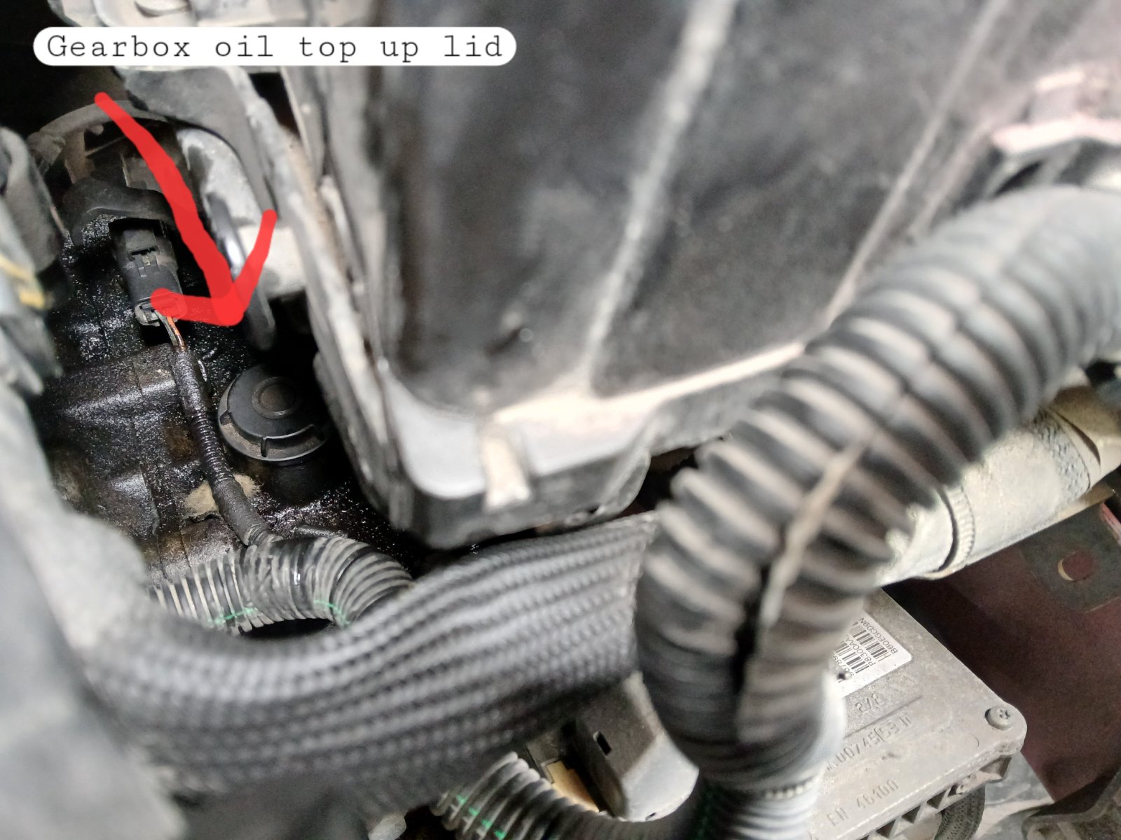

How I poured additive into gearbox (pics):

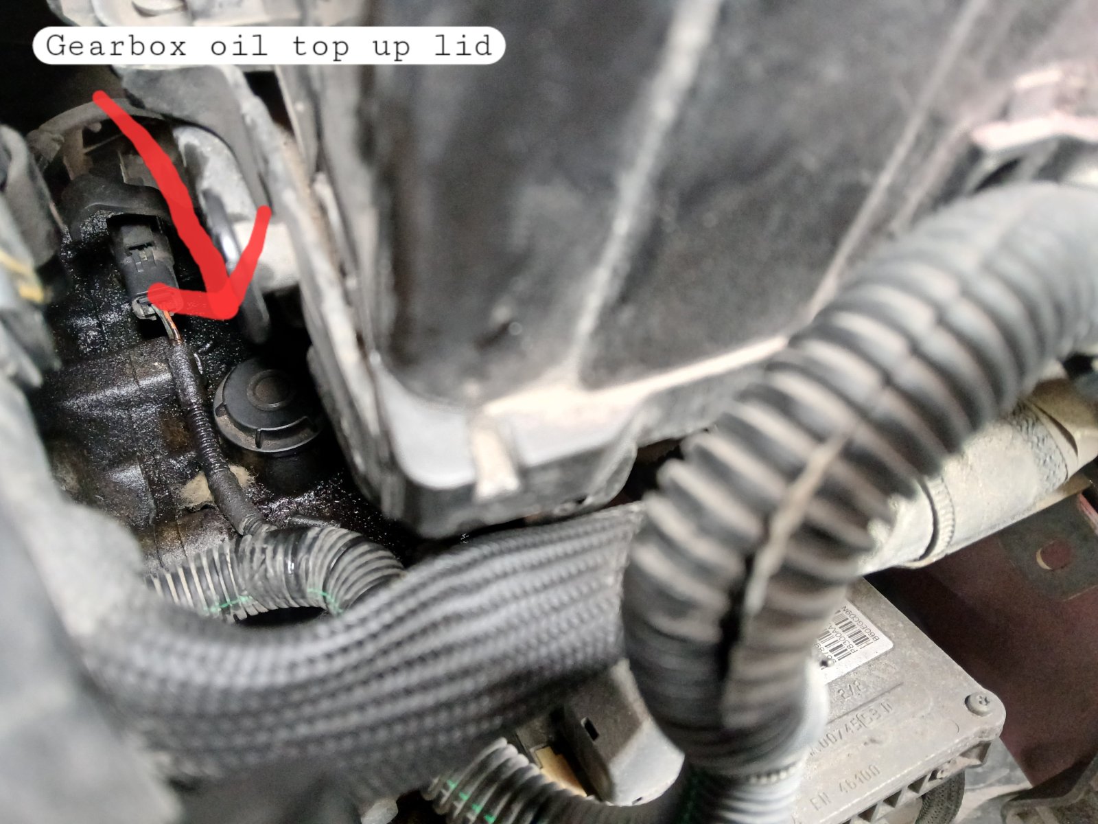

First I detached the lower end of the air intake pipe to make more room for my hand. Then I inserted my hand, palm up, into the area where the gearbox oil refill lid is located and turned my palm down, pulled off the lid and turned palm up again with lid between my fingers and pulled my hand out. A plastic bag covered my arm against scratches with holes for my fingers. The pump nozzle was shortened to improve the flow of the thick fluid.

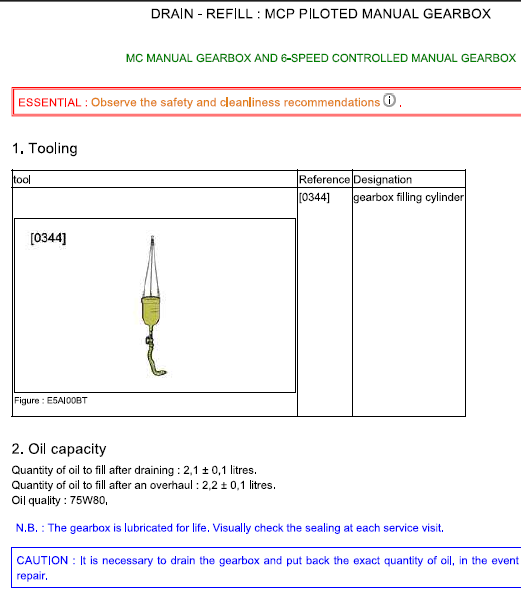

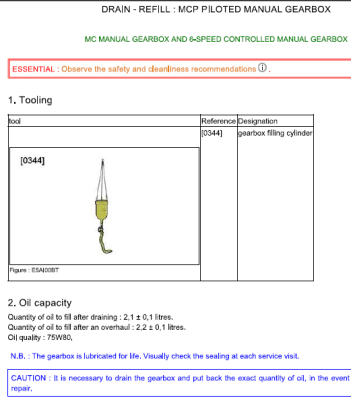

The gearbox oil specification is PSA Peugeot/Citroën B71 2330. 2.1L +/- 0.1L refill after draining (semiauto/manual). B71 is C4 II.

Can you specify little further how to locate the fill plug for gearbox oil? My car is C4 2011 automat.

Hi akerolf.
The filler plug is almost directly below the black battery tray. In the picture, you can follow the transparent PVC hose (next to the syringe with red additive fluid) back to the oil filler cap/lid. You’ll need a flashlight to see the lid clearly.
Without checking your VIN number you either have the semiauto version with small knob actuator handle in the center console (automated manual transmission) with gear shifting paddles behind steering wheel or the manual version with regular "big" gear shifter and no paddles.
If it is a C4 II (B7), then the gear oil spec is B71 2330, which is same for both semiauto and manual. There should still be 2.1 litres in the gearbox since car left factory because gearboxes have low temperature and don't consume oil unlike car engines. If the gearbox oil level is low because of leakage, you'd get a low gearbox oil error code in the OBD2 scanner. So I assume your car still has 2.1L in the gearbox.
There is no dipstick to check gearbox oil level. If you drain the gearbox you can see how much it is by collecting it in a measuring bottle or weigh it on a scale and pour back in an equal amount through the top refill (venting mount) hole. If you overfill a little bit, you may be able to use a syringe and hose to suck the surplus back out through the same top refill hole.
Do you have a problem with your gearbox, any symptoms? If not, I recommend simply topping up with 125ml of gearbox oil additive. This is more convenient than draining and refilling.

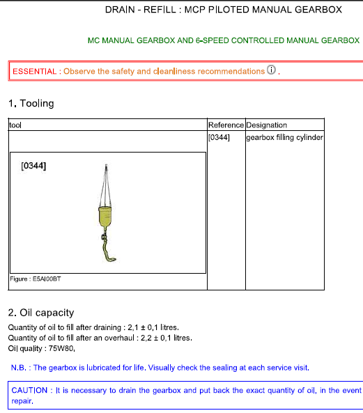

To correct several critical misconceptions regarding the EGS6 (MCM/BVMP6) transmission, and to rectify some of my own earlier comments, here is the definitive breakdown of PSA product descriptions, fluid volumes, and additive chemistry for vehicles like the Citroën C4 B7 and Peugeot 3008:
Fluid Level Warning: First, it is a dangerous myth that a low mechanical gearbox oil level from a leak will trigger an OBD2 error code or dashboard symbol. The mechanical gearbox housing completely lacks an electronic level or pressure sensor; it can leak until bone-dry and self-destruct without warning. The warning symbols and error codes people experience related to "low fluid" actually stem exclusively from pressure loss in the completely separate electro-hydraulic actuator unit (which uses a distinct hydraulic fluid, such as Tutela CS Speed, not the gear oil).
Volume Specifications: Second, regarding oil capacity for the EGS6: The official factory specification dictates a refill volume of 2.1 liters (±0.1L) after a standard drain and refill, and 2.2 liters (±0.1L) following a complete overhaul. (Note: Newer ETG6 evolutions from 2013/2014 onward utilize a physically redesigned, smaller casing revised by PSA to a 1.7-liter capacity to optimize efficiency). When incorporating the Mannol 9903 additive, combine 2.0 liters of fresh gear oil with the 50ml additive. This total volume of 2.05 liters safely matches the standard maintenance target while remaining well below the maximum dry overhaul capacity.

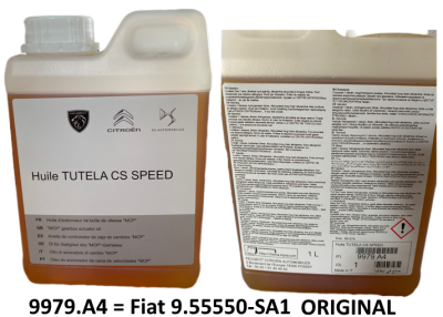

Mannol 9929 Profile: Third, regarding Mannol 9929 (Ester Additive): Mannol’s official website states that 9929 is an "additive to engine oils and to oils for mechanical transmissions". While highly fluid and possessing a high viscosity index, its core chemical package is optimized for internal combustion environments, containing ZDDP and heavy detergents designed to prevent deposits of lacquers, resins, and sludge. At a 5% to 10% mixing ratio, adding these components to a dedicated PSA B71 2330 gear oil risks altering the precise friction coefficient required by the synchronizer rings. If the friction baseline shifts, it can delay synchronization windows, causing the automated TCU shifting logic to register sluggish engagement or actuator stress. Furthermore, these engine-specific detergents can actively compete with the transmission's native Extreme Pressure (EP) surface additives.
Mecarun P18 Profile: Fourth, regarding Mecarun P18: While Mecarun P18 is also marketed for universal applications ("for engines, manual and automatic gearboxes"), its chemistry differs fundamentally from Mannol 9929. P18 is not an engine oil concentrate with detergents; it is a highly refined hydrocarbon-based friction modifier engineered to form a micro-thin boundary tribofilm on metal surfaces under heat and pressure. It does not introduce engine-specific cleaning detergents or risk thickening the fluid layout. However, in a computer-controlled robotized transmission like the EGS6, applying a highly potent anti-friction surface treatment at a standard 4% ratio still introduces an operational variable. Because the TCU monitors synchronizer engagement down to milliseconds, making the synchronizer rings excessively slick can cause them to slide rather than grip properly, potentially triggering delayed synchronization codes.
Universal LS Limitations: Fifth, regarding Universal API GL-4/GL-5 LS (Limited Slip) Oils (e.g., Mannol Unigear 75W-80): Many universal gear oils list the PSA B71 2330 specification alongside "API GL-5 LS" on the bottle. While modern additive chemistry can technically balance GL-5 shear protection with synchromesh compatibility using inactivated sulfur, the "LS" (Limited Slip) designation introduces a critical mismatch for automated manual gearboxes. Limited Slip additives utilize potent friction modifiers specifically engineered to allow wet clutch packs inside a limited-slip differential to slide smoothly and prevent chatter. In an EGS6 gearbox, the synchronizer rings act as mechanical brakes that must instantly grip the gear cone to match shaft speeds within milliseconds. Introducing a fluid chemically modified to prevent friction surfaces from grabbing directly opposes the transmission's synchronization requirements. Any extended synchronization slip can trigger immediate shifting faults, shift logic delays, or actuator timeouts.
Fluid Recommendations: Sixth, the best approach for the EGS6 gearbox is to avoid universal multi-vehicle lubricants, engine-targeted packages, or combined API GL-4/GL-5 formulations. While a standard 2L refill of the older PSA B71 2330 specification works (such as TotalEnergies Traxium Gear 8 or Fanfaro Max 7), the ultimate setup for a high-mileage unit is 2L of a fluid meeting the newer, more advanced PSA B71 2315 specification, topped up with 50ml of transmission-specific Mannol 9903 Getriebeoel-Additive. This combination ensures exceptionally fast actuator response during freezing winter mornings thanks to the lower viscosity and superior base oil of the 2315 standard, while the Group V esters from the 9903 provide a permanent, high-strength boundary layer on the gear flanks when hot. Prime examples for the 2315 base are Shell Spirax S4 G 75W-80 or Ravenol PSA SAE 75W-80, which are pure API GL-4 oils; these should not be conflated with API GL-5 fluids carrying the same approval (such as the Liqui Moly variant), as pure GL-4 chemistry is critical to preserve proper synchro friction.

1. Drain and refill the mechanical gearbox with exactly 2.0 to 2.1L of a high-performance oil. Your two best pathways are either the ultra-premium PAO-based Ravenol MTF-2 75W-80 or a dedicated B71 2315 oil like Shell Spirax S4 G 75W-80 or Ravenol Getriebeoel PSA SAE 75W-80 (for the thinnest warmup flow and exact OEM specification).
2. Depressurize the actuator, extract old fluid, and refill reservoir with fresh fluid. The system holds around 0.9L of fluid in total, but a standard reservoir drain and refill will extract about 0.5L to 0.6L. Your best options are:
- Motul Multi HF (Green) for the ultimate compromise: extreme cold-start flow combined with official actuator specs (PSA 9979.A4 / Fiat 9.55550-SA1) containing the required clutch/valve friction modifiers.
- Pentosin CHF 11S / Febi Bilstein 06161 (Green) for extreme flow under steering specs, backed by proven SMG and DSG actuator pedigree.
- Petronas Tutela CS Speed / OEM 9979.A4 (Light golden-amber) or Ravenol GHA-F (Green) for the strictly dedicated, factory-grade actuator setup.

Actuator Hydraulic Fluid: Spec Sheets vs. Real-world +10C Viscosity
The EGS6 is essentially two separate systems: the mechanical gears (lubricated by the 75W-80 gear oil) and the electro-hydraulic robot actuator on top (which operates the clutch and shifts the gears). They have entirely separate fluid reservoirs, but they must work in perfect harmony as equal partners.
While fresh gear oil perfectly restores the synchronizer speed and eliminates mechanical shifting hesitation, the hydraulic actuator fluid is what physically powers the robotic movements. Over the years, this fluid degrades, turns black, absorbs moisture, and fills with micro-debris. When the fluid ages, the small electric pump struggles to build the required 40 to 50 bar of pressure quickly—especially on freezing winter mornings when the fluid becomes thick and sluggish. This prevents the hydraulic valves and clutch actuator from physically moving fast enough, leading to persistent cold-weather hesitation and clutch judder even after a gear oil change.
For those wanting the absolute lowest fluid resistance (lowest viscosity) for fast, responsive gear changes on a typical +10C European morning, we can use ASTM D341 interpolation to find the exact kinematic viscosities (cSt) at +10C.
Kinematic viscosity ranking at +10C (from thinnest/fastest flow to thickest):
1. Motul Multi HF (Central Hydraulic Fluid, PSA 9979.A4 & Fiat 9.55550-SA1) / Pentosin CHF 11S (or Febi Bilstein 06161 - carrying heavy-duty BMW SMG & VW DSG actuator specs alongside PSA S71 2710)
- Base data: 18.7 cSt at +40C | VI: 313
- Viscosity at +10C: approx. 39.8 cSt
2. Ravenol GHA-F (Gearbox Hydraulic Actuator Fluid, PSA 9979.A4)
- Base data: 19.7 cSt at +40C | VI: 333
- Viscosity at +10C: approx. 40.5 cSt
3. Petronas Tutela CS Speed (Factory Fill, Fiat 9.55550-SA1 / OEM 9979.A4)
- Base data: 24.22 cSt at +40C | VI: 270
- Viscosity at +10C: approx. 56.1 cSt
Why the factory oil causes a sluggish experience: Petronas Tutela has the lowest Viscosity Index (270) and starts the heaviest at +40C. At +10C, it thickens to 56.1 cSt, which is over 40% thicker than its rivals. This extra viscosity is what causes the actuator block to feel sluggish during the first few kilometers.
The thinnest fluids (Motul Multi HF, Pentosin/Febi 06161, and Ravenol GHA-F) are tightly grouped between 39 and 41 cSt. While Ravenol's high VI of 333 keeps its curve flat as it gets colder, Motul Multi HF and Pentosin CHF 11S take first place as the thinnest fluids at +10C thanks to their low 40C starting point of 18.7 cSt. Note that while the factory-original fluids are orange or yellow-straw, these high-performance synthetic alternatives are dyed green.
With any of these top fluids in the actuator reservoir, the hydraulic pump faces less resistance, leading to faster pressure accumulation (reaching the 40-50 bar target quicker on startup) and more exact solenoid valve modulation. Because the thinner, high-index fluid flows faster through the microscopic valve channels when cold, it heavily reduces the cold-weather shifting hesitation or clutch judder before the system reaches operating temperature.
Note on parts database compatibility (such as Autodoc): In the official Peugeot/Citroën service manual, the EGS6 actuator is classified as a "closed, lifetime-filled" unit. Therefore, parts catalogs like Autodoc completely lack an official category for EGS6 actuator fluid. This leads to major database paradoxes. First, if you search for Petronas Tutela CS Speed (the actual factory-fill fluid), it will not list the PSA 9979.A4 specification on the site. This is because Petronas only labels the commercial bottle with the original Fiat 9.55550-SA1 standard (which PSA's robot supplier, Magneti Marelli, designed the system for). In reality, Fiat 9.55550-SA1 and PSA 9979.A4 are completely interchangeable because the EGS6 and the Fiat Selespeed are the exact same Magneti Marelli hydraulic robot.
Second, if you search for Febi Bilstein 06161 or Pentosin CHF 11S, they will show as "compatible" simply because they are cataloged under the vehicle's electro-hydraulic power steering (EHPS) system, which also officially requires the PSA S71 2710 standard. While Febi 06161 officially lists PSA S71 2710, it does not list the EGS6 clutch actuator spec (PSA 9979.A4). However, unlike standard power steering fluids (such as Total Fluide DA, which strictly only carries the basic PSA S71 2710 spec), Pentosin CHF 11S / Febi 06161 carries a massive list of heavy-duty electro-hydraulic actuator specifications. This includes BMW 83 29 0 429 576 (the factory fill for Magneti Marelli SMG II & SMG III sequential manual gearbox actuators—the exact same manufacturer that designed the PSA EGS6 robot!) and VW G 004 000 M2 (the factory spec for DSG DQ200 mechatronic clutch actuators). This proves that CHF 11S / Febi 06161 is highly engineered for high-pressure clutch solenoids and piston seal modulation, making it a highly compatible, technically superior alternative to standard steering fluids.
Why is Factory Tutela CS Speed Thicker? The Defensive Trade-Off
If fluids like Motul Multi HF and Pentosin CHF 11S flow faster at both +10C and sub-zero temperatures, why did Petronas and PSA optimize Tutela CS Speed to be thicker? The answer lies in defensive engineering. When designing the EGS6 actuator, PSA and Petronas prioritized high-temperature pressure stability and mechanical component longevity over extreme cold flow:
First, high-temperature internal leakage protection. The EGS6 actuator operates under high pressure (40-50 bar). Under heavy motorway driving or stop-and-go summer traffic, the hydraulic block gets extremely hot. At high temperatures, a fluid that starts very thin becomes highly volatile and thin. This increases the risk of internal bypass leaks through the solenoid valves and seals. If pressure drops due to internal leakage, the electric pump must run much more frequently to maintain pressure, accelerating pump wear. Tutela's heavier profile (24.22 cSt) ensures sufficient fluid "body" to maintain pressure stability when scorching hot.
Second, anti-shudder friction additives vs. viscosity dynamics. To understand why a fluid like Motul Multi HF is such a powerful upgrade, we must separate how viscosity and friction modifiers independently affect the shift:
- Viscosity (cSt at 40C) controls shift SPEED: The EGS6 pump must force fluid through microscopic solenoid valves to actuate the heavy shift rails and clutch fork. Because cold Petronas Tutela is thick (56.1 cSt at +10C), it meets high viscous drag, making physical shifts feel slow and heavy. By upgrading to a thinner 19 cSt fluid like Motul Multi HF, the hydraulic drag collapses, allowing the system to build pressure instantly and snap the shift rails and clutch into place much faster.
- Friction Modifiers control clutch SMOOTHNESS: While the EGS6 uses a dry clutch, its hydraulic slave cylinder piston relies on rubber seals sliding against a metal bore. Without dedicated anti-shudder modifiers, these seals suffer from "stick-slip" (grabbing and releasing rapidly), causing the clutch to bite in tiny, rapid jerks. This is felt as a shudder or judder during pull-away. Standard steering fluids like Total Fluide DA lack these clutch-modulation friction modifiers, leading to a fast but uncomfortably jerky clutch engagement.
By using Motul Multi HF, you combine the ultra-low viscosity (19 cSt) of a steering fluid with the official PSA 9979.A4 / Fiat 9.55550-SA1 friction package. This delivers the ultimate combination: lightning-fast hydraulic response with perfectly smooth, judder-free clutch modulation.
Unlike Pentosin CHF 11S (Febi 06161), which is fully optimized to prevent seal stick-slip in high-pressure SMG and DSG actuators, basic power steering fluids like Total Fluide DA (which is a synthetic orange fluid designed strictly for EHPS steering pumps under the PSA S71 2710 spec) lack any gearbox actuator pedigree or dedicated friction modifier packages.
The absolute ultimate compromise is Motul Multi HF, which is chemically engineered as a multi-fluid that officially lists both the master steering specification (PSA S71 2710) and the dedicated clutch actuator specifications (PSA 9979.A4 and Fiat 9.55550-SA1). Therefore, Motul Multi HF gives you the ultra-low viscosity of a steering fluid combined with the required friction modifiers for the robotic clutch.
Third, extreme shear stability under pressure. Every gear shift forces the hydraulic fluid through microscopic solenoid orifices under 50 bar of pressure. This extreme mechanical shearing literally chops up polymer chains. Petronas formulated Tutela CS Speed with highly shear-stable molecules to withstand thousands of high-pressure shifts without losing its original viscosity.
Therefore, EGS6 owners must decide on a maintenance philosophy:
- The Factory Defensive Setup (Tutela CS Speed): Optimized to work acceptably under all conditions—from an Arctic winter to Sahara heat—without losing pressure stability or shearing down over the manufacturer's nominal lifetime. It sacrifices responsiveness at +10C to ensure zero leakage at +100C.
- The Low-Temperature / Hybrid Setup (Motul Multi HF): Optimizes for daily cold-start responsiveness, which is the primary drivability issue in temperate/Northern European climates. It officially carries both the PSA 9979.A4 and Fiat 9.55550-SA1 approvals, meaning its fully synthetic shear stability and chemical life are certified for the entire lifespan of the transmission without any abnormal pressure loss.
- The Non-OEM Actuator Pedigree Setup (Febi Bilstein 06161 / Pentosin CHF 11S): Green central hydraulic fluids. While they lack the official PSA 9979.A4 spec, they are heavily proven in Magneti Marelli SMG and VW DSG clutch mechatronics, offering an excellent combination of cold flow and high-pressure wear protection.

Warning: Depressurize Actuator System Before Fluid Change
Do not attempt to simply extract the actuator fluid from the plastic reservoir. The system operates at 40-50 bar, and a large portion of the fluid is stored under high pressure inside the accumulator sphere.
You must use PSA Diagbox / Lexia (or an advanced bi-directional diagnostic tool like Kingbolen Ediag / Launch) to run the "Depressurise hydraulic circuit" command first. This electrically opens the valves and forces all the fluid inside the accumulator back into the plastic reservoir so you can see the true maximum fluid level. Extract the old fluid, and fill with fresh actuator fluid to the MAX line. If you top off a pressurized system, it will violently overflow later when the system rests and the pressure drops. After refilling, prime the pump (e.g. by opening the driver's door) to rebuild pressure, and check for leaks.
EGS6 Maintenance Setup
Summary for EGS6 setup:
3. Perform a Diagbox clutch bite-point and grid re-adaptation to restore shifting smoothness instantly. However, this is not strictly mandatory, as the TCU is self-learning and will slowly adapt to the new fluid over time on its own.

PART 2: Actuator Hydraulic Fluid (EGS6/MCP) – A Warning – The Exotic Car Reality (Tutela vs CHF)
• The OEM Baseline: Magneti Marelli originally engineered these actuators (across Fiat Selespeed, PSA EGS6, and Ferrari F1 / Lamborghini E-Gear) around Petronas Tutela CS Speed (Fiat 9.55550-SA1, rebottled as PSA 9979.A4). This remains the safest choice for routine top-ups and standard servicing on aging, un-rebuilt factory seals.
• The Warning on Fluid Mixing & The Febi Trap (06161 vs 46161) and safety correction regarding my earlier post:
CHF11S/202 are compatible fluids for a cleaned hydraulic fluid tank but again not PSA S71 2710. The primary cause of actuator seal failure when using CHF-type fluids in road cars is fluid mixing. Topping up or partially flushing synthetic CHF (11S/202) into an actuator containing aged, mineral-based Tutela residues causes additive drop-out. Technical reference & analysis by exotic specialist Craig Waterman: https://craig-waterman.com/?p=2123
Furthermore do not use Total Fluide DA/LDS or generic fluids like Febi 06161 which carry no correct PSA or Fiat approvals.
Febi 46161 on the other hand carries the official PSA 9979.A4 and Fiat 9.55550-SA1 cross-references, confirming validated elastomer compatibility specifically for Magneti Marelli robotized actuators.

EGS6 Adaptation Note:
While the EGS6 TCU is continuously self-learning and will naturally adapt its timing maps and clutch bite point over a few normal driving cycles, performing an optional diagnostic relearn (via Diagbox, Lexia, or capable tools like Kingbolen) simply fast-tracks the process, allowing the system to immediately take full advantage of the fresh fluid's friction profile.
