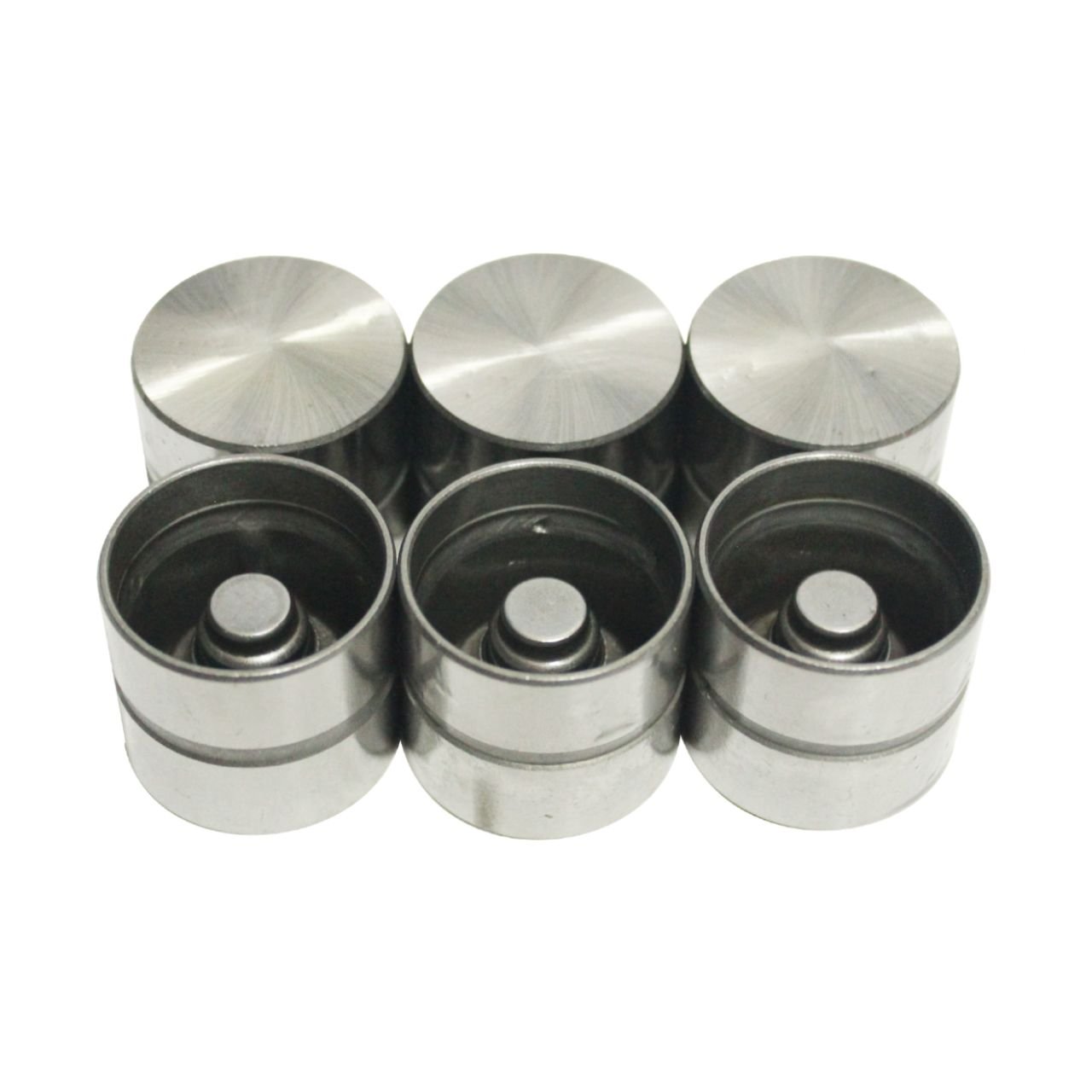

I have already bought a complete set of brand new hydraulic lifters.

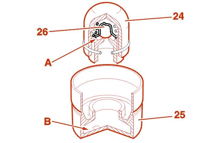

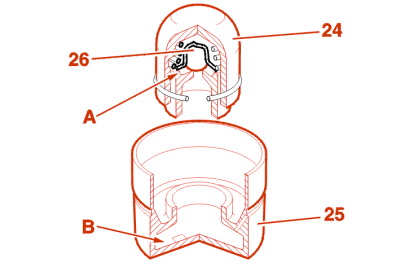

I was reading Haynes manual about replacing the lifters and this part caught my notice:
Check that the hydraulic tappets are not fully extended .
To check, compress the piston (24) in the tappet between the thumb and index finger to compress the spring .
If the piston appears blocked, the high pressure chamber (A) is full of oil and fully extended .
To drain the high pressure chamber, remove the piston (24) by tapping the tappet on a block of wood .
Remove the oil by pressing on the ball (26) and drain the low pressure chamber (B) .
When refitting, place a little oil in the low pressure chamber (B) .
According to above, Peugeot recommends installing lifters dry which means I shouldn't prime them by soaking them in oil. This is what I don't understand.

I’ve done lots of these in my time. You must install them “dry”, that means they are springy with the finger and thumb test. Otherwise if they are full and extended a valve will stay open and could hit a piston on start up.
You can of course tip oil over the camshaft lobes and lifters before fitting the cam cover.
When starting it will rattle like a bag of nails for a few seconds, not a problem.

I have bought a complete set of brand new OEM lifters but there is a problem. I can't press any of them with my fingers. They are quite hard. I think they are full of oil or something. Aren't new lifters supposed to be empty and spongy? Should I drain them with a vise? Please give me some of your precious advice.I’ve done lots of these in my time. You must install them “dry”, that means they are springy with the finger and thumb test.

I’ve done lots of rebuilds but never used brand new lifters, so I’m not sure what to say. Is the cylinder head off? If so assemble it all and carefully turn the camshafts to see if the valves shut.
After saying this I would be more happy if the lifters were springy. So better squeeze the oil out.

No, nothing is off. I'm driving the car now. It has great compression on all 4 cylinders. It accelerates quite well up to 6500 RPM redline and pulls nicely from low revs. There is nothing wrong with it expect for HOT IDLE ticking. Only at idle and only when hot. The valves are definitely shut. Otherwise, compression would be low.Is the cylinder head off? If so assemble it all and carefully turn the camshafts to see if the valves shut.
Should they feel springy after squeezing?After saying this I would be more happy if the lifters were springy. So better squeeze the oil out.

Yes, when the oil has been squeezed out.
I made up a tool with a small vice and parts that will not to harm the lifter, then carefully squeeze it a number of times until the lifter is springy.
With 16 lifters it’s a long boring job.
