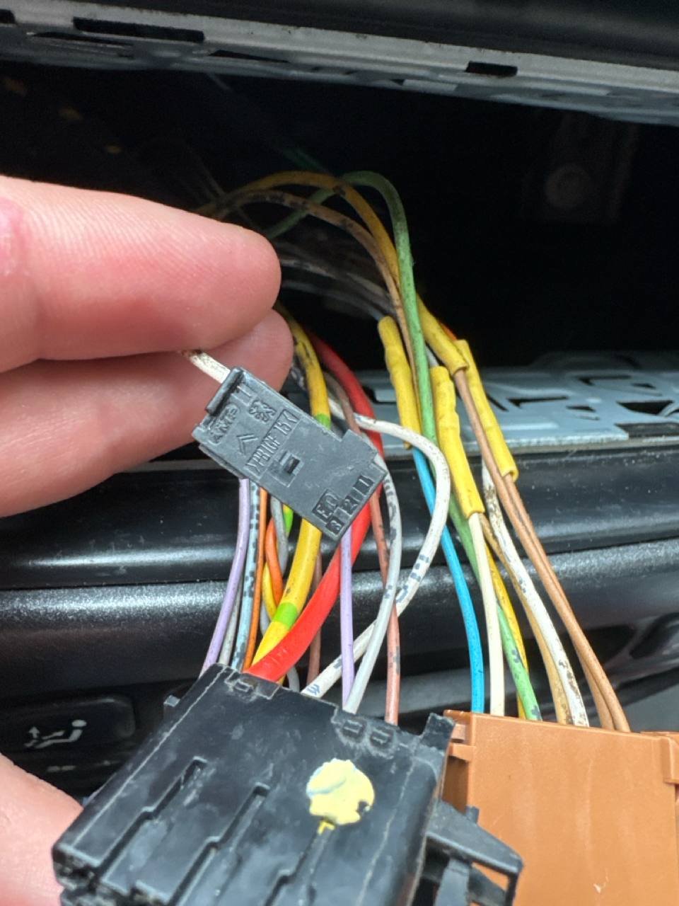

I also found a small connector in the radio loom, but I’m not sure what its purpose is.

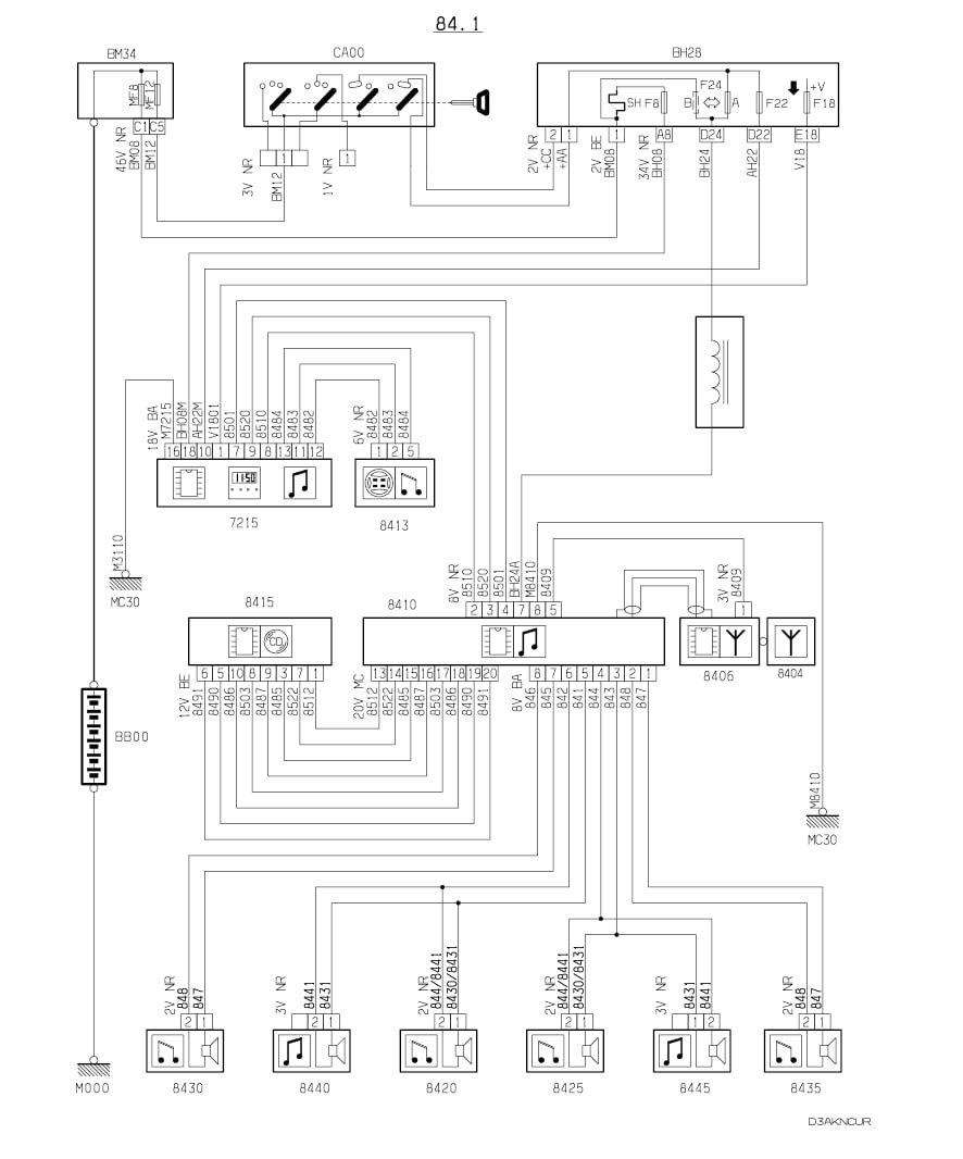

According to this diagram, steering controls are connected to the multifunctional display, mine is the most basic one - it only shows date, time and Radio/CD-changer info
Maybe I need to try another display which is 100% compatible with RD1
