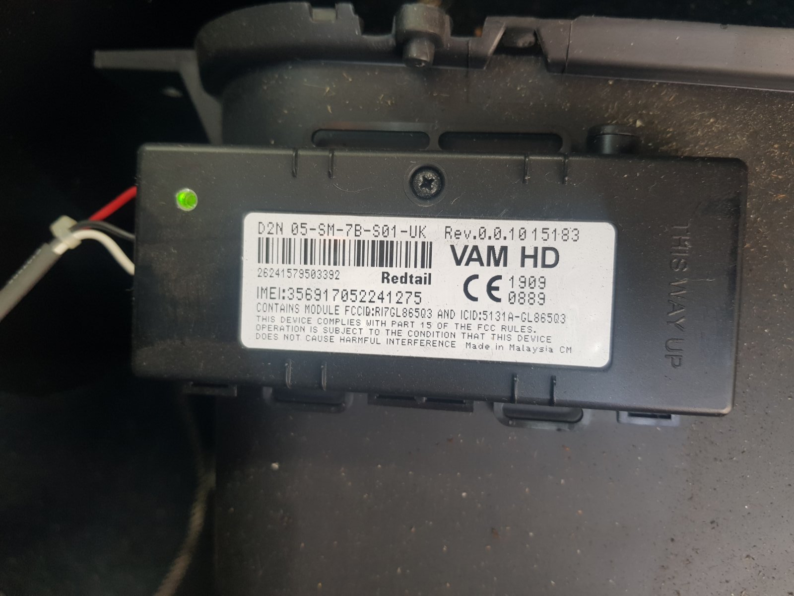

Is this the immobiliser on my 2002 Citroen Saxo this part is fitted to the inside top of the glove box that's been removed TIA
Check the photo

IMEI suggests a mobile phone or mobile data type device.

Looks like a box supplied by an insurance company to moniter driving habits.

Its not OEM as the wiring looks a little basic, Positive (Red), Negative(Black) & Trigger (White).
Multi manufacturer bluetooth module, there's quite a few on Ebay

Definitely not factory fitted.
The immo box is located up behind the glovebox, small back box around the size of a cigarette packet with an 18 way black connector.
Normally made by Valeo or Siemens.
Why do you need to find it out of curiosity?
