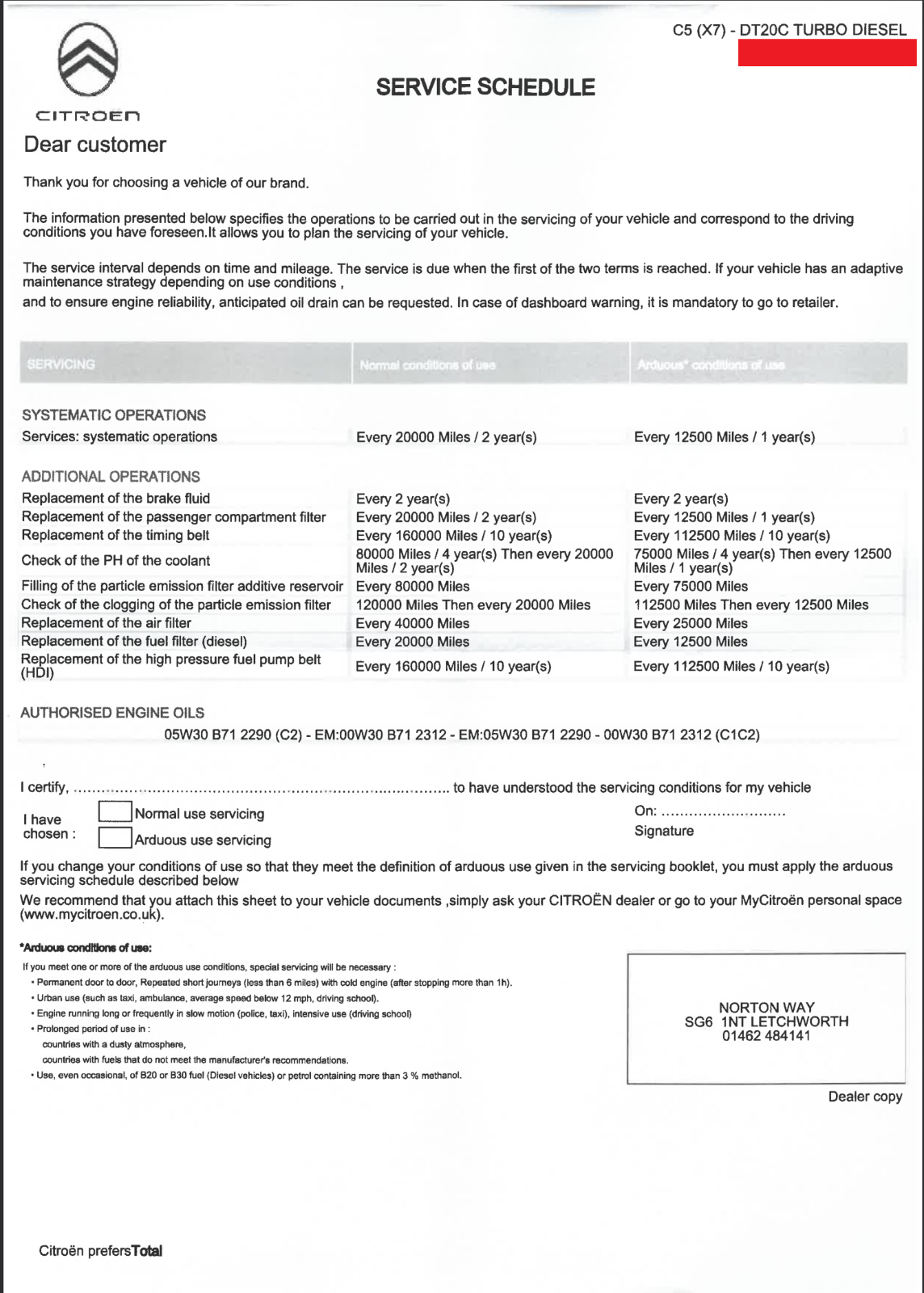

EDIT:
Problem solved, photo attached.

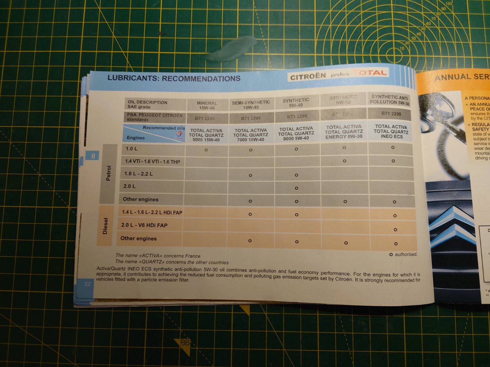

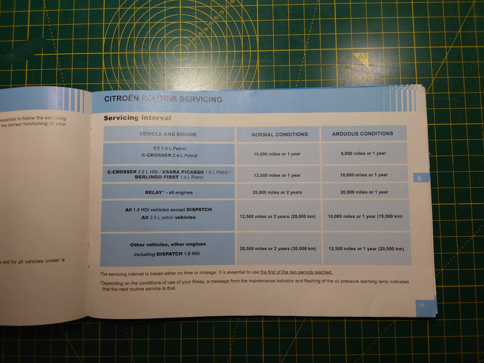

I've decided to keep the 3L C5 X7 that I bought a month ago without service history. I was wondering if anyone that owns any Citroen from late 2009 to maybe 2012 could share some pages from their service stamp book. I'm specifically looking for all pages that list official mileage intervals for fluids, belts and whatever else. Unfortunately, the service book for my 2L misses the crossover point between the 2.7L and 3L HDI so I only have the info for the 2.7 (images below for anyone that might need them) and the blank book I bought is one of the new ones with no useful info in it. I know it's actually a Ford engine and that loads of JLRs use it, so I'm yet to look for their info (as per wurlycorner's advice). But I'm kind of OCD about it and want the PSA numbers. Funnily enough, both of us are in the same boat of having bought slightly dodgy 3Ls with no service history and could both use the info. LOL

Went for a walk during lunch, turns out there was a main dealer near my workplace that I've walked past before that I just forgot about. Figured it couldn't hurt to see if they can indeed provided the info. Took them a couple of attempts to find the car in the system, but ultimately they managed. Looks like the service schedule is more or less that of the 2.7, except the timing belt is rated at 160K miles under normal conditions. That to me is unhinged considering I had my 2L done at about 85K (official rating being 95K). I definitely wouldn't leave the 3L to 160K that seems way too high.

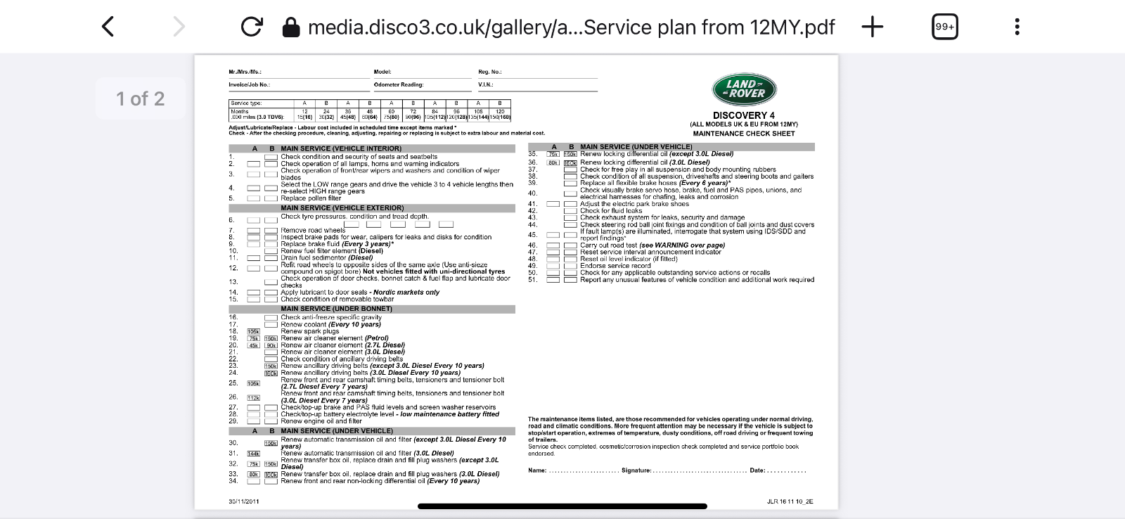

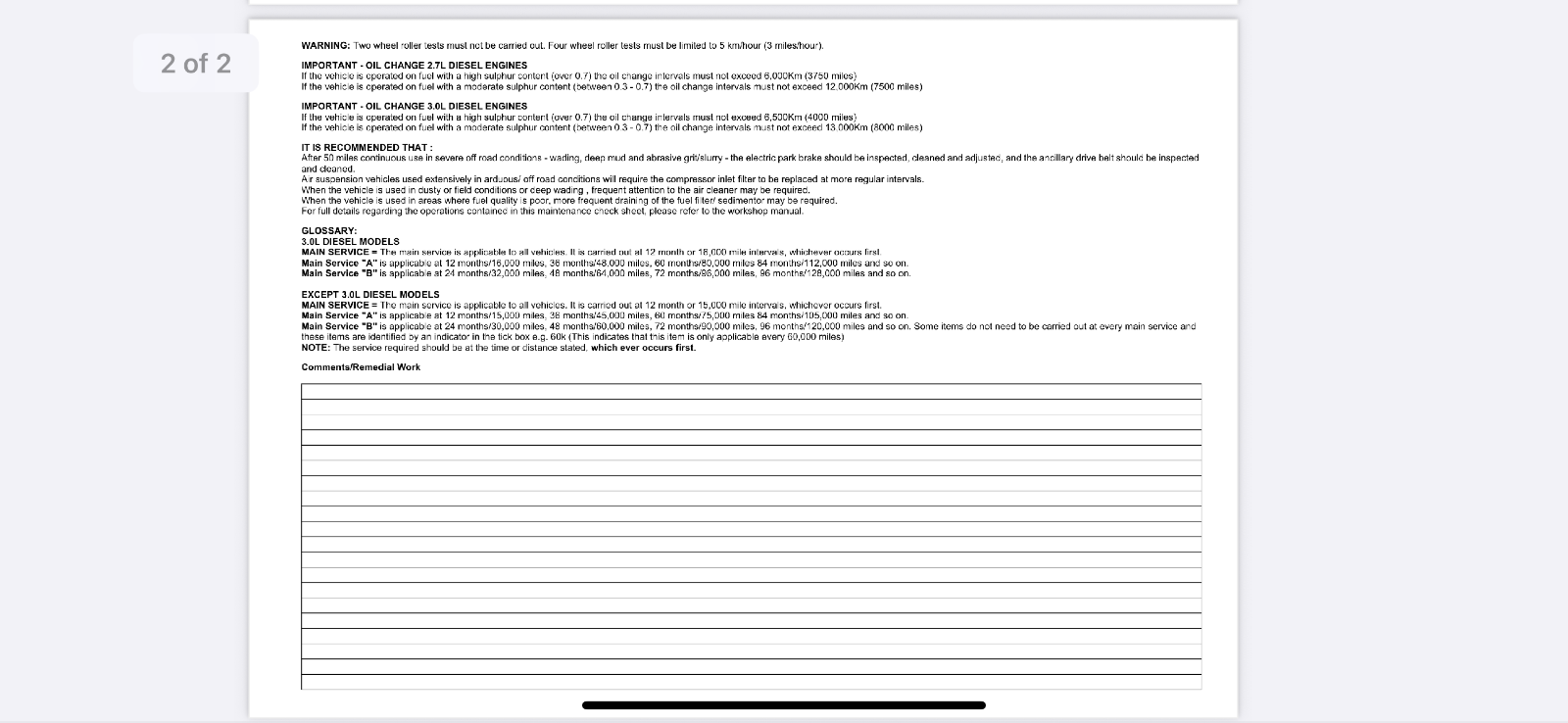

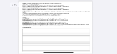

FWIW this is the service schedule Land Rover specify for the same engines (2.7 and 3.0 lion v6)
https://media.disco3.co.uk/gallery/albu ... 2012MY.pdf The engine is in a slightly higher tune and you might ‘expect’ the engine to be worked harder in that vehicle, but the service intervals are much reduced. 112k for the timing belts on the 3.0…
