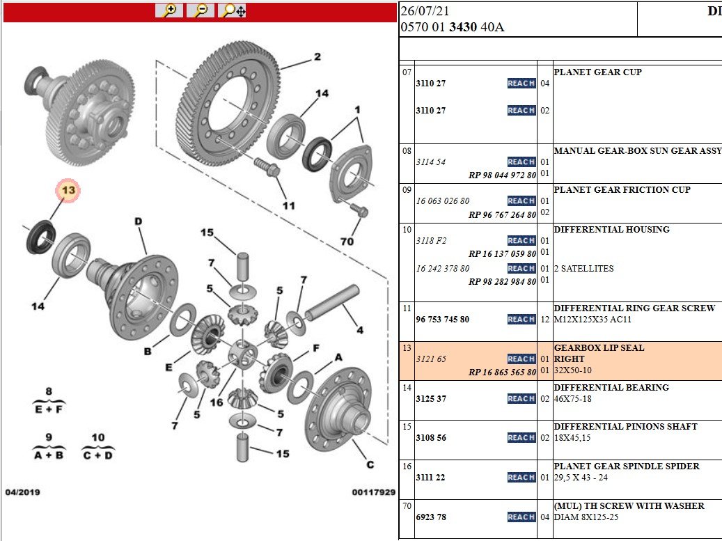

Could someone please look up the part number for a drivers side (RHD) off side gearbox / diff seal on a C4 Grand Picasso 1.6 2014 with vin VF7**************[VIN obfuscated, can be read by forum staff]
Been looking for a while but they all seem to be the wrong size.
The driveshaft measures 32mm as it enters the seal / diff / gearbox.
Thanks you

Just the VF7**************[VIN obfuscated, can be read by forum staff] at the start missing
Updated part number 1686556580 Was originally 312165

wheeler wrote: 26 Apr 2025, 22:30 Just the VF7**************[VIN obfuscated, can be read by forum staff]**************[VIN obfuscated, can be read by forum staff] at the start missing
Missed your reply some how.
Managed to get one here https://www.ebay.co.uk/itm/363763054365
fitted and all fixed (apart from all the error codes lol)
