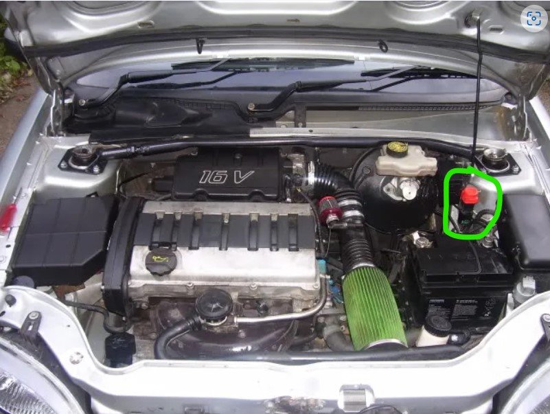

Inertia switch been tripped?

Thanks for the reply but How would you fix that

Bruceramsay wrote: 26 Apr 2025, 10:40 Thanks for the reply but How would you fix that
Its this here, it cuts off the fuel in the event of an accident kind of like a circuit breaker, push it down to reset. It can also bring the immo light on as it cuts power to the ECU.

Has it started since the accident at all?
Also check just behind the intertia switch there is a fuse box with 4 big fuses. In fact check all the fuses.
Failing that the chip receiver aerial around the ignition barrels are a fairly common failure, you can test it with a tool like this >https://www.ebay.co.uk/itm/202326441953 ... R4L_qpjOZQ

I gave that a try but still no start

It did start after the crash but I left the car for a while but yeah I’ll have a look thanks

OK, it must not have been severe enough to trip it. If it had tripped it wouldn't have started immediately after the accident.
