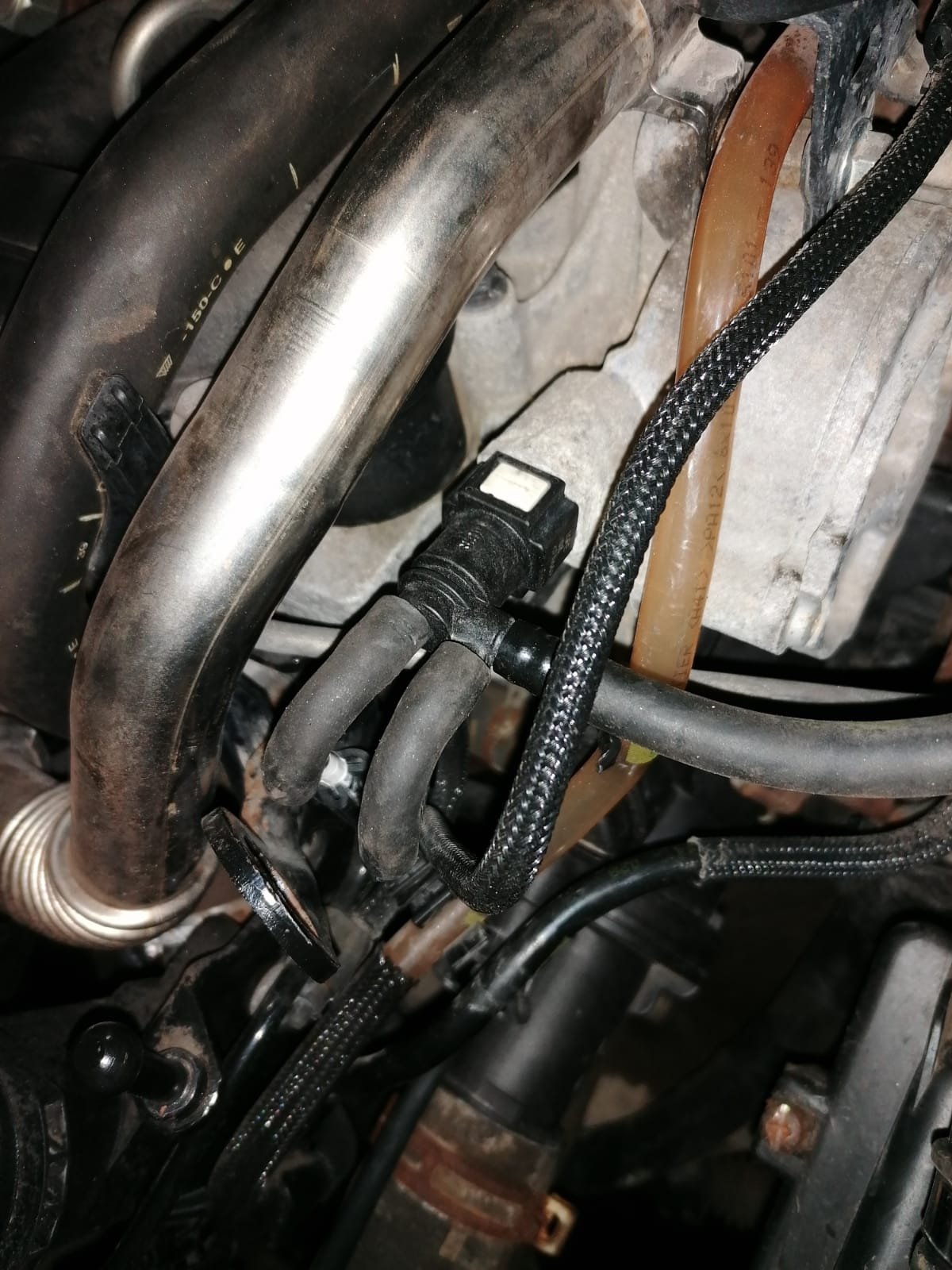

Hi.
Need some help.
My Citroen Jumpy has no boost.

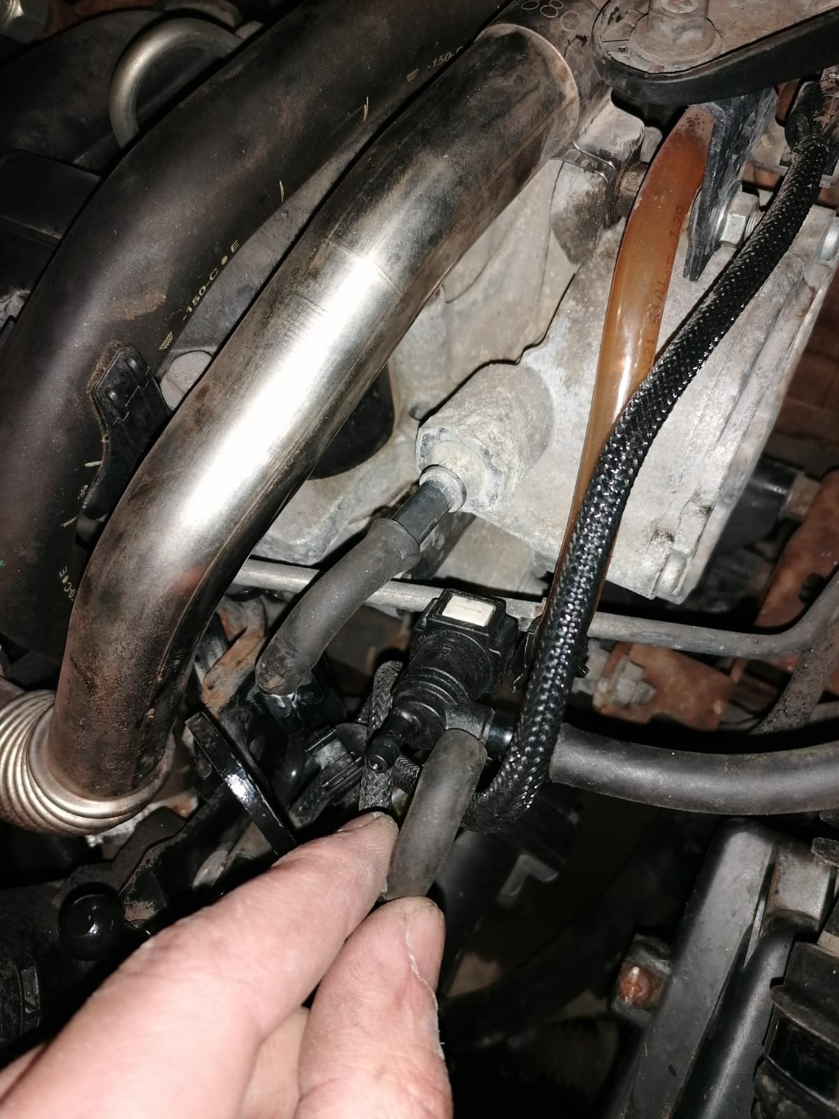

See the pictures attached to understand better.1st picture there are 3 pipes connected via splitter and 2nd picture spliter is off and turpo pipe is connected directly to vacuum pump.
So there is no boost,Unless I connect the vacuum pipe directly to vacuum pump instead of splitter.
Its a 3-way splitter ,one way goes to brakes,one is blanked pipe(don't know why) and one goes to turbo solenoid
SO if I take splitter off(Disconect brakes) and leave turbo pipe only,boost is perfect,car goes like a rocket and diagnostics shows perfect boost,as requested.A soon I connect it back via splitter-no boost,it stays around 1000,even drops at beginning to around 900 and the slowly goes to around 1000.
Brakes work perfectly. And turbo works perfectly when connected directly,So I don't think there is any leak in vacuum pipes.
Can the problem be the vacuum pump itself?Maybe vacuum is too low to supply both,the brakes and turbo?
Sorry,if I explained it uncleary,Im trying my best.

Fixed.
Checked the system wiith vacuum gun and found small leak on pipe that goes from reservoir to turbo solenoid.
So it was leaking pipe.
