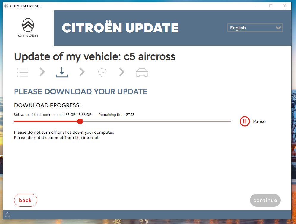

I've tried three times to download the touch screen and map update files (one is 5,88 Gb and the other is 17 Gb) using the Citroen Update app on a laptop
Despite completing the downloads (the 5.88Gb takes over 40 mins despite me being on a fast fiber internet) , at the next step it says the download failed and so forces you to try again.

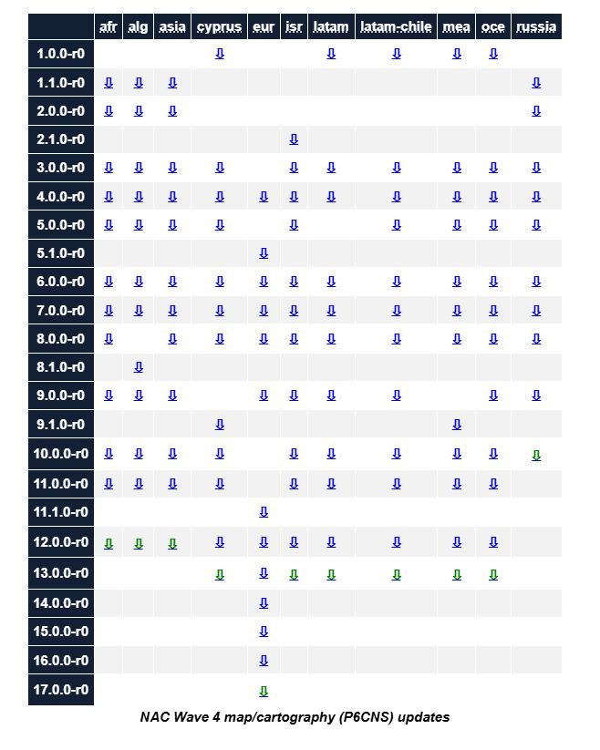

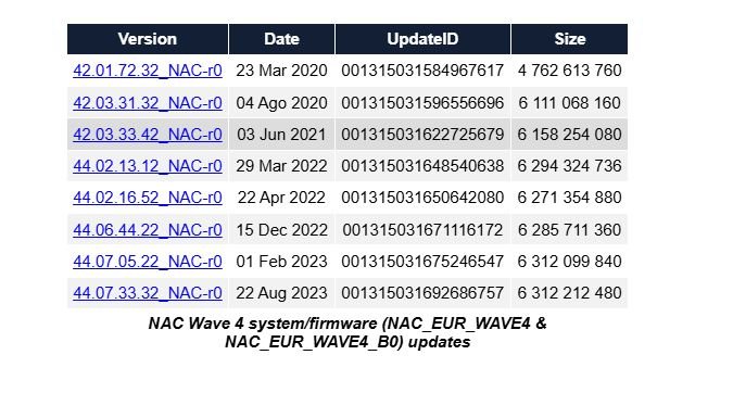

I found a site that seems to have screen and map updates .
That said, it appears that there are no update from PSA for any countries / regions outside of Europe since July 2024 (being version 13)
see https://sites.google.com/view/nac-rcc/system/nac/wave-4

I am also having problem with updating to the latest version of the touch screen and map updates. The previous owner of the car didn't do any updates so everything is on the stock version from 2018. I Downloaded the latest version EU maps 17.0 and touch update 44.07.33.32_NAC, but when I tried to install them in my car, it says maps failed to update or when I try to install the firmware it says hardware not compatible.
What should I do to get thru the update process?

Given that for PSA NAC Wave 4 (P6CNS) systems map updates utilize TomTom's NDS (Navigation Data Standard) cartography, has anyone had any luck "inserting' updated Tomtom maps into say the last update version 13 PSA update
Or any other map versions that can be loaded up ?
