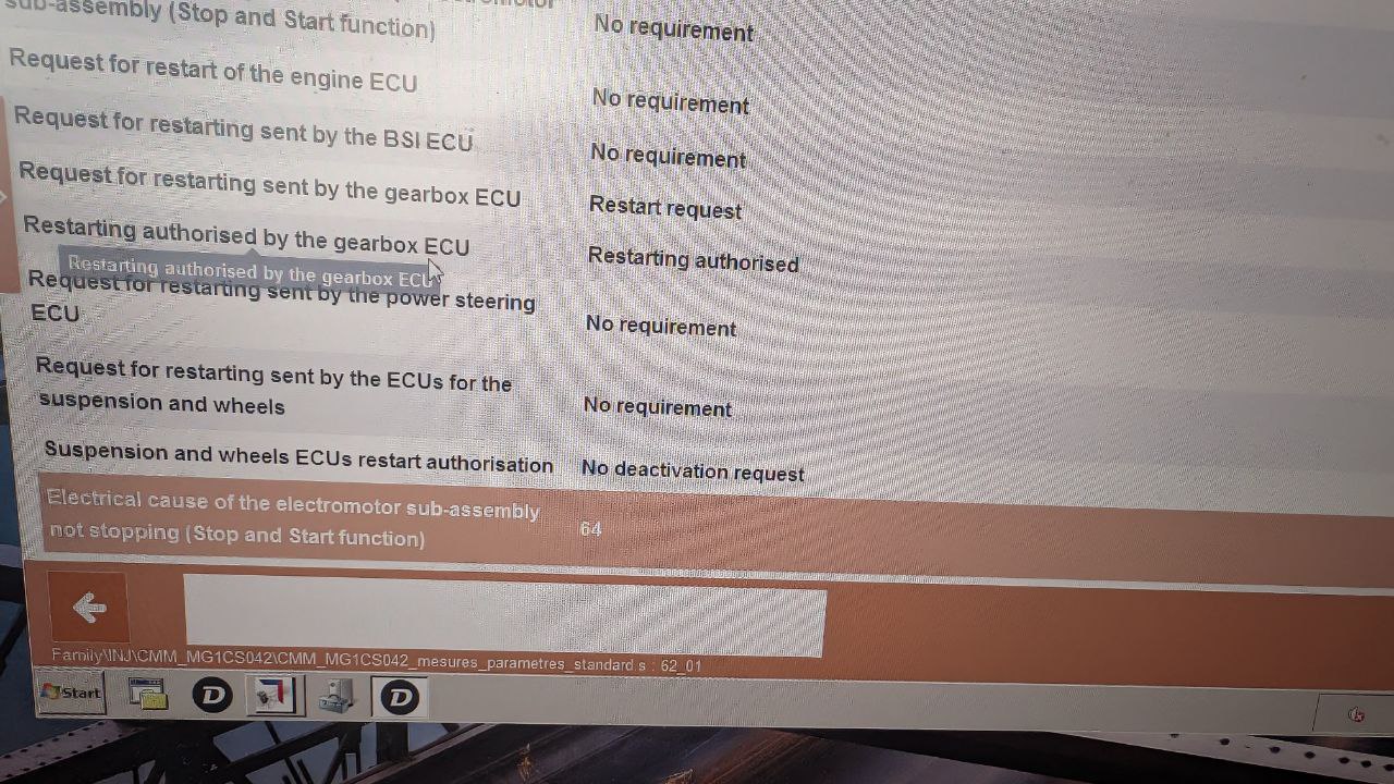

However, the S&S still doesn't work and I couldn't find any other issues until I saw this today in diagbox BMS parameters:
Electrical cause of the electromotor sub-assembly not stopping (stop and start function): 64
Any one knows what that means?

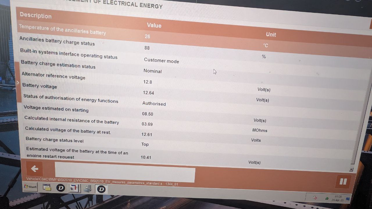

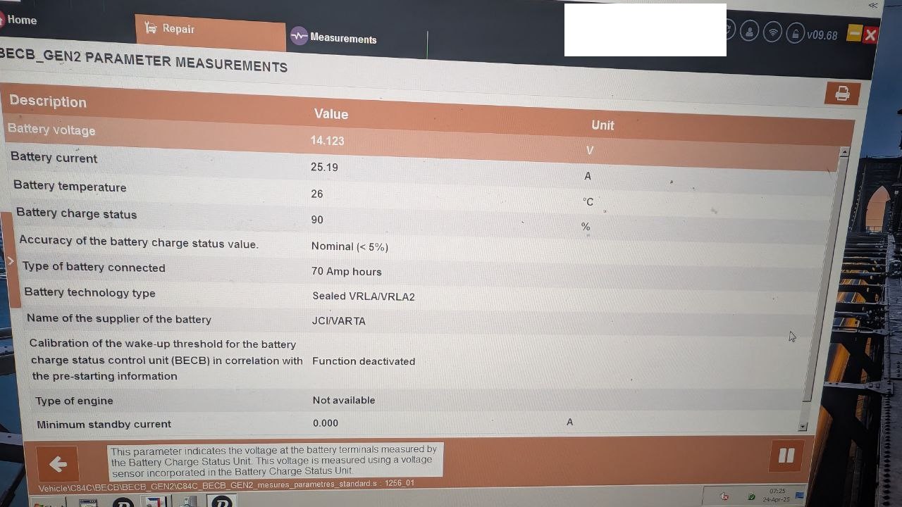

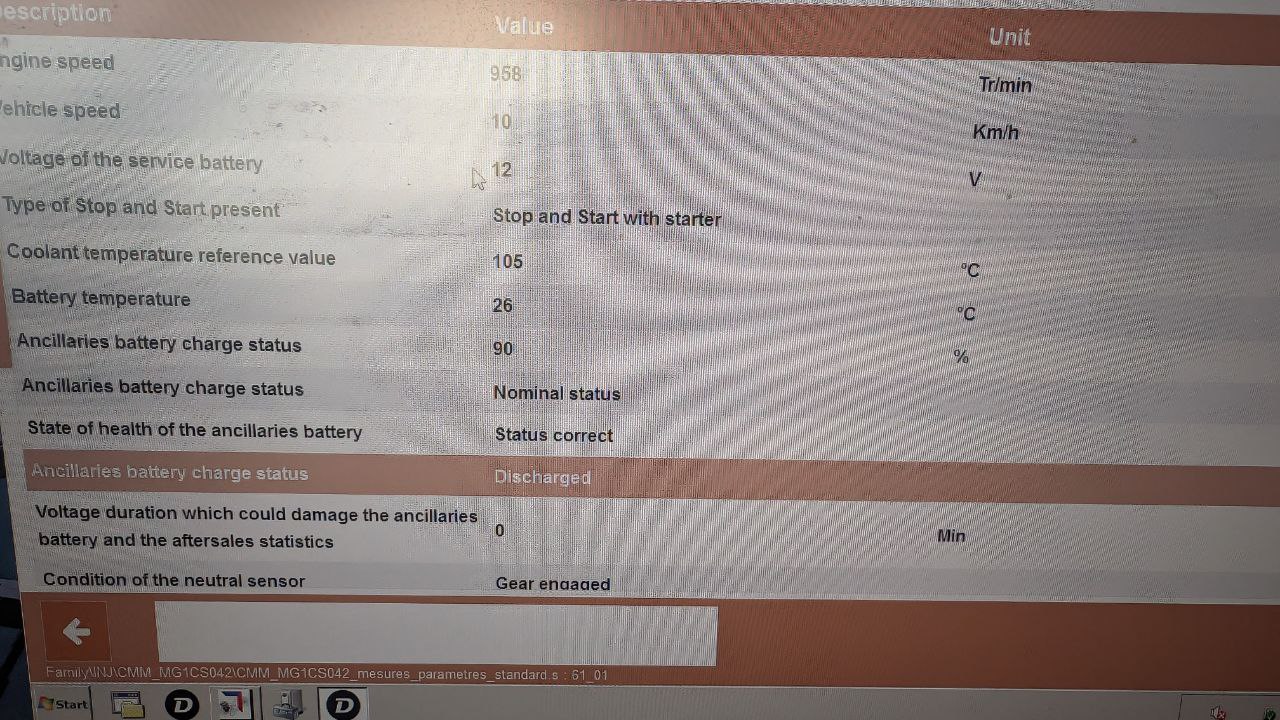

Here are some additional screenshots from live data while driving which all look fine:
The "Ancillaries battery charge status: discharged" changes depending on the engine load. So I think this just reflects if the battery is currently getting charged or not.
Because the is also "Ancillaries battery charge status: 90%" and "Ancillaries battery charge status: nominal status".
Also "Battery charge status level: top" and "battery voltage: 14.123" which all look good.
Additional note:
I replaced the EFB battery with an AGM battery and changed battery type "reinforced battery" to "VRLA/VRLA2".
Thanks in advance!

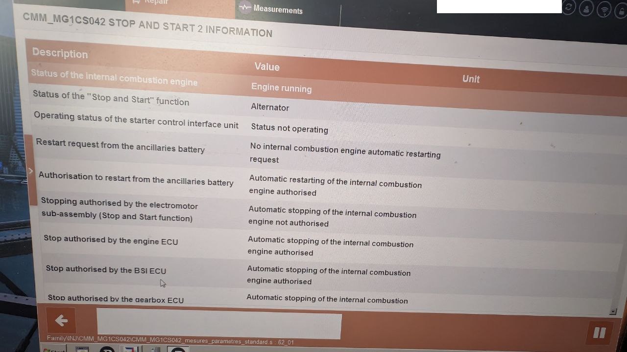

Additionally I can see the following prohibition for stop-start in diagbox:
Stopping authorized by the electromotor sub-assembly (stop and start function): Automatic stopping of the internal combustion engine not authorised
So this seems to be the reason why my stop-start is not working but what is it and how do I troubleshoot it?
