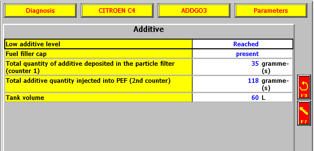

Anyway, I thought I might try and do it myself this time. I have lexia so should be able to do the reset, I believe I have found the correct option on the "Diesel additive function" sub menu. But before that I need to actually get the fluid and put it in.
I have done some googling and read a number of posts on this forum, but from that my conclusion is there seems to be a number of options for which fluid it is supposed to be topped up with depending on exactly what model and age it is. So I was hoping one of the experts on here would be able to advice which type I need to get for mine.
It's a 2005 C4 2.0 HDI, the vin is VF7**************[VIN obfuscated, can be read by forum staff], I think it's a refillable tank, as I have a faint recollection of the garage mentioning that when they did it all those years ago, and the invoice mentioned 3L of fluid being used; but it would be nice to confirm that if anyone has done it themselves or has access to the docs.
Has anyone got any experience of doing it on this model? Can it be filled with the tank on the car, or does it have to be removed to fill it up. I have seen some youtube videos where they removed it but that wasn't for a C4 so not sure if this is slightly different.
Also how urgent is it to top up when the warning comes on? how much is left in the tank? From lexia I couldn't see any measurement of fluid volume, just a count of how many grams of additive had been injected, which in itself seems quite a low number if it has got through multiple litres of additive. I can only assume this figure is some sort of estimate for the weight of the active catalyst in the additive that has been used rather than the weight of the additive fluid itself?

Not done a C4 but last one I did was a C5X7, I filled the tank in situ, long tube and run it into tank. The type depends on colour of connectors on pipes near tank. Admin will be able to advise. When done you set the counter to zero.

You need EOLYS 176 additive.

Thanks. Do you happen to know what the capacity of the tank is on this car?
I'll buy the 3 litre refill kit I think, which will hopefully be enough. But would be interesting to know, based on how much is left of the new fluid after the refill roughly how much was remaining when the warning light came on.
wheeler
Posts: 7930
Joined: 21 Sep 2002, 19:07
x 1055
Re: Particle filter additive too low warning
Unread post by wheeler »
I would think 3 litres would be more than enough, Not sure on the C4 tanks but the Berlingo ones are only 1.1 litres.
