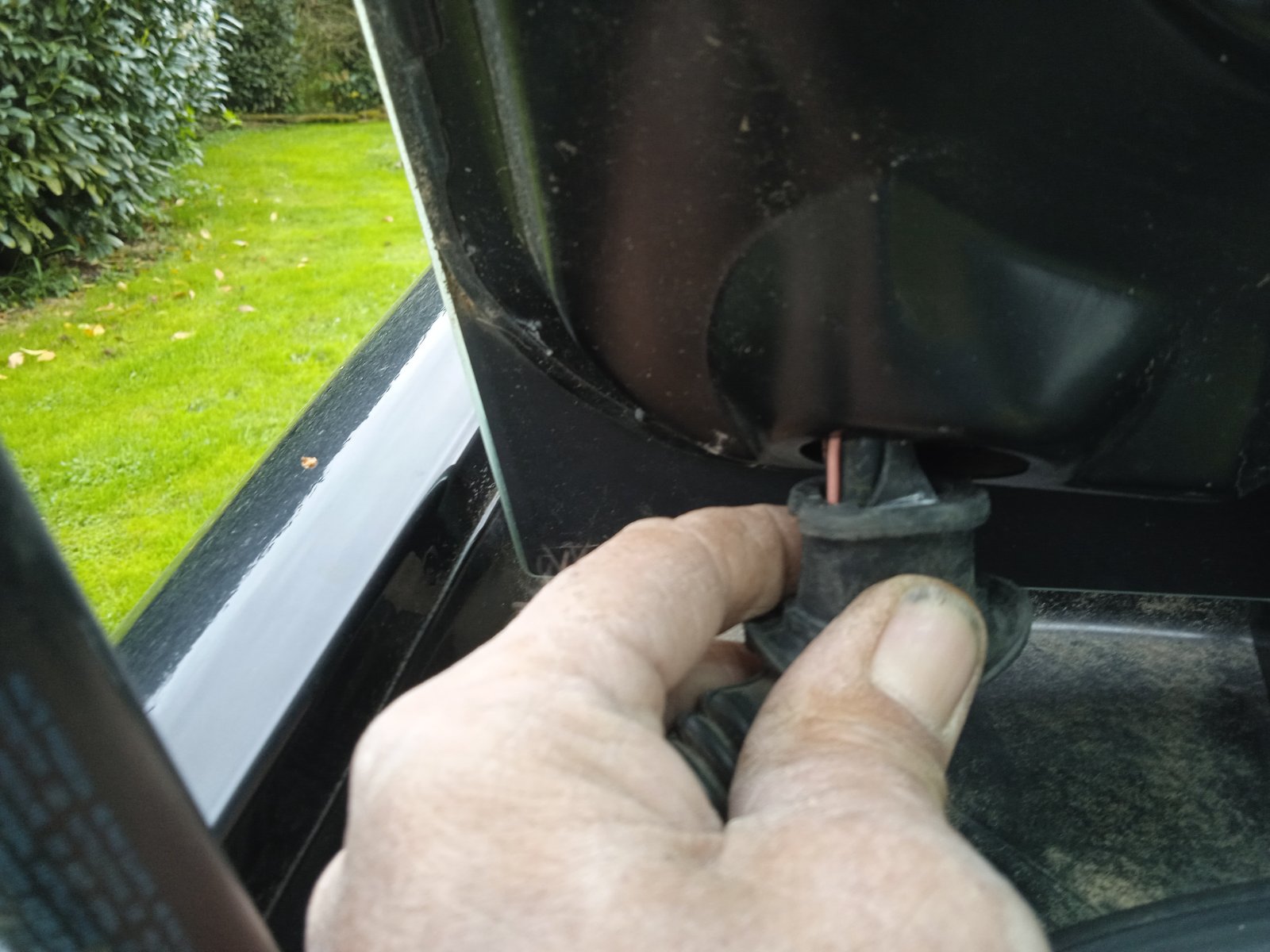

Only just pulled more trim off to exposed the 16 pin harness connector (11 are used) Did a continuity test between the '6297' on the switch and all (pink in this case) pins on the connector. Diddly squat, so yeah a broken wire (or possibly more now)in the rubber boot it would seem. There seems to be a rubber tether stopping the rubber boot being pulled out of the door skin. Is there a trick to release it or do I just cut the bugger off? I've already lost 1/2 the plastic retaining clip for the rubber boot inside the metal boot
