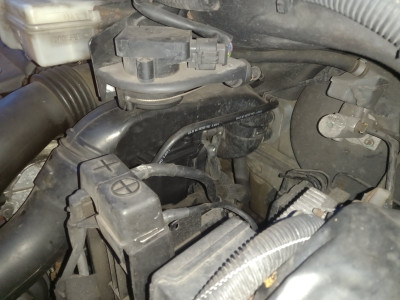

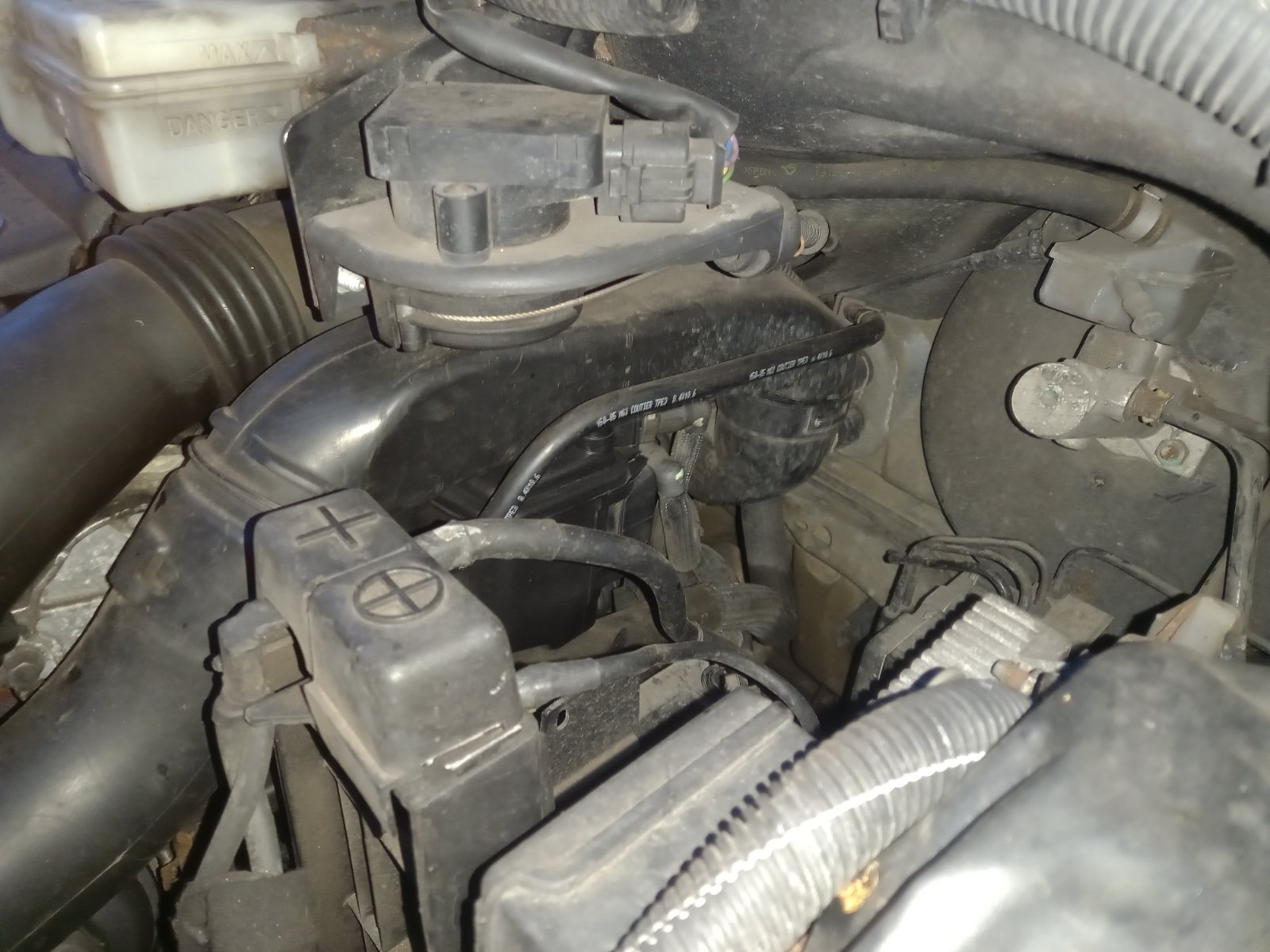

I've tried to upload a picture of the area of the engine on my car where I understand the EGR to be.
Steve Walsh
- Posts: 774
- Joined: 25 Oct 2019, 07:20
- x 515
Re: Sticky EGR valves
remove plastic air pipes and air filter / air filter housing and it will be visible over back of engine, Been a while since I did a 1.6 and can't remember exactly but not too difficult
