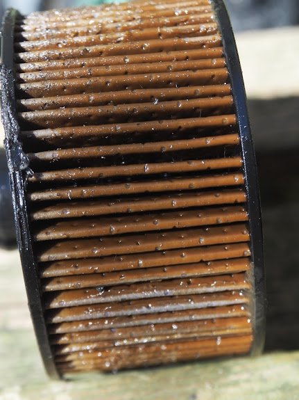

I've dived in with replacing the fuel filter and priming with injector cleaner. Ran it for a few min and will let it rest for a while.
I noticed the fuel draining from old filter had quite a few yellow/brown flakes. Any ideas what this could be? Maybe I'm onto something and my initial guess of bad fuel is the cause?

Re: Low fuel pressure codes
Have dismantled the old filter and there's a brown sludge covering everything- diesel bug?
