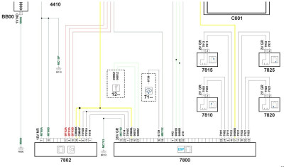

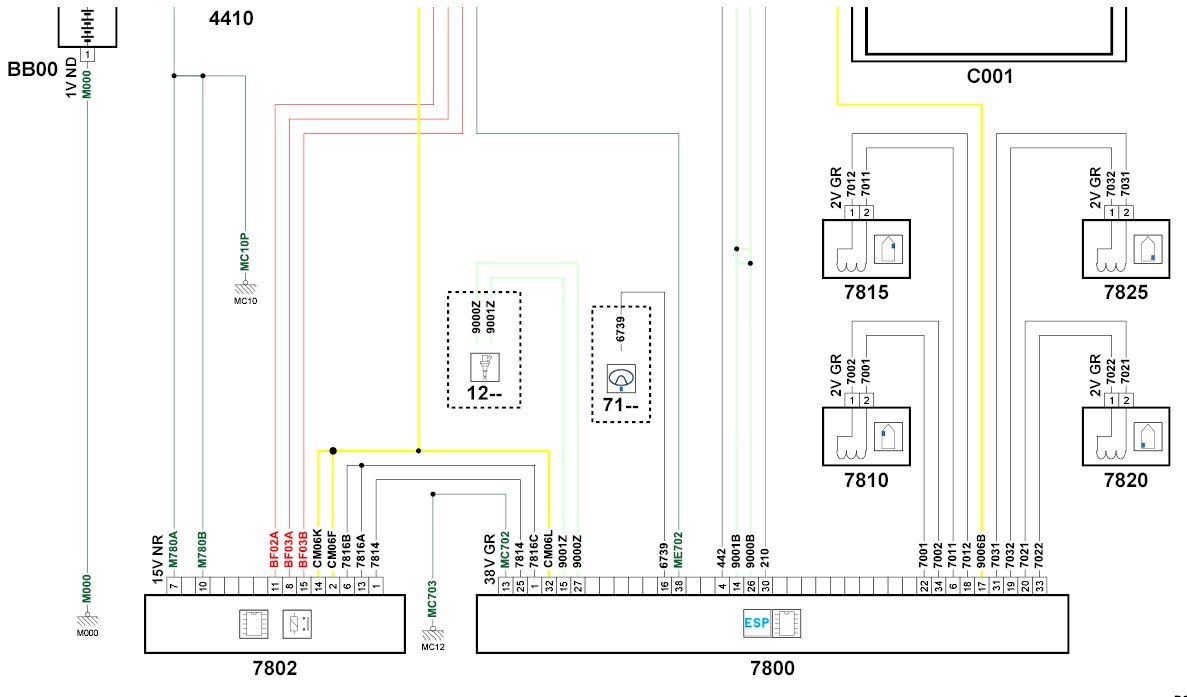

Re: Faulty ABS on C4. ABS/ESP wiring, CAN-BUS wiring diagrams request
ESP diagram (well part of of it) doesn't zoom very well
CAN lines are 15 & 27 + 14 & 26
