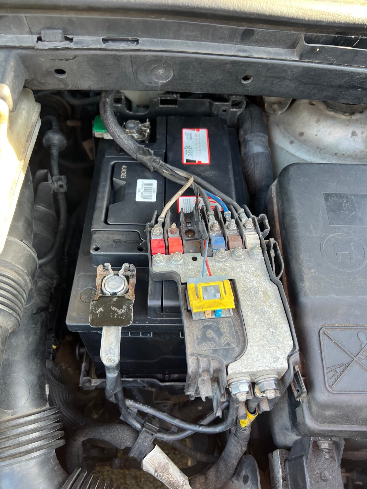

Is there a way to test the metal plate with fuses on that sits on top of the battery, should there be any voltage through that?

There should be battery voltage at each of those fusible links on the metal board if that system is behaving properly. Continuity each one of them as well
I've managed to fix it in the end. First time round I only visually inspected all of the fuses in the engine bay compartment.
After no luck I used my multimetre on each fuse and found the culprit.
Fuse 1, in the engine bay, had some corrosion on it and had blown. This controls the engine management and once replaced the van started right up.

I know I'm late to this, and I'm glad you got this solved.I've managed to fix it in the end. First time round I only visually inspected all of the fuses in the engine bay compartment.
My first thought when I read the problem was of my wife's 2011 3008 2.0 HDi and the issues it had after I took the car to get the battery replaced. We live 40 minutes drive each way out of town and I had things to do at home that morning, but the 3008 was giving my wife some electrical troubles so we decided to get the battery replaced. Forty minutes each way driving plus 30 minutes for a battery changeover should not equal 4 days of lost time, but it did.
No corrosion on Fuse 1, but the same fuse that controls the Engine Management System had blown. The battery people should have known to check the correct shut down procedure for a Peugeot. They just disconnected the battery as soon as I drove in. I don't know how many different scan tools and brands of scan tool were used to try and locate the problem, but all failed to find anything. Thankfully, the Peugeot dealership was across the road, but we still had to get the car put on a flat tow and taken there. They found the problem immediately, but they also had 3 or 4 cars in front of us. They're a mult-brand dealership with only one Peugeot trained 'technician' so we had to wait our turn.
