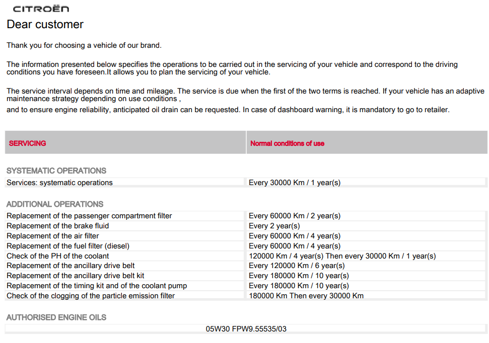

I would guess that it's more or less the same as all the other Hdi belts. 100,000 miles or 10 years, whichever comes first.
180000km
11600 miles
