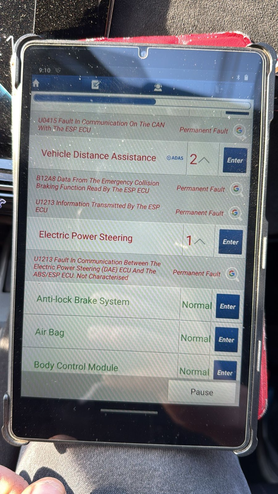

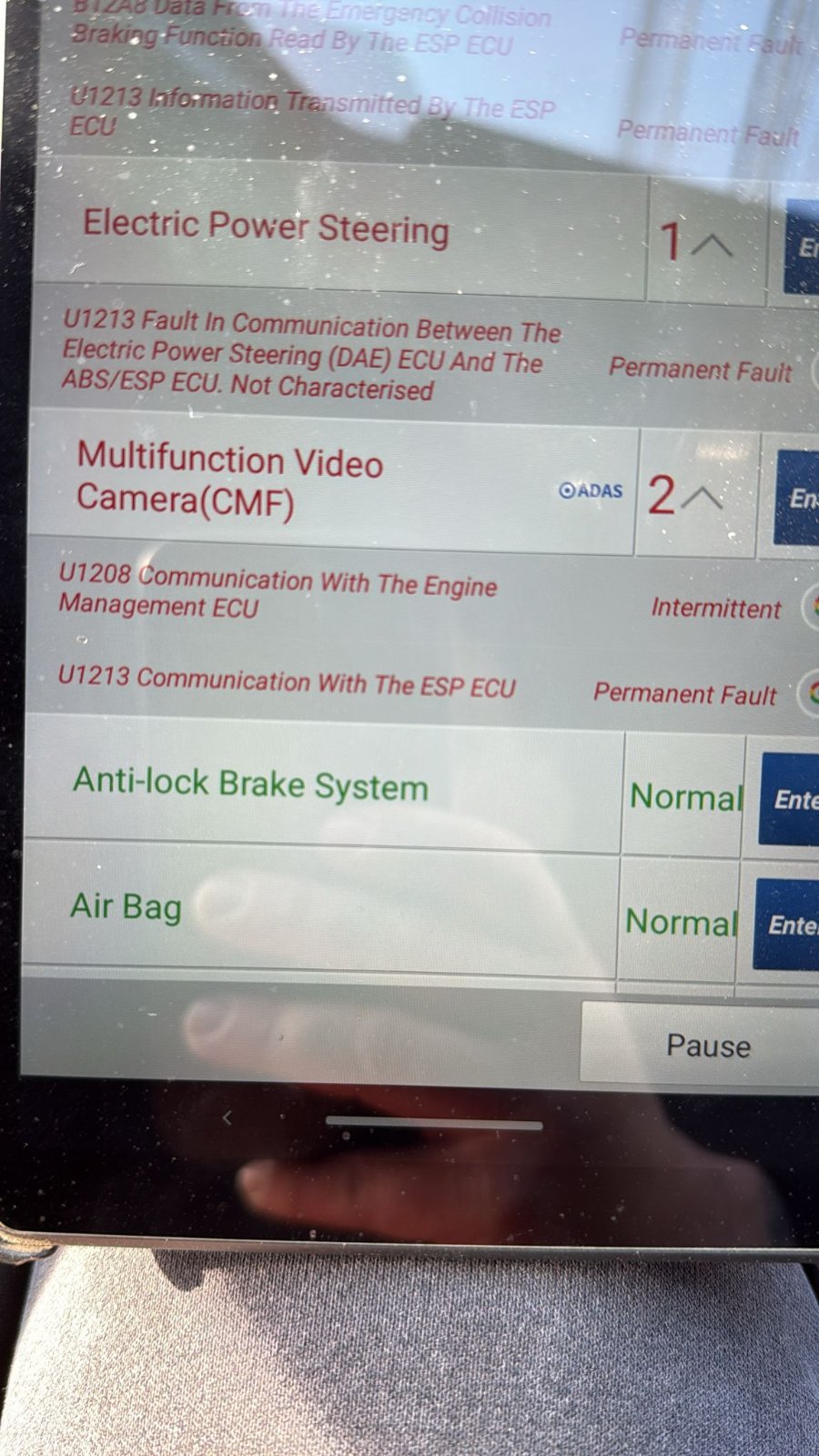

Hi all,
A few days ago I drove over a small curb with the rear right wheel of my car (DS7 E-Tense), and whether it's a coincidence or not, a "Christmas tree" of warning lights appeared on the dashboard. At first, I thought the batteries were dead and I even replaced them, but the errors didn't go away. I'm attaching the codes from the diagnostic tool — maybe someone has come across something similar?
Btw, the car drives okay, in all modes..
Built-in System Interface (BSI):
B1807: Fault with the unlocking of the immobilizer by the Hybrid Management ECU
B120A: Collision risk alert function fault (intermittent)
B120D: Automatic braking on risk of collision function fault (intermittent)
B1003: Configuration fault (warning: may be a phantom fault)
Engine System:
U1213: Communication with the ABS/ESP ECU — data received invalid (permanent)
Gearbox:
U0415: Fault in communication on the CAN with the ESP ECU (permanent)
Vehicle Distance Assistance:
B12A8: Emergency collision braking function data read by the ESP ECU (permanent)
U1213: Info transmitted by the ESP ECU (permanent)
Electric Power Steering:
U1213: Fault in communication between power steering ECU and ABS/ESP ECU (permanent)
Multifunction Camera:
U1208: Communication with the engine management ECU (intermittent)
U1213: Communication with the ESP ECU (permanent)
VIN: VR1**************[VIN obfuscated, can be read by forum staff]
Thanks in advance.

Something odd going on there - lots of faults about no coms with the ABS, but your scan tool is reporting no codes....? You might need a different scanner to see what is going on in the ABS ECU, possibly damage to the sensor or wheel bearing that means it has lost its signal.

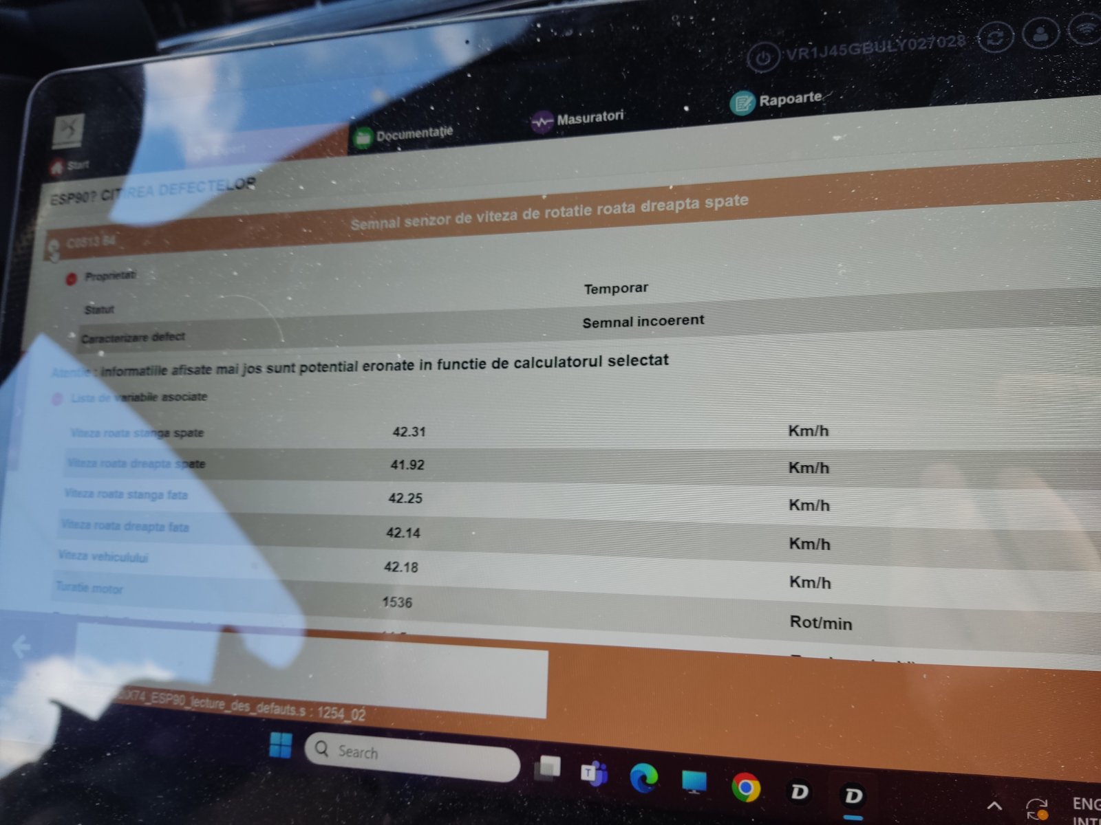

Re: DS7 suddenly a lot of faulty codes
Yeah, it looks like is something wrong with Right rear wheel speed sensor signal (rough translation from Romanian) .. the same wheel I drove over a small curb. While the car is stationary, the error can be deleted and once you remove it, all other errors are automatically cleared. They reappear once you start driving, after few meters..
Here’s an update: it seems that the magnetic ring of the wheel bearing has broken (or something else,I don't know yet), with metal fragments falling to the ground when the sensor was removed. The tip of the sensor was also damaged.. so I will be ordering the broken parts and keep you updated.
