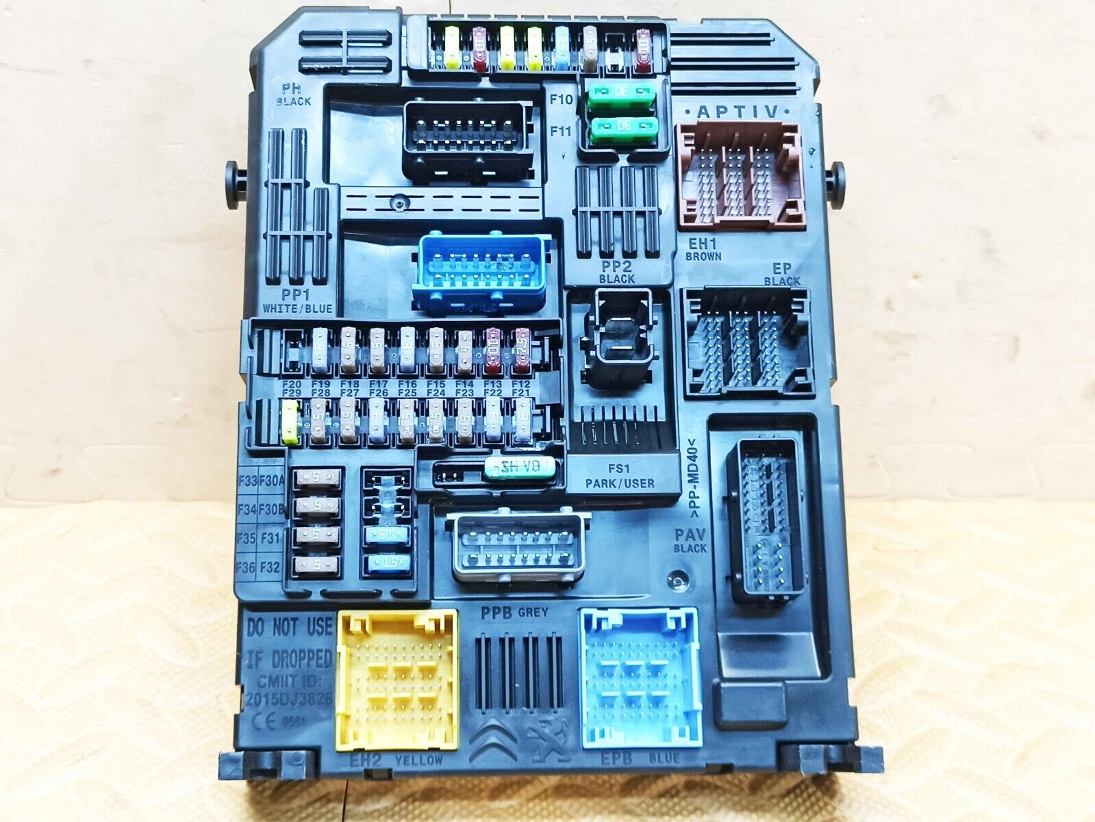

I've also looked into the fuse box in the glove compartment today and, although very tight, I can just make out the following locations are empty:
F20
F30A
F30B
There is also a blank fuse location at the top row of 8 fuses, the last but one from the end. But I can't see a number next to the fuses on this row. There's limited information online but this seems to match the photos I've seen of some fuse boxes for sale, such as this one:
F20
F30A
F30B
