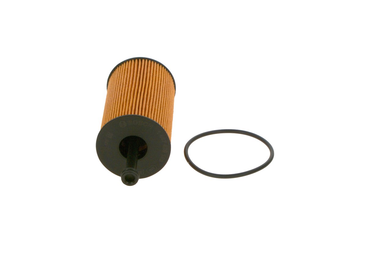

I pressume you have this type of filter (picture attached). I had them stuck quite snuggly before but never that tight that they would not come out with some force. I would try to wiggle the filter from side to side and twist it simultaneously while trying to pull.
Also make sure it is not stuck by "vacuum". Is it tilting sligtly? The bottom part might be just sucked to the metal counterpart.
Does it have plastic bottoms and top or is just the "paper" bare filter? If it has the plastic parts I would destroy the upper part (be carefull not to drop some parts into the engine) and took the bottom part by the plastic with pliers. It should be easier because all force will be on the holding part.

SOLVED and thanks for your advice. It took an awful lot of pulling and wiggling but just as I was about to get destructive it came loose. It was indeed the type with the plastic locator on, not the smaller one!Arkis wrote: 03 Apr 2025, 06:12 I pressume you have this type of filter (picture attached). I had them stuck quite snuggly before but never that tight that they would not come out with some force. I would try to wiggle the filter from side to side and twist it simultaneously while trying to pull.
