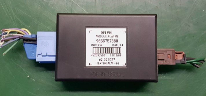

Strange one, do you have Diagbox? If so you could try un programming the alarm.
Alternatively you could try disconnecting the alarm ECU, i know its fitted on the bulkhead inside the car but can remember which side if its above the pedals or behind the glove box.
Looks like this.
Looks like this.

Have located alarm ecu and even with this unplugged the lights still flash
