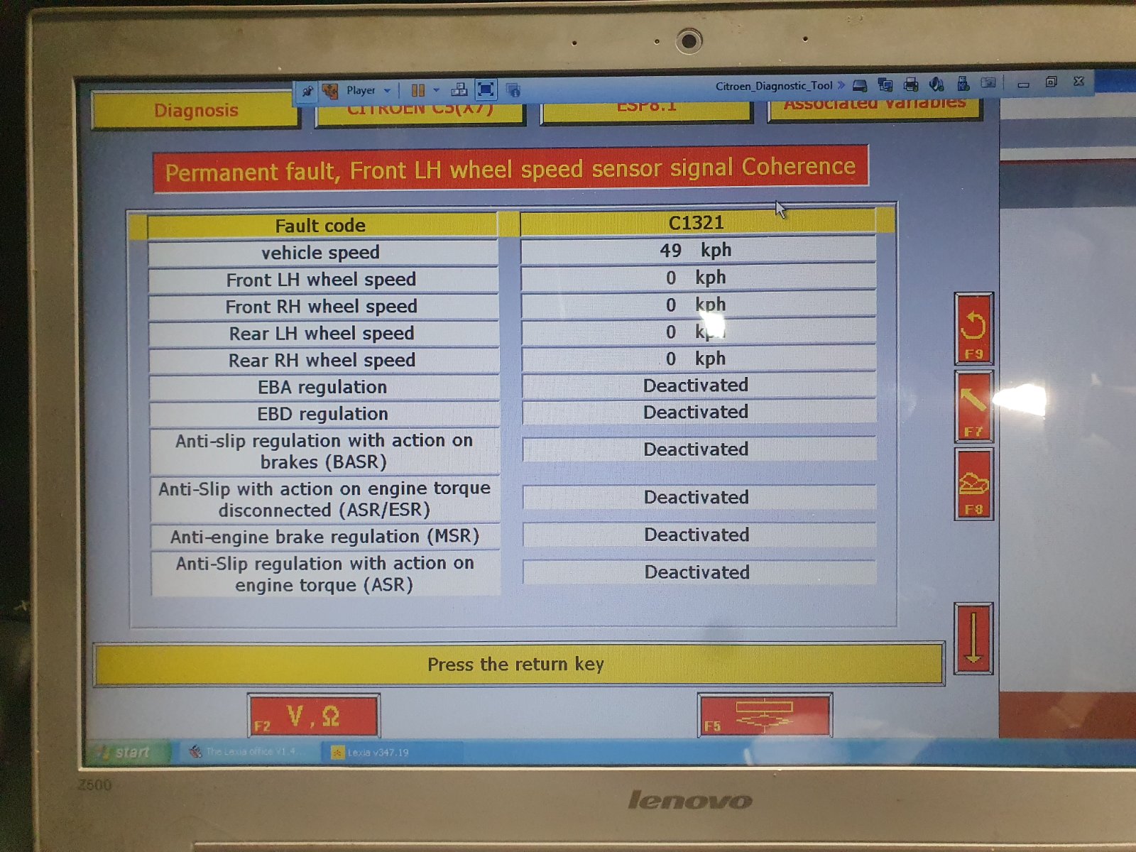

Ok not everything but park brake. Esp, abs, anti roll back.
I think it's actually one fault that causes everything here to also fall.
Got the code C1321 relating to wheel sensor
Abs sensor?
Abs sensor?

Have you tried driving it with live data to see the individual wheel speeds?
Does the fault clear? if so does it come back as soon as the ignition is switched on or does it only come back once you start driving the car?

Yes pretty much that, not looked at the live data yet but it certainly reappears with the ignition on. The warning appeared on the M way

Very likely an ABS sensor, yes. All those systems rely on a speed signal and typically (on most makes of car tbh!) when an abs sensor fails, they all flag a fault.
As already suggested, live data while driving is the way to confirm.

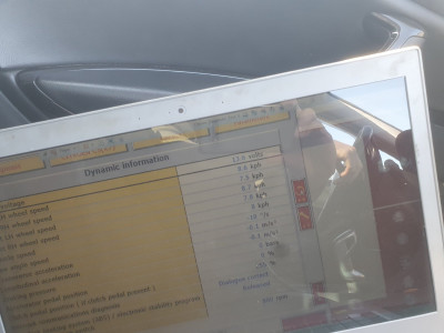

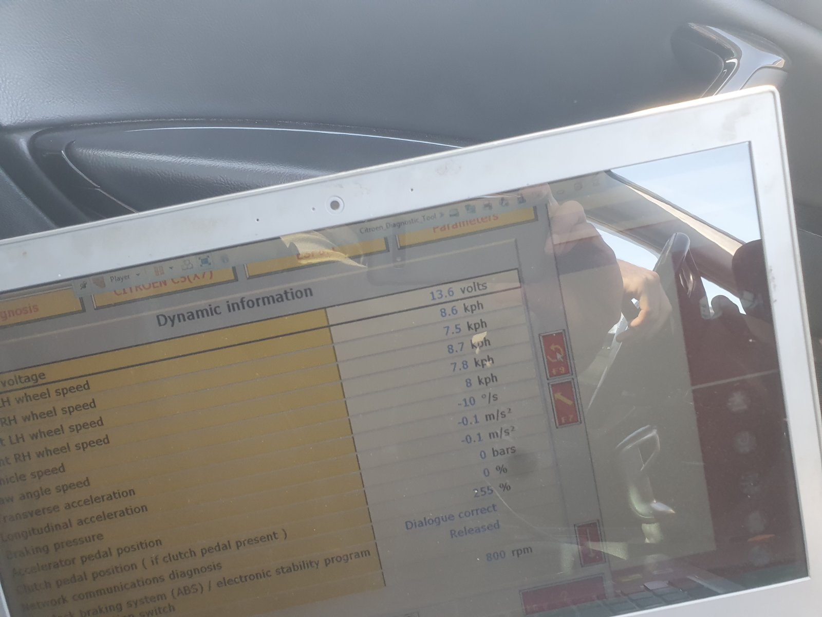

Had a chance to look at the dynamic data from the wheel sensors.
It looks like all 4 sensors are getting sensible readings. Driving straight, that are all the same value as you'd expect. I spent 10 mins driving at less than 10kp/h around the car park areas outside work.
Do why does the car give a fault of sensor incoherence when all 4 seem to give good readings?
I wonder if the sensor reading only goes incoherent above a speed. Trouble is you can't go above 10kph while testing or it disconnects.

The above photo was taken going in circles hence the difference in the sensors' speed readings
