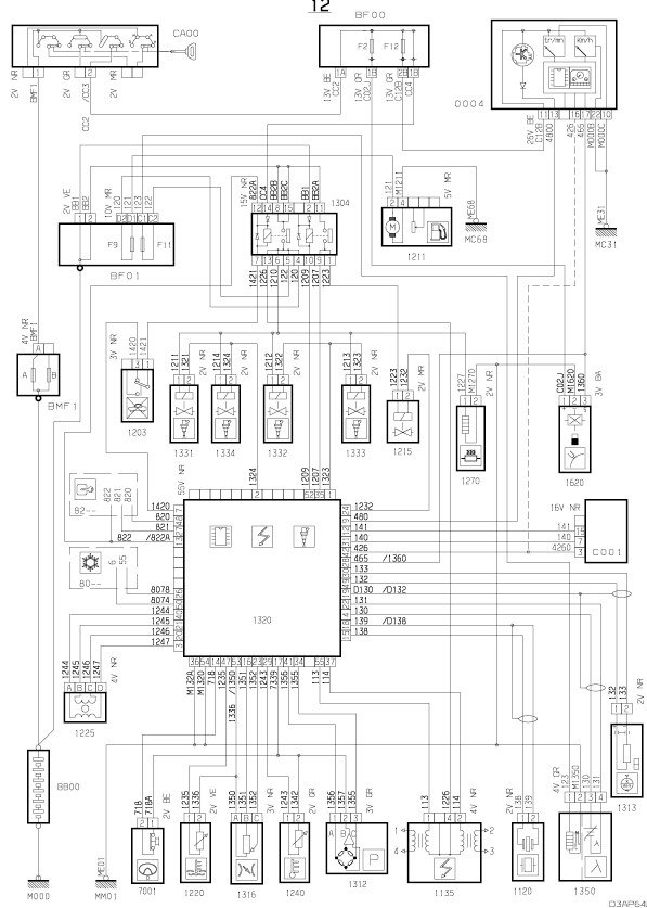

In order to proceed troubleshooting i need wiring diagrams (specifically for the Sagem SL96 ECU fuel injector system diagram to my specific model. I also need information on the Master fuses for my model.

Your RP number is 8628.
Is your ECU a single 55 way connector?
If so this should be the diagram.
A quick glance over it & i can't see a permanent live on this ECU, I would expect that if it was meant to have one & it was missing then the engine wouldn't even start.
If i remember right these ECU's used to get spiked by the ignition coil packs with the black connector, something at the back of my mind is telling me that it was an emissions & idle problems it caused when it failed. If you fit a new ECU without replacing the coil pack it can damage the new ECU.

Thanks so much for the information above but do you have a key for the attached wiring diagram, as I can't really decipher what is what. This would be really helpful.
Yes it is a single 55 way connector.
Would you be able to let me know which is the ECU on the diagram? I assume the big square 1320 in the centre of the diagram maybe.
Which pin do you see the permanent 12V going to on the ECU connector? Which module is the battery?
I identified the K line goes to pin 30 on the ECU connector by testing continuity from pin 7 on the diagnostic OBD2 connector in the car to the ECU connector. Pin 30 on the ECU connector gave a positive continuity test. Is this in line with the attached file?

The key for most electrical components on official PSA diagrams can be found at: viewtopic.php?t=80489

Joemoonlit wrote: 31 Mar 2025, 00:19
Are you saying that if there was no permanent 12V supply to the ECU the car would not actually start?
Only if its meant to have one, however on this diagram i cant see a permanent 12v supply to the engine ECU (1320)
According to this diagram pin 7 of the OBD connector (C0001) is connected to pin 31 of the ECU. Always confirm that the wire numbers you are checking match with the diagram.

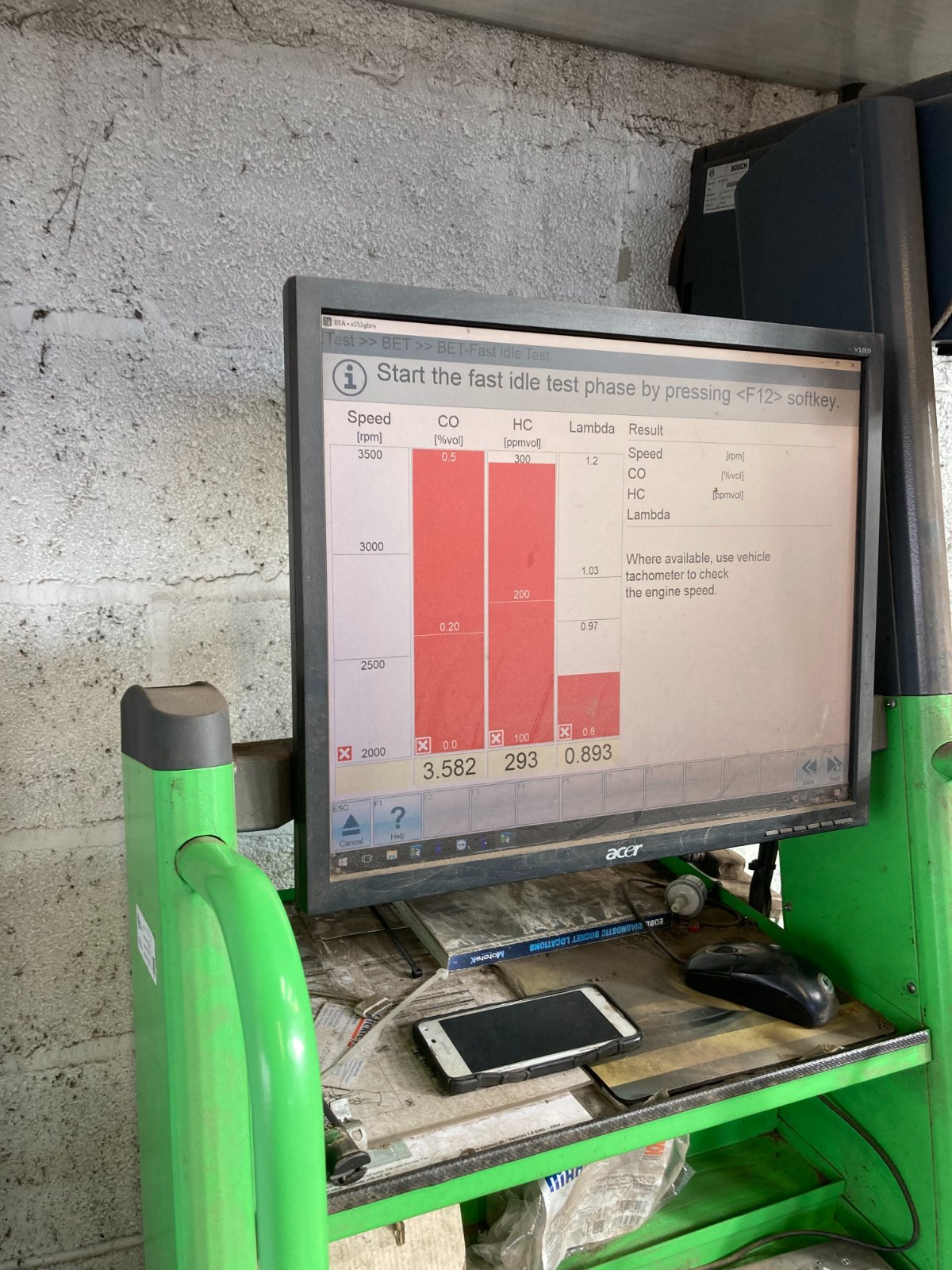

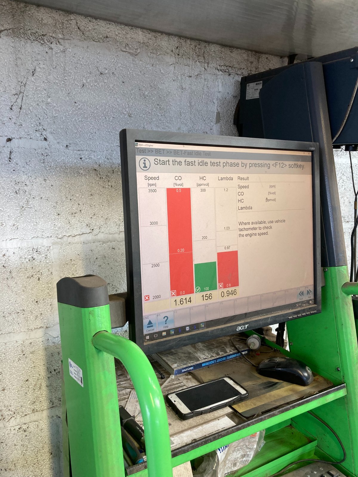

I attached a picture (emission 1) of the emissions readout i saw on his computer. He did rev it quite a bit whilst in the garage as well. Alas to no avail.
Not sure what your thoughts are on the attached file. I will attach another file (emission 2) taken during the same visit. Not sure why the difference. Either way both failed. I think the second image was after revving it quite a bit.

Is it using more fuel than normal?
I wonder if you have a fault with the coolant temp sensor? the ECU may be thinking the engine is way colder than it is & the faulty (and cause massive overfueling) temp sensor could also explain the cooling fan issue

I checked the temp sensor with a multimeter and it appears to work. When i took it into the garage to see if their scanner could connect they also noticed the fan and pulled the temp sensor off. He reckoned the fan should stop if he disconnected the sensor but it kept on going.
I wouldn't say that it was using more fuel than normal and if anything the spark plugs looked by their colour to be running slightly lean.
Just to add there is a brand new cat converter on the car andthere is only one pre-cat O2 sensor.

I read that the SL96 ECU gets its power via a double relay, and the 0004 power supply likely feeds into that relay setup.
It’s essential for powering:
ECU main circuitry
Fuel pump
Injectors
Idle control valve
Possibly sensors like MAP or coolant temp
On the wiring diagram i can see that there is a label 0004, which is not on the key. Would you know if this is the double relay. It shows a wire going from pin 13 on 0004 to the pin 9 on the ECU. I understand this relay is contained in a plastic box near to the ECU/battery. If this relay had a fault maybe it could be the reason no power is getting to the ECU. Any thoughts?

0004 is the instrument panel
The main (or ‘double’) relay is 1304
Again, the failure of the double relay would normally result in a non start situation.
