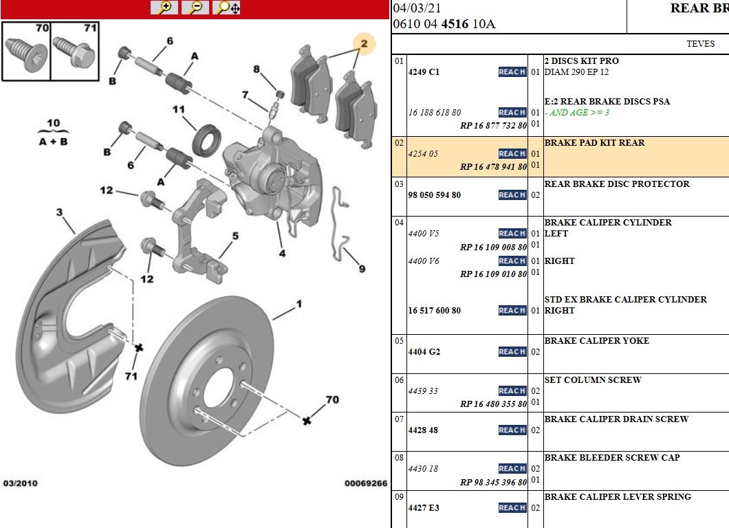

Re: Rear brake pad type or part number
Dealer part number for rear pads is 1647894180
Was originally part number 425405 before it was updated to the one above. These might help to locate the correct aftermarket pads.
Looks like its a TEVES system for electric handbrake & TRW Lucas for manual handbrake.
