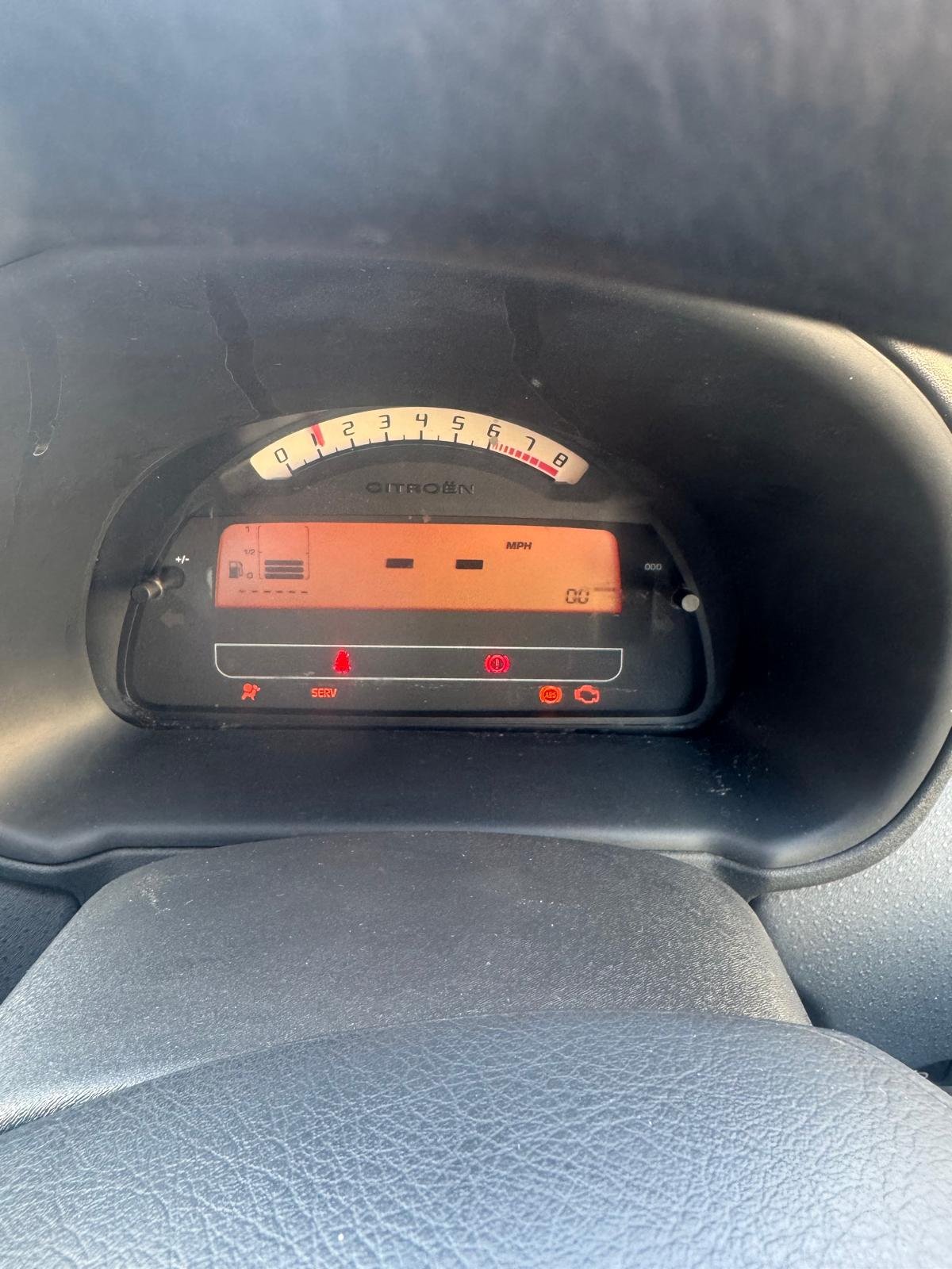

Hi people I really need your help I have a citroen c2 1.1 and all of a sudden my spedo don't work when ignition is turned on it shows 00 but then beeps and has to lines then I have loads of faults showing on the screen abs fault air bag etc and have eml and few others the car runs and drives fine.. any ideas 💡

ABS fault will be causing no show on the speedo.

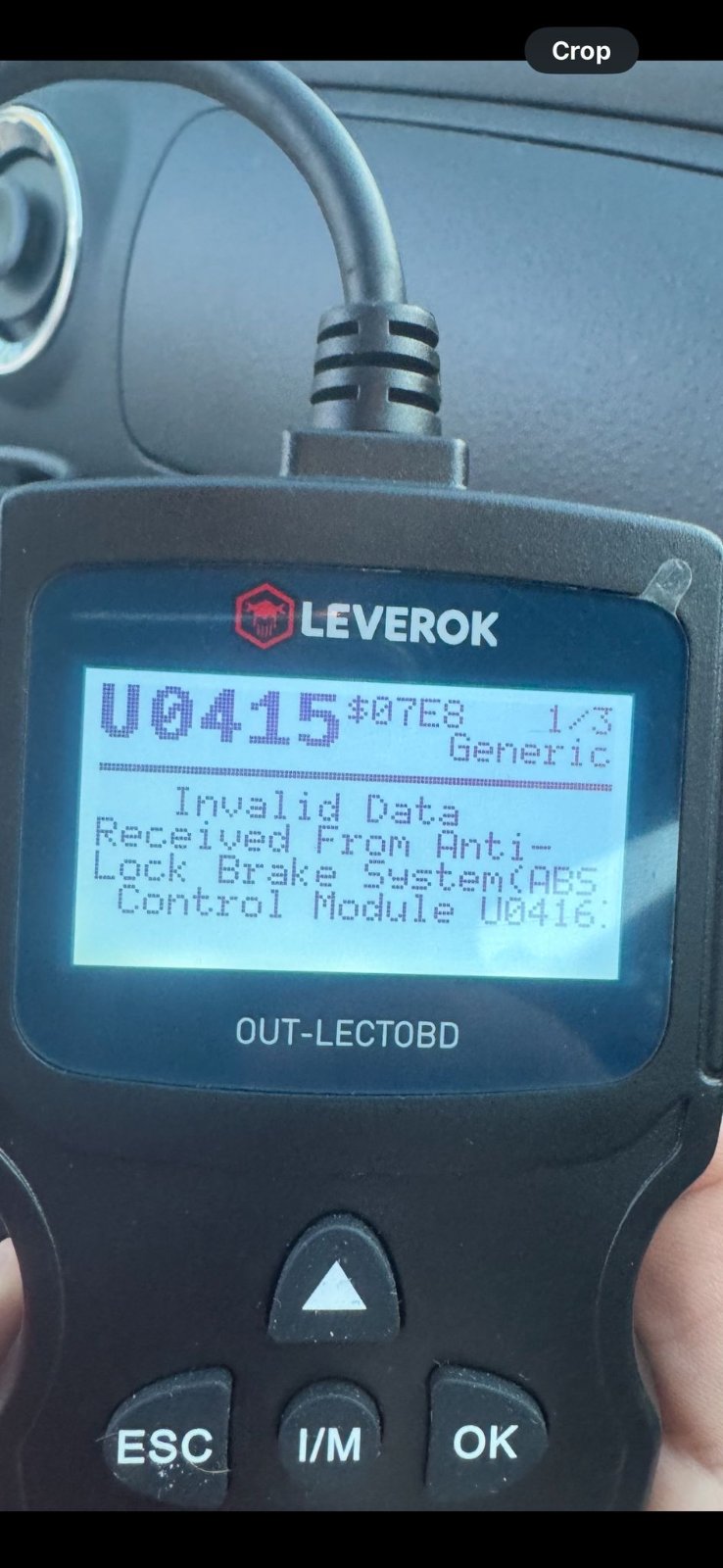

If lots of communication faults id be disconnecting the ABS, engine ECU connection & the under bonnet fusebox to check for water ingress.
Juliano_1989
Posts: 30
Joined: 27 Mar 2025, 20:23
x 1
Re: Citroen c2
Unread post by Juliano_1989 »

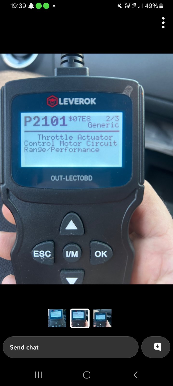

That's one of them

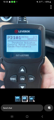

Here is the other 2 faults out of the 3 shown

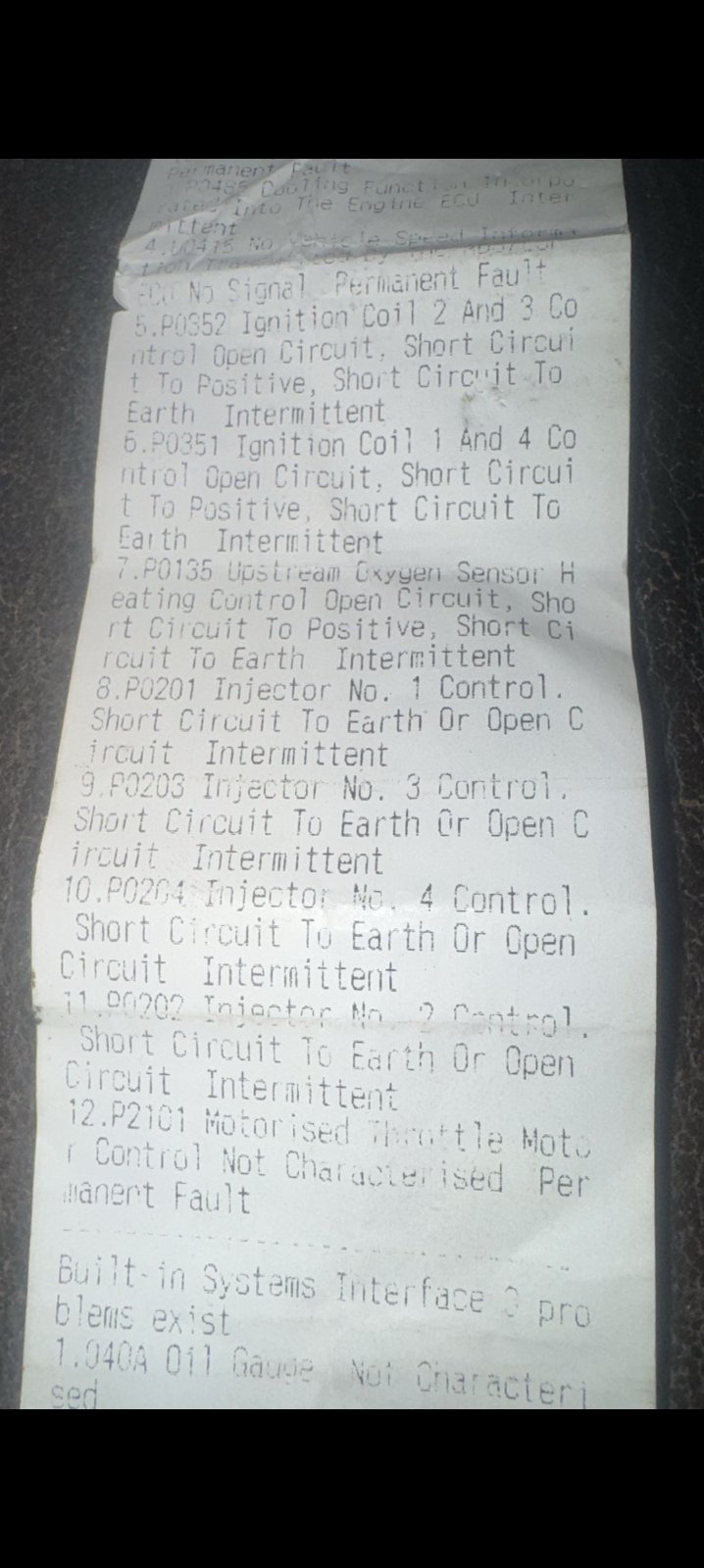

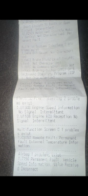

Sorry here u go
Juliano_1989
Posts: 30
x 1
Re: Citroen c2

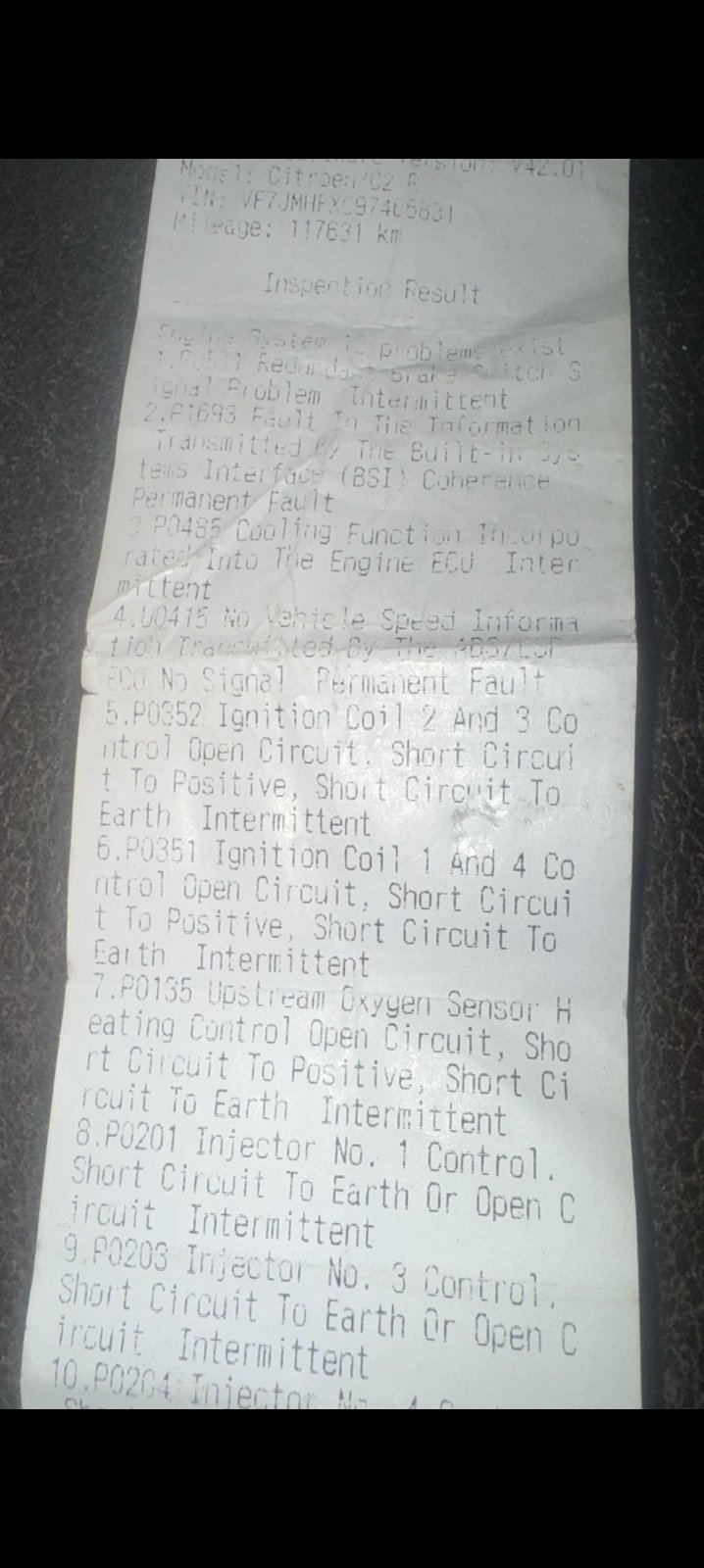

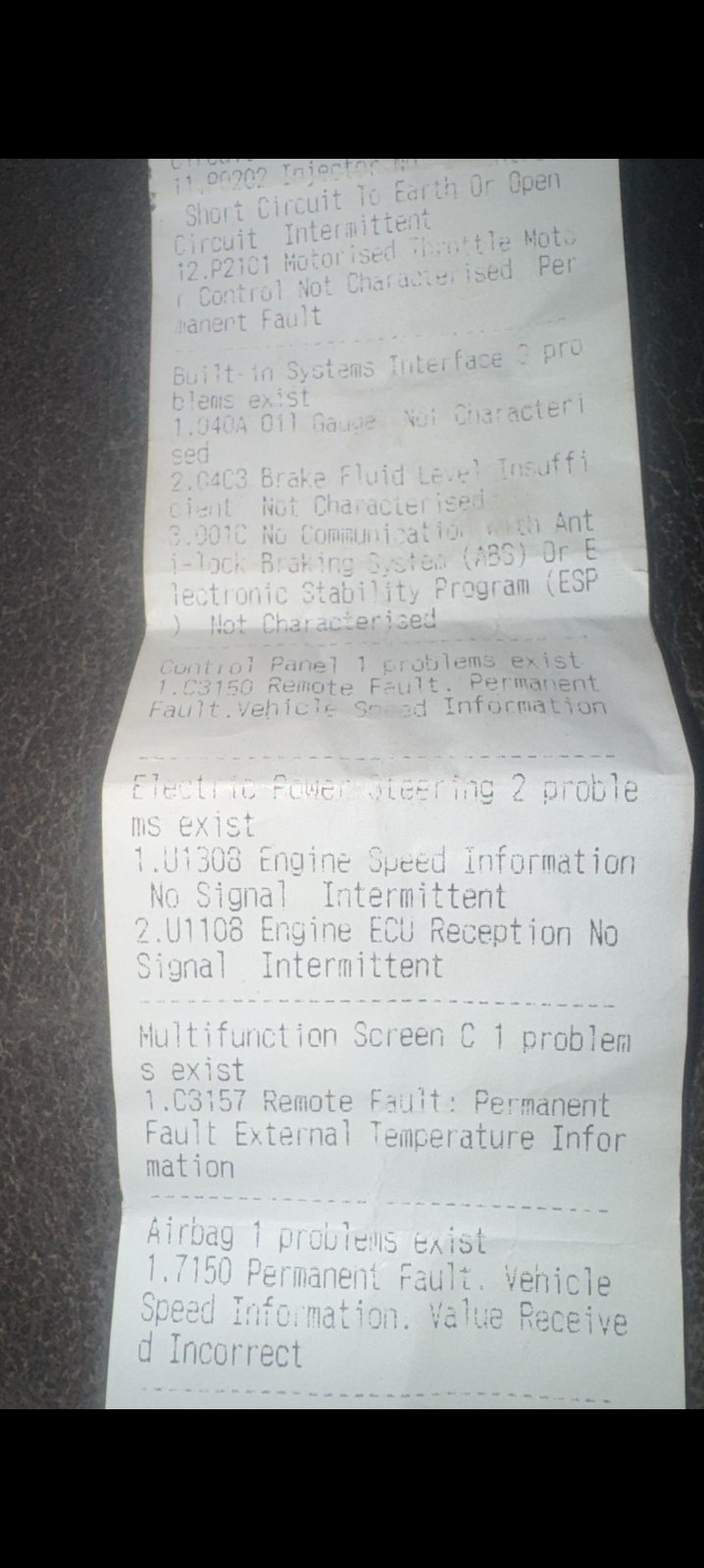

Then I had it plugged in buy a garage and I got this printed out.. this shocked me as surly all this can't be at fault but one thing must be causing a lot of communication errors plesse help guys thanks

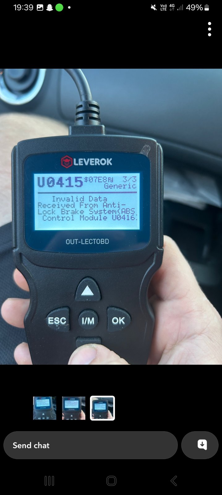

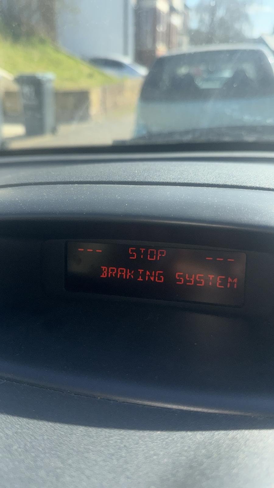

Hi all so I tried a new battery and the faults are still showing ??? I have added x2 pictures of faults being displayed while engine is running

Think you are going to need to start checking power supplies & earths at the ABS ECU.
Do you have the VIN so we can get a wiring diagram?
