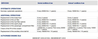

Hi All. I have a Dec 2021 Puretech 208 GT 130 Where does one find the servicing schedules and change intervals for these? There appears to be nothing in the handbook. Any advice would be much appreciated. Thanks, Pete.

Hi, if you contact authorized dealer, he will send you PDF with maintanance recommendation.
This is what I found on another forum for the same car, but I believe the oil recommendation is outdated, that they use 5W30 now. Definitely check with some local authorized dealer.

Many Thanks Arkis.
