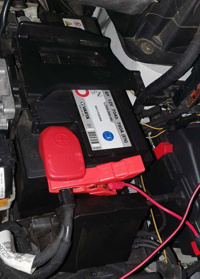

Here is a photo of the battery in the car:

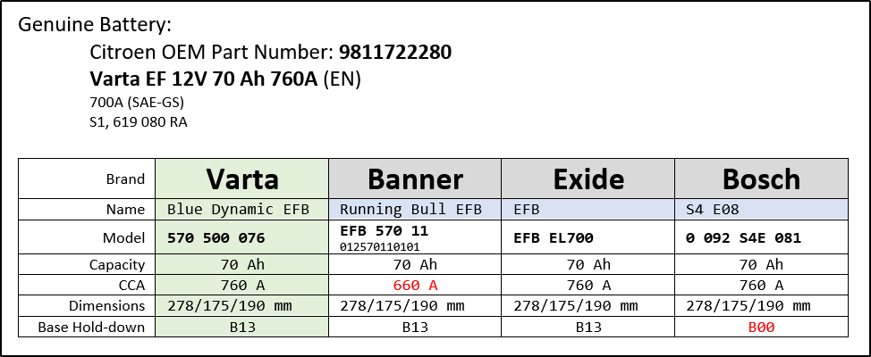

I have compared some battery-models and I will go for the Varta Blue Dynamic EFB (570 500 076), which has the same specs as the OEM-battery:

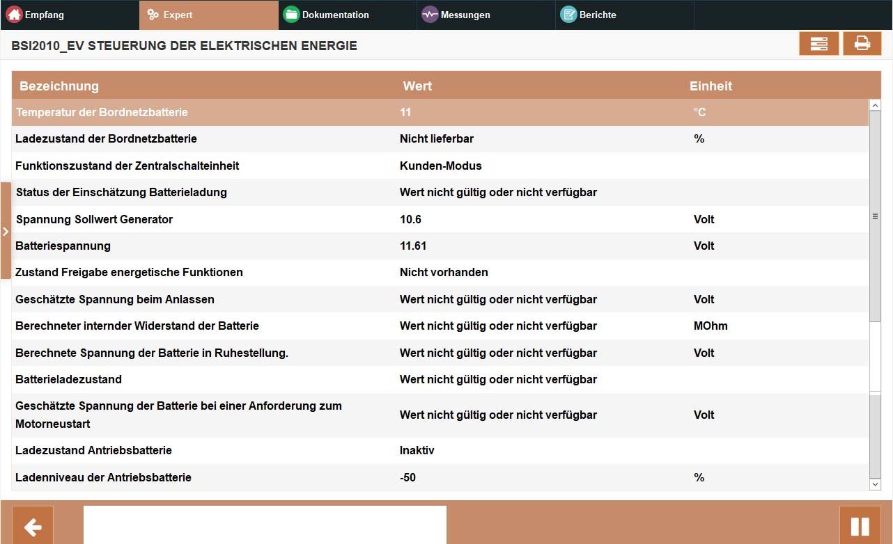

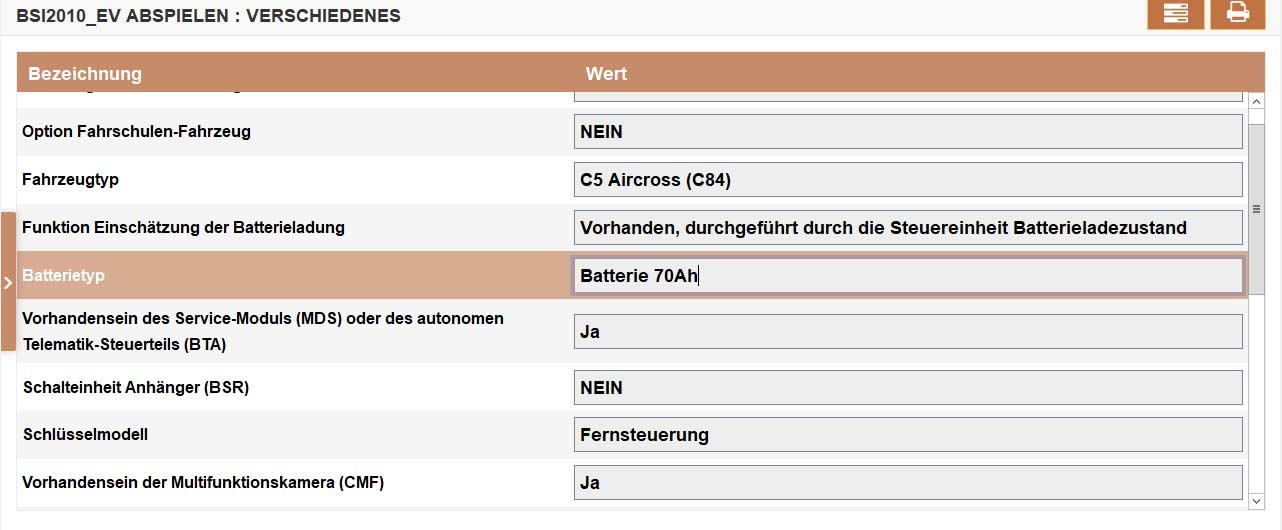

Yes, I thought so. However, while I am waiting for the new battery to arrive, I fired up Diagbox today to retrieve this battery-coding-information.
Unfortunately I was NOT able to find the information I was looking for. (coding of battery-type, etc.)
I was only able to see the following battery-related information until the battery went flat again and diagnosis stopped working:
I am still looking for the following answers:
  • Where in Diagbox do I find the battery-coding-info? (battery-type, etc.)
