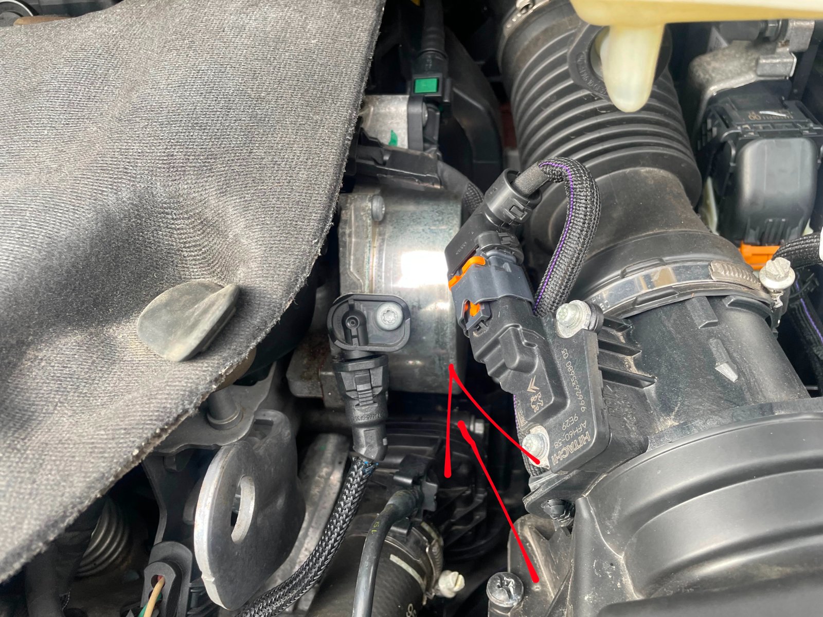

- clicking at the right side of the engine (always) - I have not heard this in any other C4 diesel engine. Can someone help me identify the part in the attached photo, which is where the clicking is coming from?

The part you labeled is the vacuum pump for brake assist and other things requiring low pressure. maybe there is a valve or pressure switch which you hear, but nothing to be concerned off.
