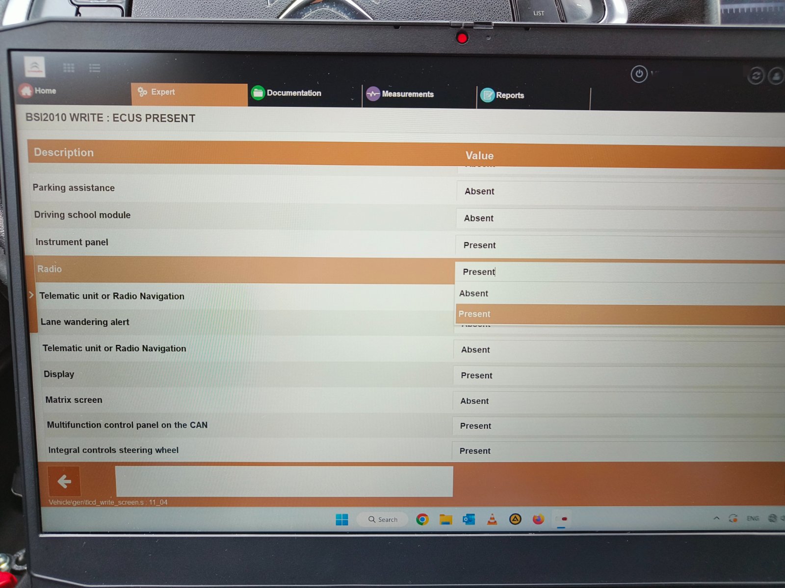

I recently installed chinese android head unit. Everything works fine, but my battery is leaking when the car is turned off. The problem is probably related to the canbus network and communication, it is not a problem with the drain of head unit power supply. The battery leaks as soon as the OEM radio is removed. Is there a possibility to use Diagbox and set it (in BSI configuration maybe), no longer have a radio device? Would that work properly?

You could try that, but just remember to record all previous values before you change anything!

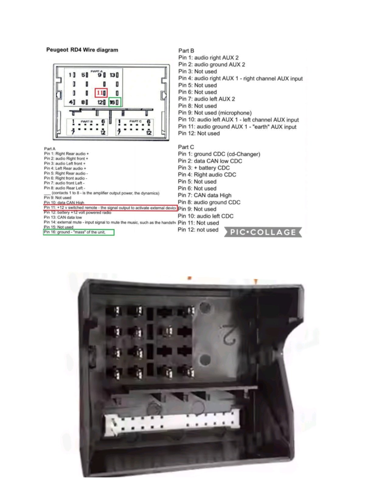

No battery leaks with OEM radio only. The aftermarket radio is well connected. It's simple, +12V from the battery is connected, and there is ACC output from the canbus decoder. 8 wires for speakers and 2 for canbus (Can Data H and Can Data L). The voltage on these CAN wires must be around 0V when the car is in sleep mode, but it is not, there is some voltage. I read that some have this problem and some don't, it depends on the version of the CAN gateway. supposedly the new version of can gateway solves the problem, but I would bypass that (because it is not available) and try to solve it via Diagbox.
I think the problem is in the communication (canbus network), BSI does not receive the information that the radio is off and cannot go to sleep mode. With the OEM radio, I measured the current with current clamps on the battery terminal and it is about 1-2mA, and with the aftermarket about 150 mA. I will definitely scan with Diagbox to see what errors it will display. I was most interested can it be solved in the way I imagined (BSI configuration - AutoRadio - Absent).

The same battery drain exists with the aftermarket radio connected, and when nothing is connected (everything is disconnected). Only with the oem radio everything is fine. The aftermarket radio has a canbus decoder, so it only receives and decodes information from the canbus network and sends it to the unit, I'm not sure if it can send something over the network and communicate.
Connection of head unit is very simple, plug and play, it is impossible to make a mistake. I tried 3 different canbus decoders (manufacturers) , everything is the same.
I also post pictures of the connectors (pinout) if needed.

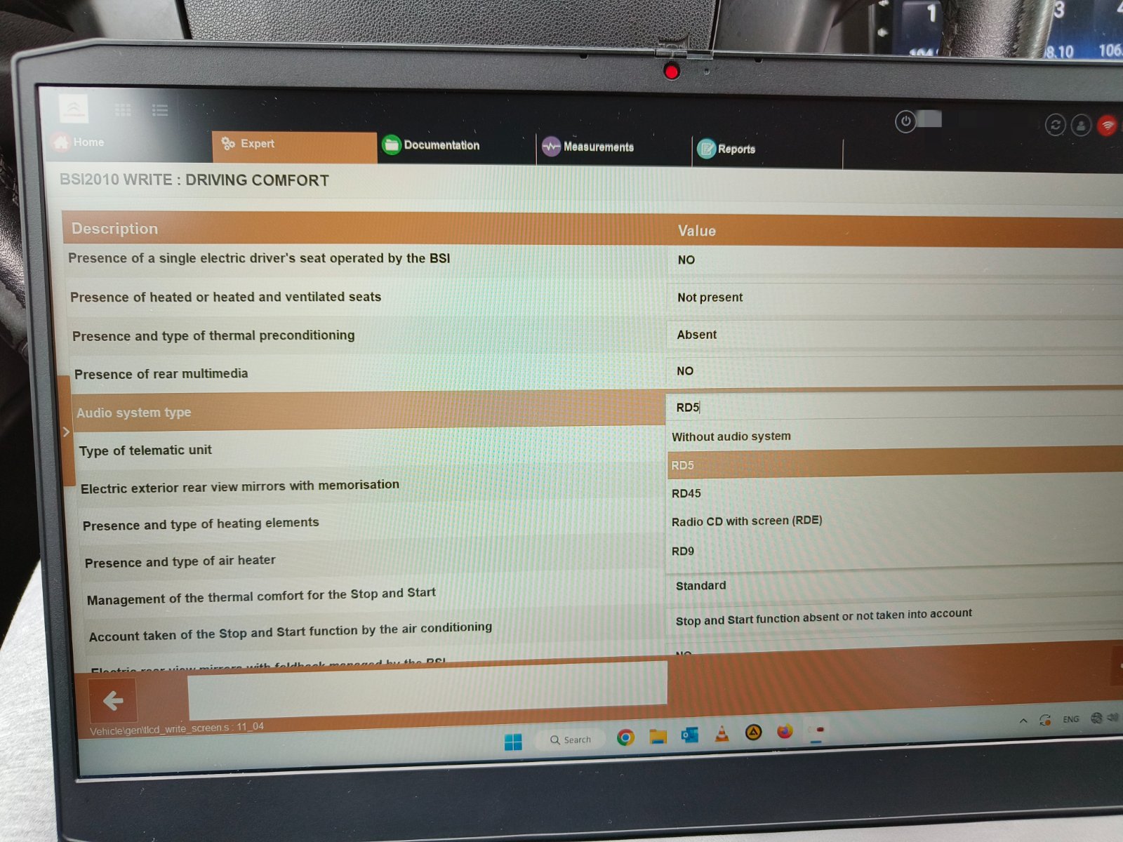

Just to let you know that I solved it. This is the solution (Without Audio System & Absent). Now, BSI doesn't report any errors in communication with the radio device and probably goes into power save mode properly.
