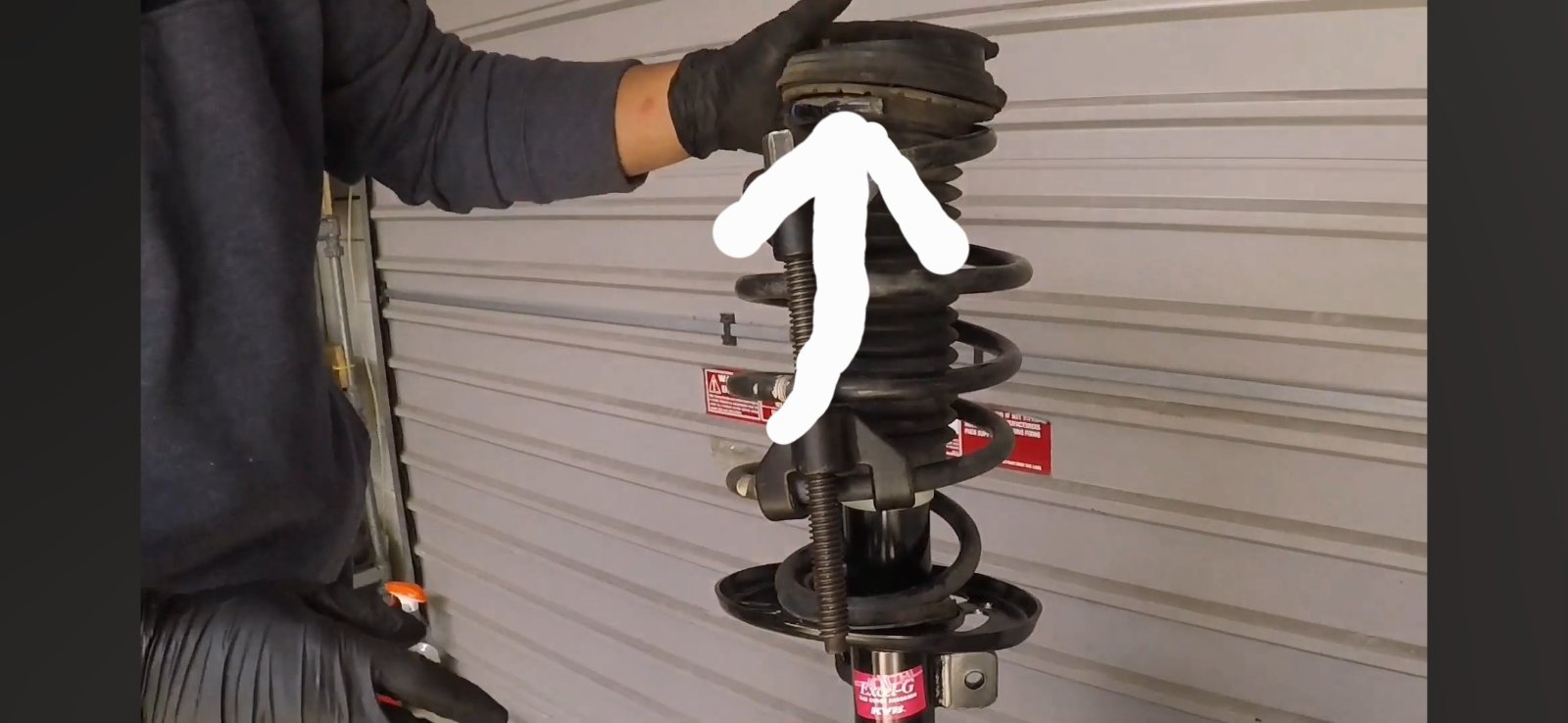

After doing my front strut swap all was well until the driver side started rattling again .. the driver side was always the worse so I've had a look under today only to find that the driver side is missing a black rubber bush that the strut top bearing sits in... this part wasn't there when I done the swap as I put all parts together then swapped like for like... ive got a screen grab from the tutorial video I used where the part can be seen...its the part with the checks out the bottom the vehicle is a 2015 c4 grand picasso ... any help greatly appreciated [/img]
What do you mean?
You also haven't mentioned the version - or year.

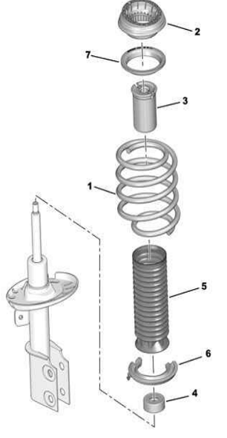

But basically an example from top to bottom on a MK II C4 Picasso
(2) Rear Spring Upper Cup
(7) Cup
(3) Front Suspension Rebound Stop
(1) Spring
(5) Shock Absorber Rod Protector
(6) Cup
(4) Front Suspension Bumper Spacer

Thanks I've edited the post....2015 c4 grand picasso....its the rubber with the checks on the bottom that the friction bearing sits into....hopefully I've explained it better.

Ok, so I've replaced all that with the MK II

Thanks very much for your help ive managed to order the part from Citroen and it was only a fiver..i also ordered a new bearing just incase the current one is damaged
