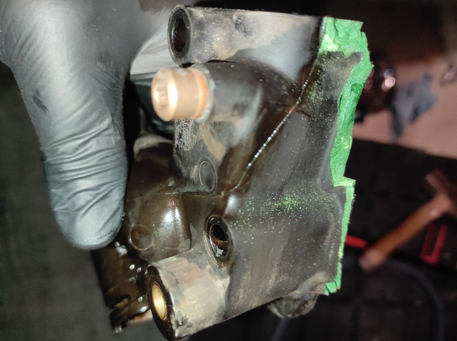

Re: 308cc (2009) Coolant Loss (internal) & Anti-pollution System Fault

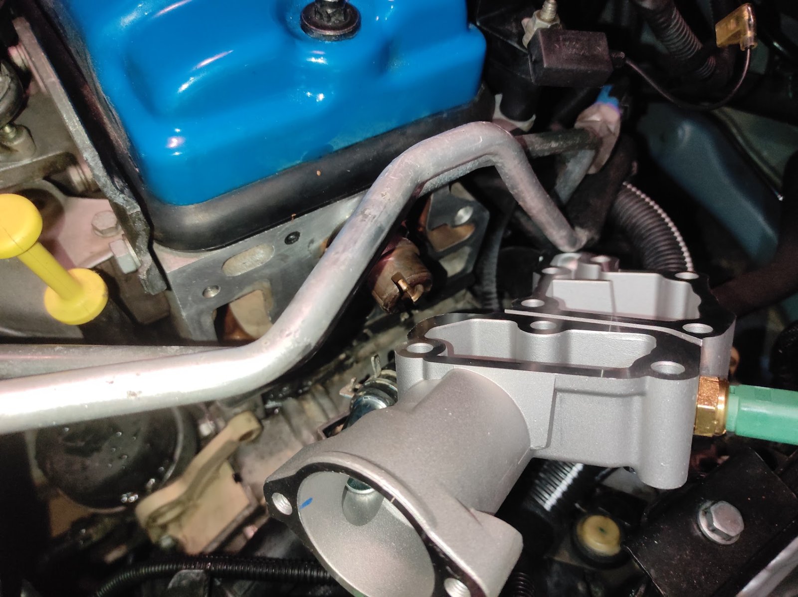

I had similar coolant loss to this recently, same Prince engine, no signs of leakage but the coolant bottle was emptying over the space of a few days, with the low coolant warning coming up on the dash
regularly, initially started thinking head gasket but it wasn't!, it was the thermostat housing, the leak was so fine it was virtually misting out and away once the temperature
was high enough, so no pools of water anywhere.
I decided it was a worth a try replacing the housing first before stripping the head off it, lo and behold it has held all it's coolant since.
There's a chance if you get right in to view all over the top of the gearbox you might just find a tiny pool of coolant
in one of the recesses just below or behind the housing itself.

hi, are you able to show me on a photo where i can find this housing & also you go about replacing it?jamie-n wrote: 21 Mar 2025, 09:27 I had similar coolant loss to this recently, same Prince engine, no signs of leakage but the coolant bottle was emptying over the space of a few days, with the low coolant warning coming up on the dash

Thermostat housing is located on right side of the engine (above transmission). You will easily find it by tracing coolant hose from the radiator. If you're lucky enough, there will be aluminium alternative for your housing. This is for example on my 206 TU3JP (year 2005).

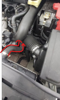

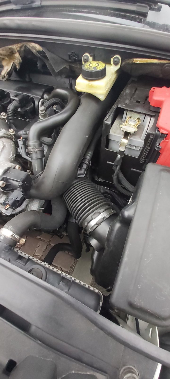

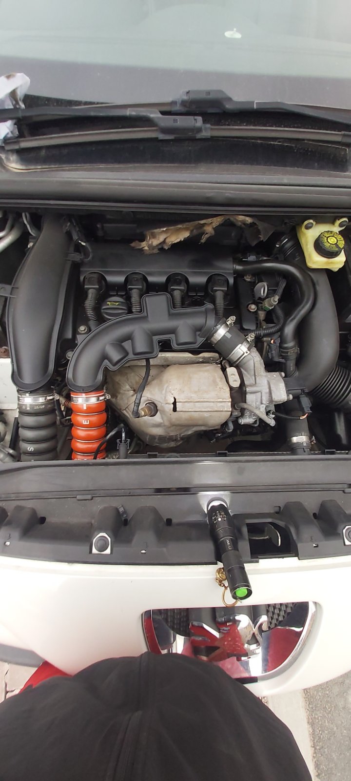

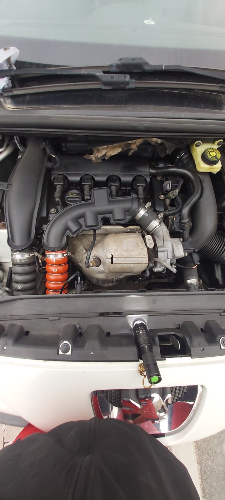

divettri
- Posts: 25
- Joined: 21 Mar 2025, 04:11

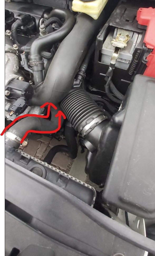

Hi, please can someone advise where to look for this thermostat valve (images attached)? Not much room in the engine bay to be honest.Arkis wrote: 21 Mar 2025, 18:12 If your car is burning coolant in a matter of days you will see white smoke coming from exhaust (don't mix it up with condensation that occurs during warming up of exhaust during cold days). One of big giveaways of burning coolant is that the white smoke is usually almost like sweet.
Also noted was the exhaust blowing a bit of white smoke, not sure if this means anything or whether the car was just cold at the time?
308cc (2009)
Follow this coolant line and you will find it.
The coolant hose from upper radiator is directly attached to the thermostat housing.
White smoke from exhaust can be condensation or burning coolant. If it is still smoking after engine is up to temperature it is most likely burning coolant and you should do headgasket test.
