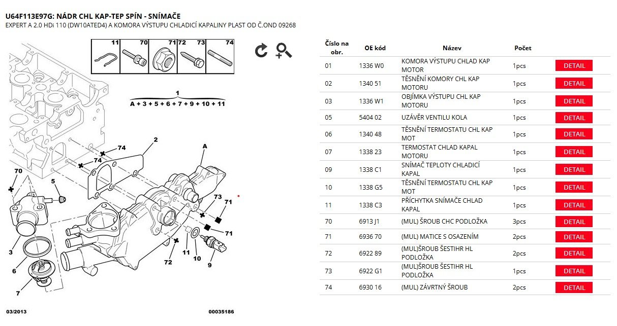

According to the microfiche, you have only one temperature sensor. Original number 1338C1.

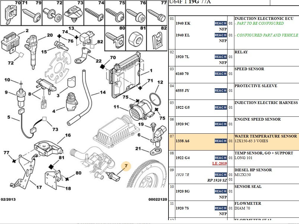

Service box shows 2 temp sensors for this vehicle. A 3 pin one part number 1338A6 and a 2 pin one part number 1338C1.

wheeler
- Posts: 7907
- Joined: 21 Sep 2002, 19:07
- x 1049
Re: cooling fan running all the time
The one you can see is listed under cooling system, There is another one listed under engine management.

think I've found it but not where it shows on the drawing, on my engine its on the rear r/h looking from the front of the van, and looks like part no 9802028080wheeler wrote: 22 Mar 2025, 18:22 The one you can see is listed under cooling system, There is another one listed under engine management.
