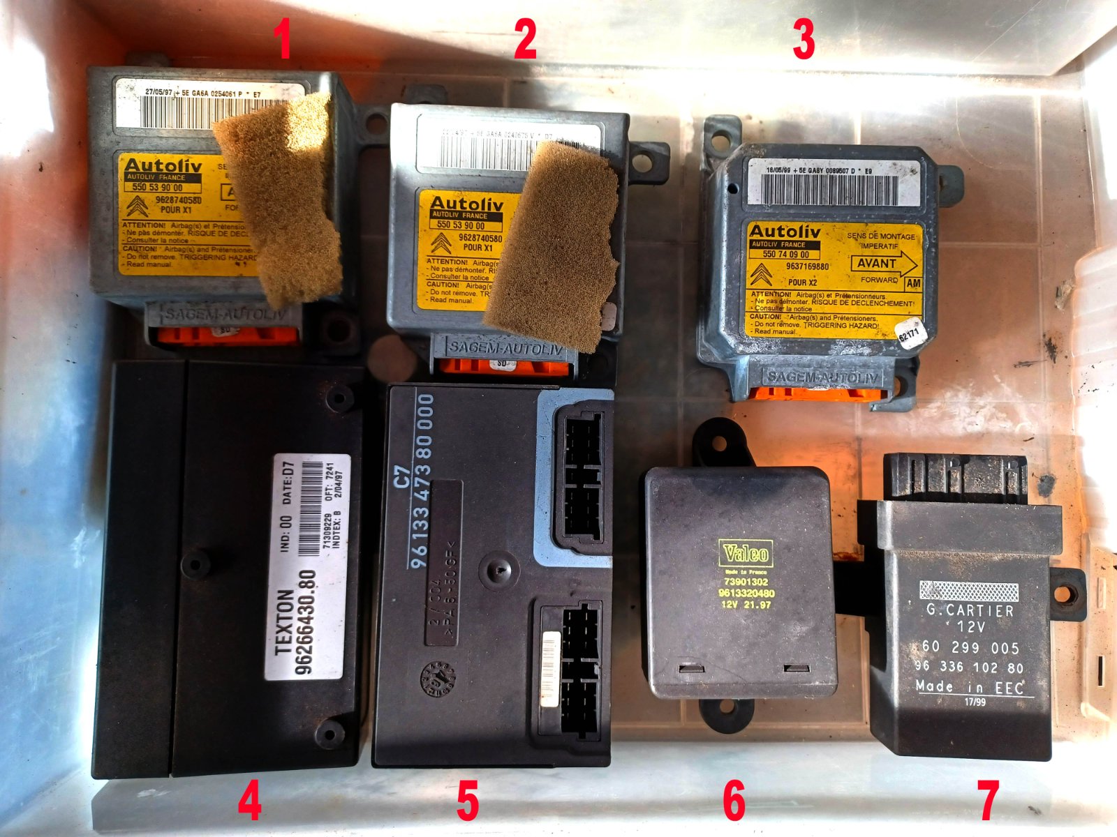

ID some Xantia ECU's for me please
Posts: 11836
Joined: 28 Mar 2013, 21:05
x 2005
Unread post by Stickyfinger »
Could be S1 or S2 cars
1. seatbelt tensioner
2. seatbelt tensioner
3. airbag module
4. immobiliser
5. alarm module
6.
7. rf receiver for central locking

furriegurrie
Posts: 205
Joined: 07 Dec 2012, 15:21
x 40
Re: ID some ECU's for me please
Unread post by furriegurrie »
1 and 2 seatbelt tensioners. 3 airbag module. 4 immobiliser 5? 6? 7 rf receiver for central locking.
From Xantia or Xm
x 6957
Re: ID some Xantia ECU's for me please
5 is an alarm module.
6 Window Module for XM
GiveMeABreak wrote: 18 Mar 2025, 21:13
I have not "broken" an XM....could it also be from a Xantia ?
Unread post by wheeler »
4 is the CPH module from an S2.
Unread post by xantia_v6 »
Stickyfinger wrote: 18 Mar 2025, 21:35
Possibly an Exclusive, but S1 and S2 are different.
x 6957
Yes it (6) was certainly fitted on a 1999 XM (Y4) so S2, 2.0i 16V.
