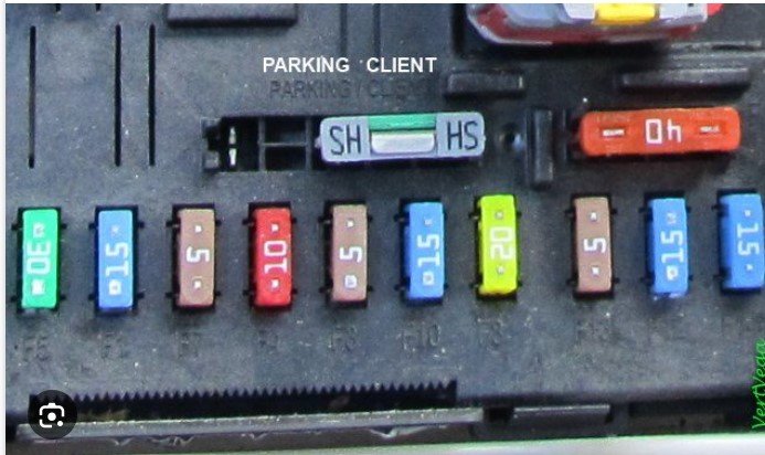

That behaviour would typically indicate a blown fuse, or the parking shunt is fitted in the wrong position.

Re: CITROEN C6 WON'T HOLD CLOCK TIME SETTING
I would agree with that, either a blown fuse or the shunt is in the wrong position.xantia_v6 wrote: 18 Mar 2025, 00:45 That behaviour would typically indicate a blown fuse, or the parking shunt is fitted in the wrong position.
Check on the BSI there will be a shunt like this one that can be fitted in 2 different positions, check it is in the 'Client' position. It is placed in the 'parking' position before it is delivered to the dealership which turns of certain unnecessary things that draw power all the time (like radio memories).
