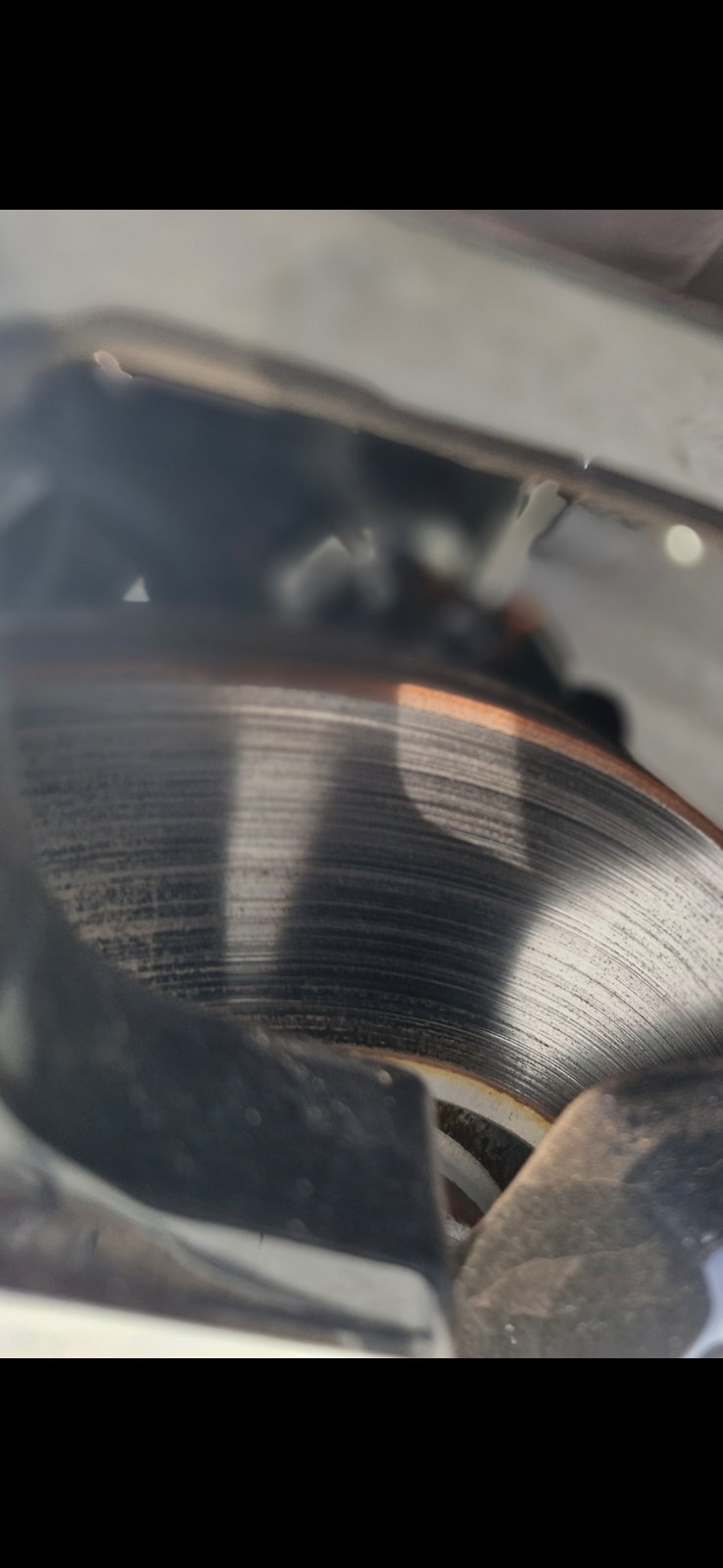

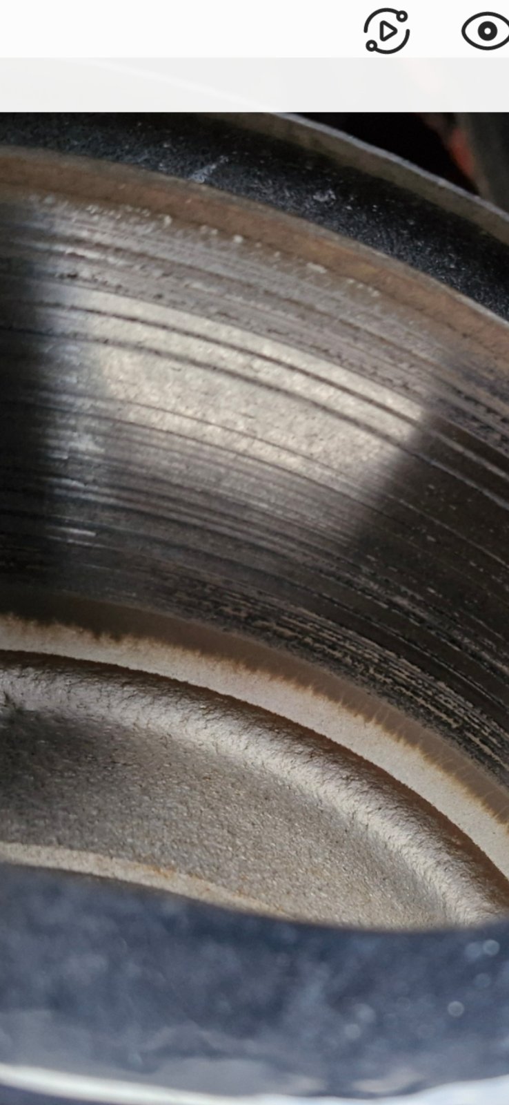

Hi Guys thanks for replies car has stood at Docks since Nov last year.
( See pics attached)
This is how car was delivered also straight from there not via a Dealer then these Issues started immediately,also handbrake sticking on unable to release so Dealer looking at this too still saying ev cars heavy so will make some noise ( but these are Loud clonks with grinding noises . So Doing full examination of braking system not taking car back until satisfactory!

The parking brake sticking is quite usuall with these. I have C4 Picasso and the parking brake sticks too when it's wet. I would normally not engage the parking brake but sice it's automatic, I can't turn it off (because of the loud alarm which wakes everybody around). So in wet and cold the brake just freezes or lightly rusts to the disk and you need to tear it... That's why I don't like e-brake.
But your discs look not so good for a brand new car. They are heavily pitted and there is quite a good amount of rust too. I would assume there was some dirt/rocks on the pad and it made grooves in the disc.

When at the dealer ask them to show you the scoring on all the other cars they are selling. I would still check the RPO number since if at the docks from November it is older than that. With the rust and scoring the discs look older than 100 miles, could the mileage have been clocked ?
Citroenman3
- Posts: 3
- Joined: 06 Jun 2023, 22:57
- x 1
Re: E-2008 Grinding noises from brakes
Thanks yes checking this also seen other new cars there with no scoring on discs .This is why I think they have taken it back in quickly for full investigation. No mileage is correct seen proof. Will advise on outcome
