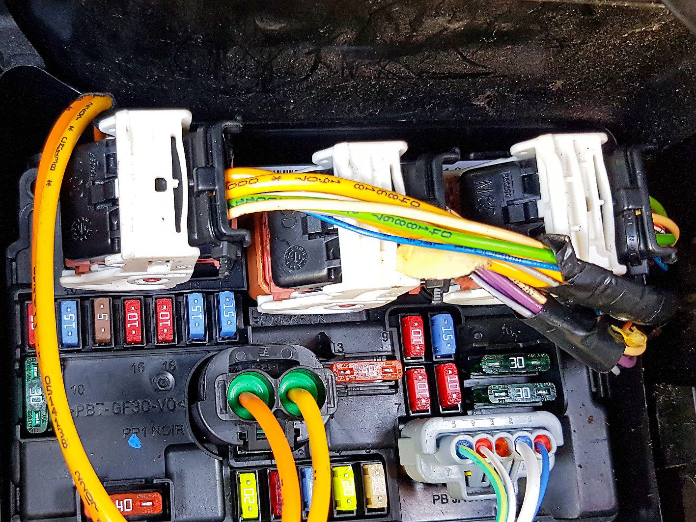

There's a good chance it's the fuse box unit at fault - here's one on a van where only one side was out. This might lead you to knowing which wires are which, but maybe not...

Good morning RichardW - many thanks for your input which leads me to where my fault may be on the Picassos side light which is, as you will be aware possibly the very same set up as mine.
Not being disrespectful to the young man who kindly took the video, I would have love to have seen the reason for the BSMs failure, was it the result of water ingress? Just this Old Codgers thoughts.

it's likely Robert, I'm aware the Picasso has a bit of a reputation for water ingress in this area...Retired TD wrote: 28 Mar 2025, 09:19 I would have love to have seen the reason for the BSMs failure, was it the result of water ingress? Just this Old Codgers thoughts.
