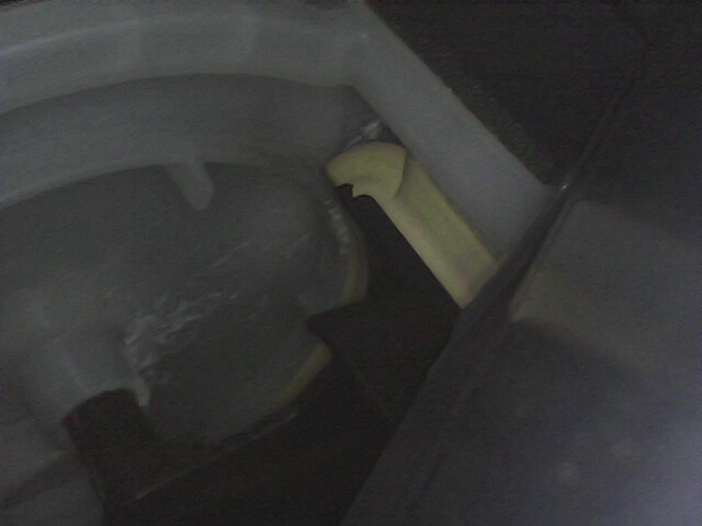

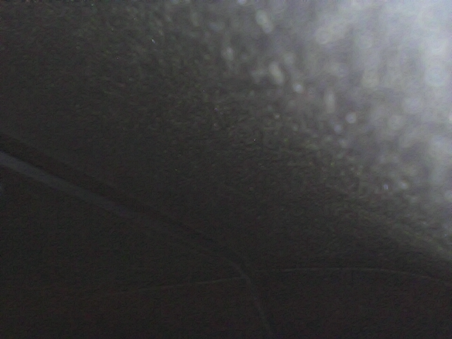

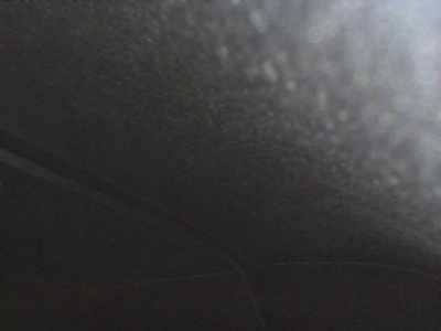

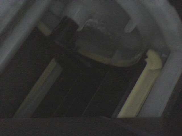

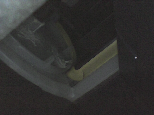

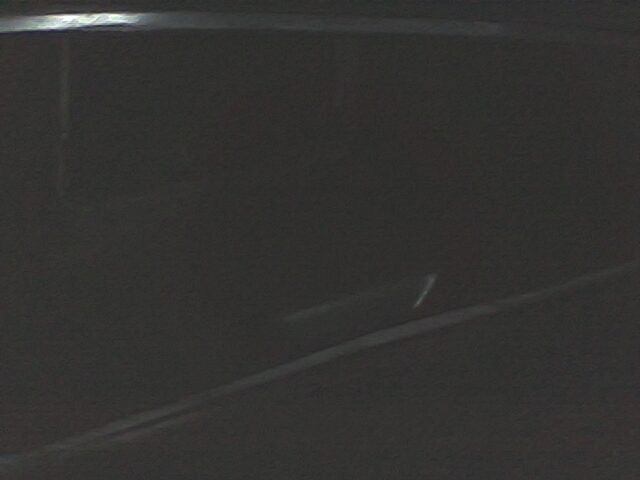

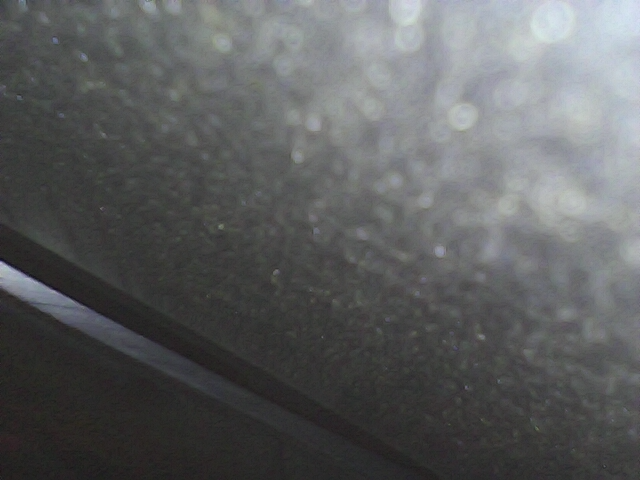

I was able to take a few pictures with an endoscope camera. Could it be leaking, or could the plastic parts be broken or not installed properly?
I found out that a lot of holes were sealed with sealant.

I am not sure what we are looking at. Is this inside the heater box?
The yellow (rubber?) things seem to be displaced and could be jamming the flaps.

Yes, that's right. I went through the ventilation shaft with the camera. At the end, you can see these flaps. I have another video, which I unfortunately can't upload...

In the first video, you can see that some plastic part isn't sitting properly. This is the case on both sides. In the second video, I tried to show how it works when I set the air conditioner to full cold and full warm.
