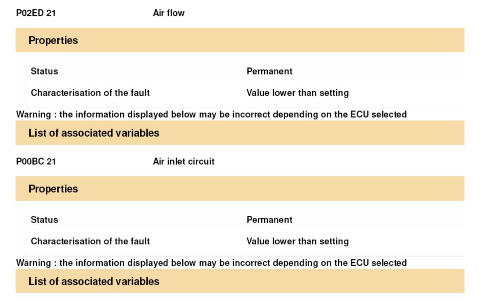

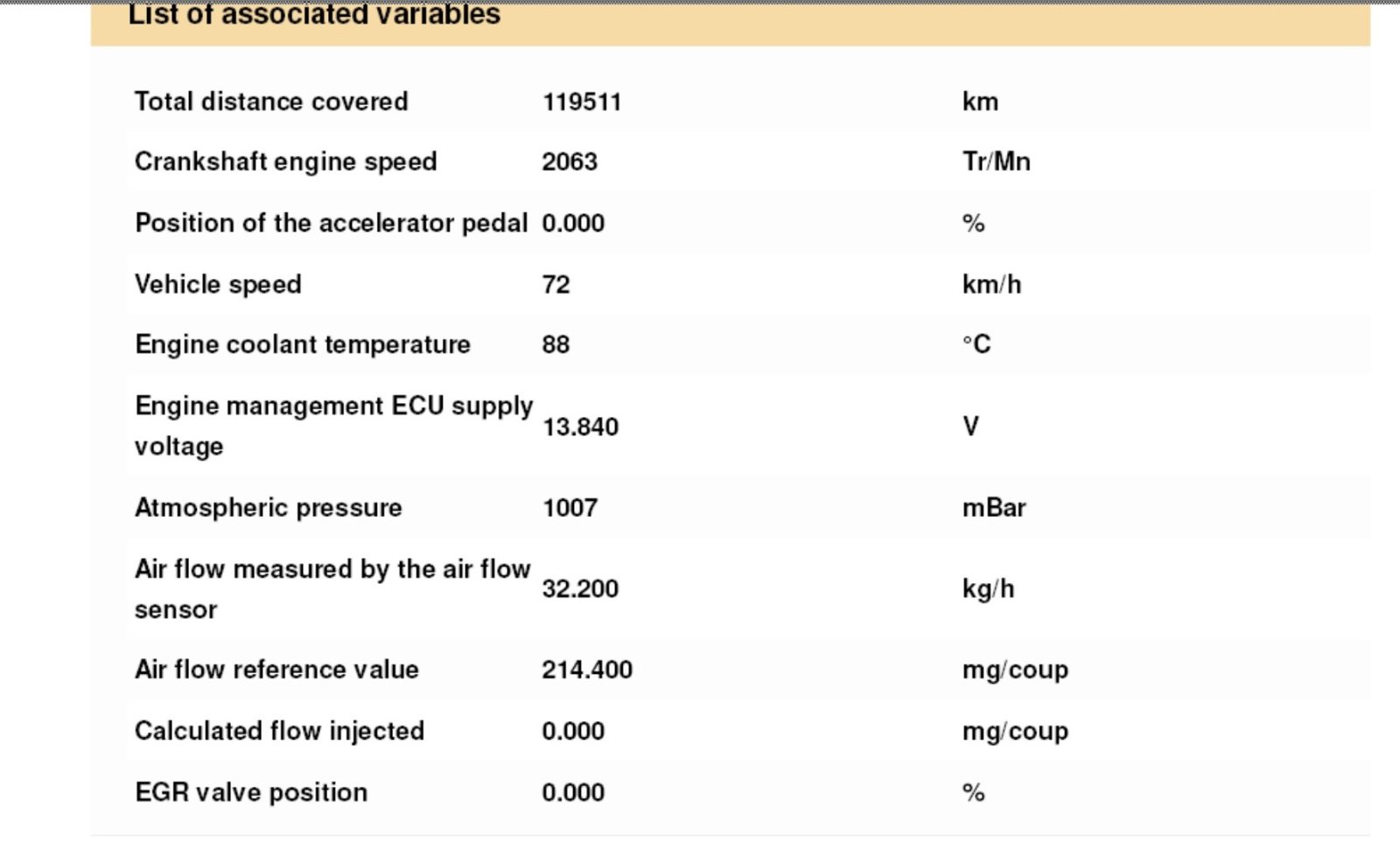

This morning I put it on Diagbox and found codes P02ED and P00BC stored in the Engine management ECU. Details of the parameters when these codes appeared are attached as a picture.
Can anybody shed some light on what the issue might be?

Unfortunately with sudden cut out on this engine the first candidate has to be failure of the cam chain in the head. I don't know if you can see the cams through the oil filler, but that is where I would look. The inlet cam is at the back driven by the chain and if that has stopped going round then you will have no air flow. I also don't know if these have vertical valves like the 8vs and therefore get away with breaking the rockers, or if this is a head off job. Sorry to be the bearer (probably) of bad news....
