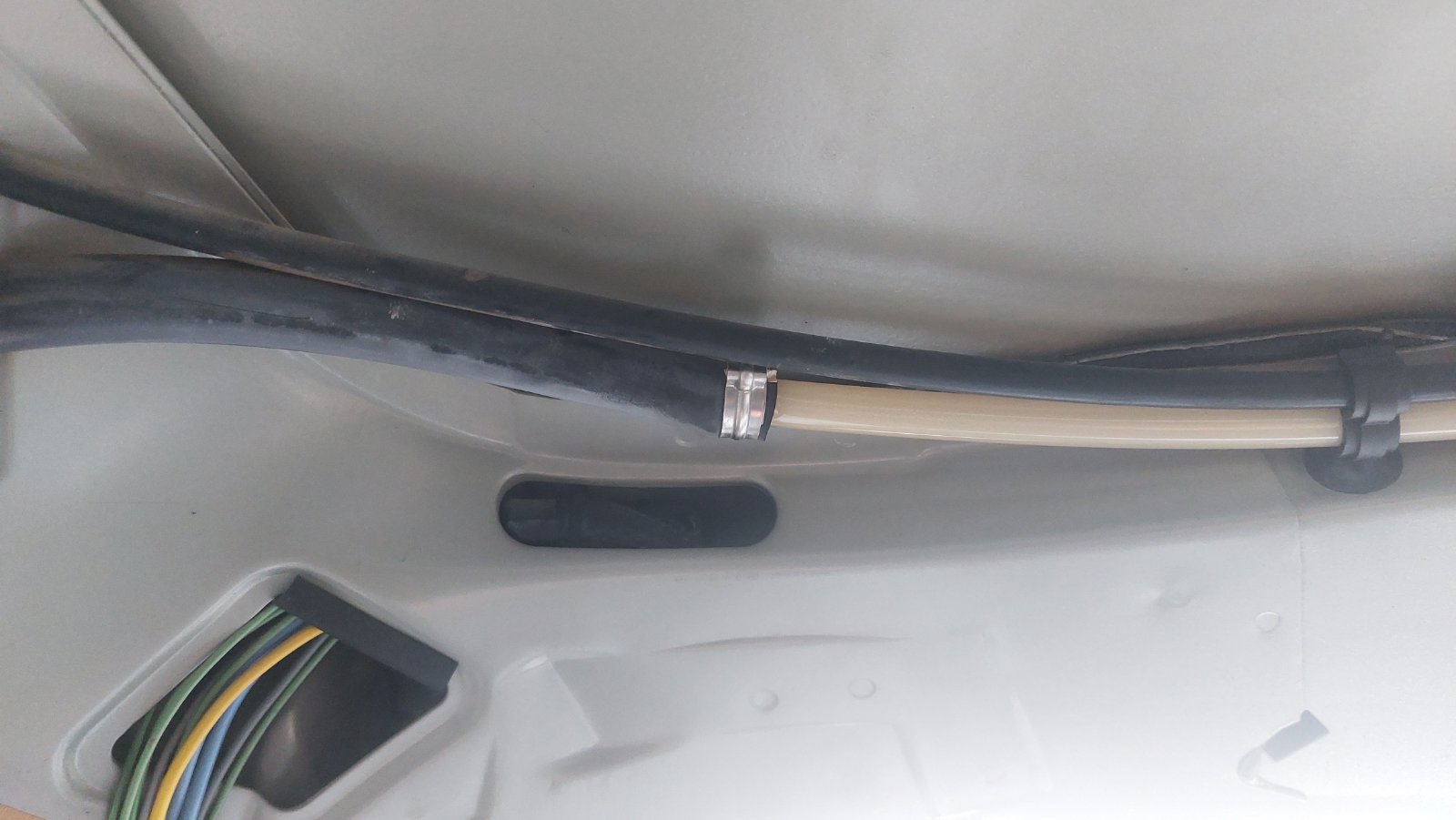

So to cut to the chase. After removing the headliner I noticed in the back, that there are two hoses on the roof, one thin and one thick, one I'm sure is for the rear washer, but what is the other thicker one!?

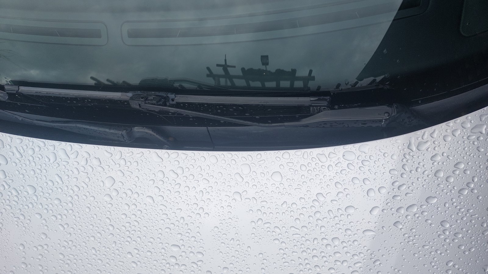

Second thing, after all the soaking carpet I had to deal with I'm a bit paranoid about water ingress in al the usual places. So after inspecting the cowl panel for leaks I noticed a crack, or is it? So the question is, does this plastic come in two parts or one single one and mine is cracked?

The thick pipe is the sunroof drain. There should be two, one on each side. they often detach at the sunroof gutter and can cause leaks above the headlining. Maybe why it was originally removed? Check they are clear - they exit in the tops of the rear wheelarches and can get blocked with mud.
The windscreen scuttle (cowl) must be firmly bonded to the screen to prevent water running in and gathering under the footwell carpets. It's all in one piece but very fragile; hence why they often end up cracking.
Leaks past the panel are much worse in Right Hand Drive cars and much less of a problem in a Left hand Drive car like yours. It's still a god idea to ensue it is well sealed against the windscreen and that crack is repaired.

But it doesn't have a sunroof, did they install it anyway? There was evidence of a leak after I removed the headlining at the pipe joint. By the way, the pipe comes out of the front left pillar, goes to the back, along the boot edge and into the right rear pillar, weird.

Is that pipe perhaps a fuel tank vent headed for the charcoal cannister?

xantia_v6 wrote: 15 Mar 2025, 00:36 Is that pipe perhaps a fuel tank vent headed for the charcoal cannister?
Does look like it's going to the fuel cap yes
Surely not running inside the car??
Would need to go from engine bay, inside the car then back out again to the fuel tank?
