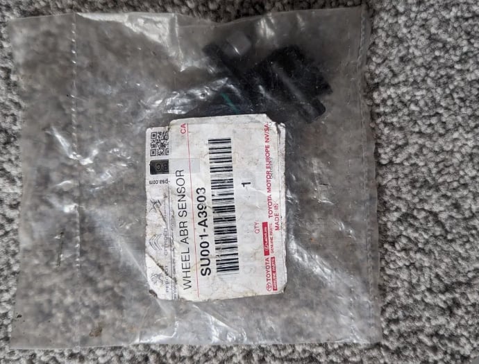

Thanks for the reply. Do you have by any chance a picture of this sticker?
Toyota has just one number for the part su001-a3903 but its just a PSA part with another sticker.
Actually i have now just found some foto of the photo of the sensor where you can see the PSA numbers
For now I have bought another sensor OEM 9806041680 as seen on the photos, should be there before weekend so Ill keep you posted.
