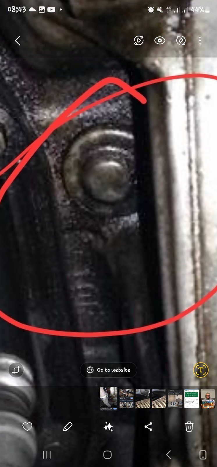

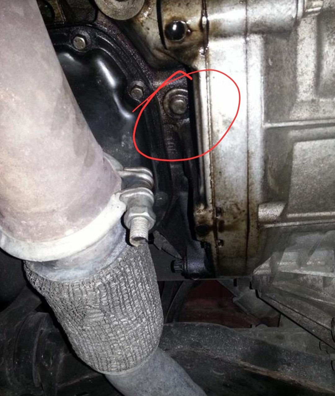

Hi peeps , new here . Don't know how to work this page lol anyone know what these caps are in picture ? Next to sump on 1.6hdi engine
What is this
What is this

I think those are caps over the main bearing bolts - are they leaking oil? Sure I have seem something about this before....

They are the main bearing cap bolts. I would look higher up first before looking here for an oil leak. It's probably a vacuum pump or fuel pump leak. If it was bearing or sump gasket it would be everywhere it could be driveshaft seals either but I still think a gasket higher up.
