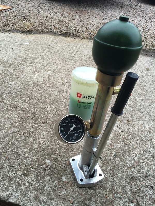

Posts: 11819
Joined: 28 Mar 2013, 21:05
x 1999
Re: Hydralic suspension
Unread post by Stickyfinger »
You need a device like this....
My advice is join your Swedish Citroen Car Club, many of the members will have these in their own garage....l it is common for the DIY Citroen owner to have one.

@ Stickyfinger:
Is there an "how to build one" ?
Greeting,
Kees.
cit-rotti
Posts: 272
Joined: 07 May 2020, 09:19
x 77
Unread post by cit-rotti »
Kees wrote: 13 Mar 2025, 15:58 @ Stickyfinger:
Greeting,
Kees.
The original device had the number Citroën spring ball tester 4135-T - you can still buy it occasionally, it is handy and transportable.
But you can also build it yourself - information and tips:
https://www.andre-citroen-club.de/forum ... derkugeln/
Greeting Wolfgang
Posts: 11819
x 1999
Wolfgang.....you have to be a member to see any images on that site...........
https://bxproject.co.uk/blog/citroen-bx-sphere-tester/
