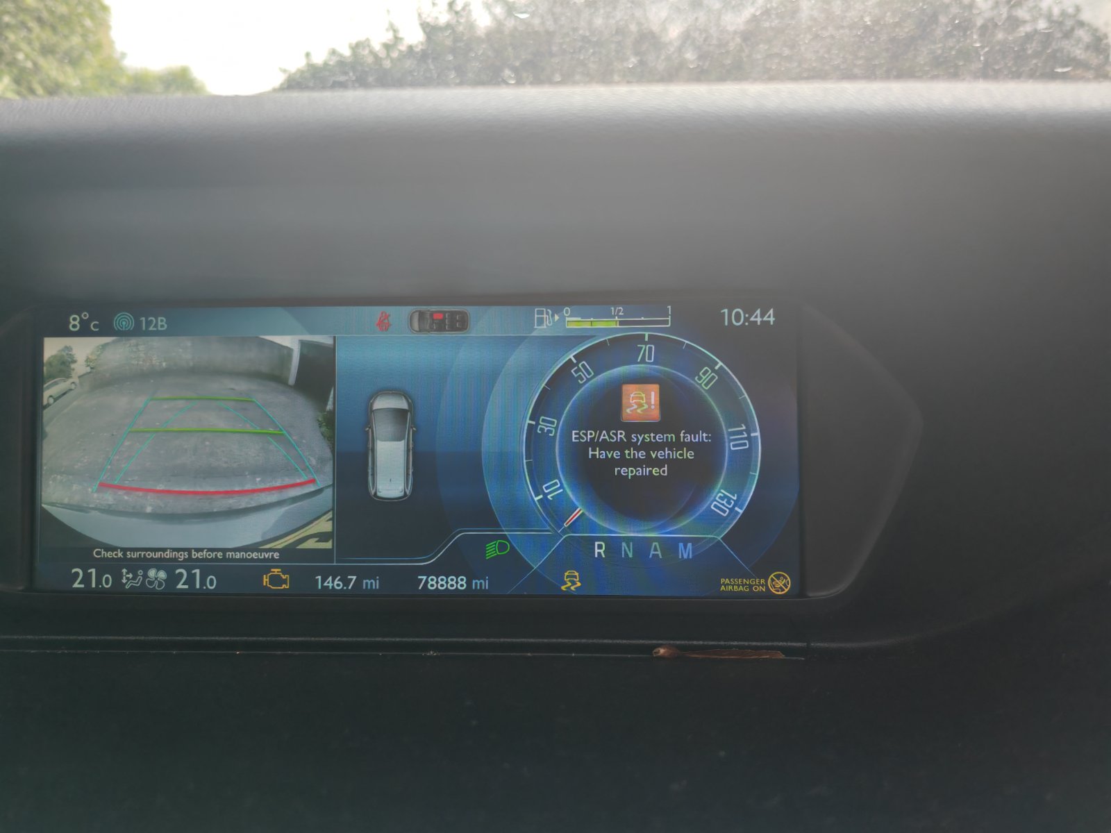

Hi...
I'm hoping someone can point me in the right direction as I have lost the thread whilst looking online.
But I have a 2014 C4 grand picasso 1.6 hdi Automatic.
And since owning the car I keep getting (especially if it's a damp morning) the ESP/ASR Fault light comes up.
Where's the first place to start looking to resolve this please?
I remember someone saying check connections,but where are all the points of connection relating to this?
I'm not a mechanic but have always managed to overcome most issues with my cars in the past with a little nudge from well minded people like yourselfs ๐Ÿ˜€
Any help and guidance will be welcome with open arms!

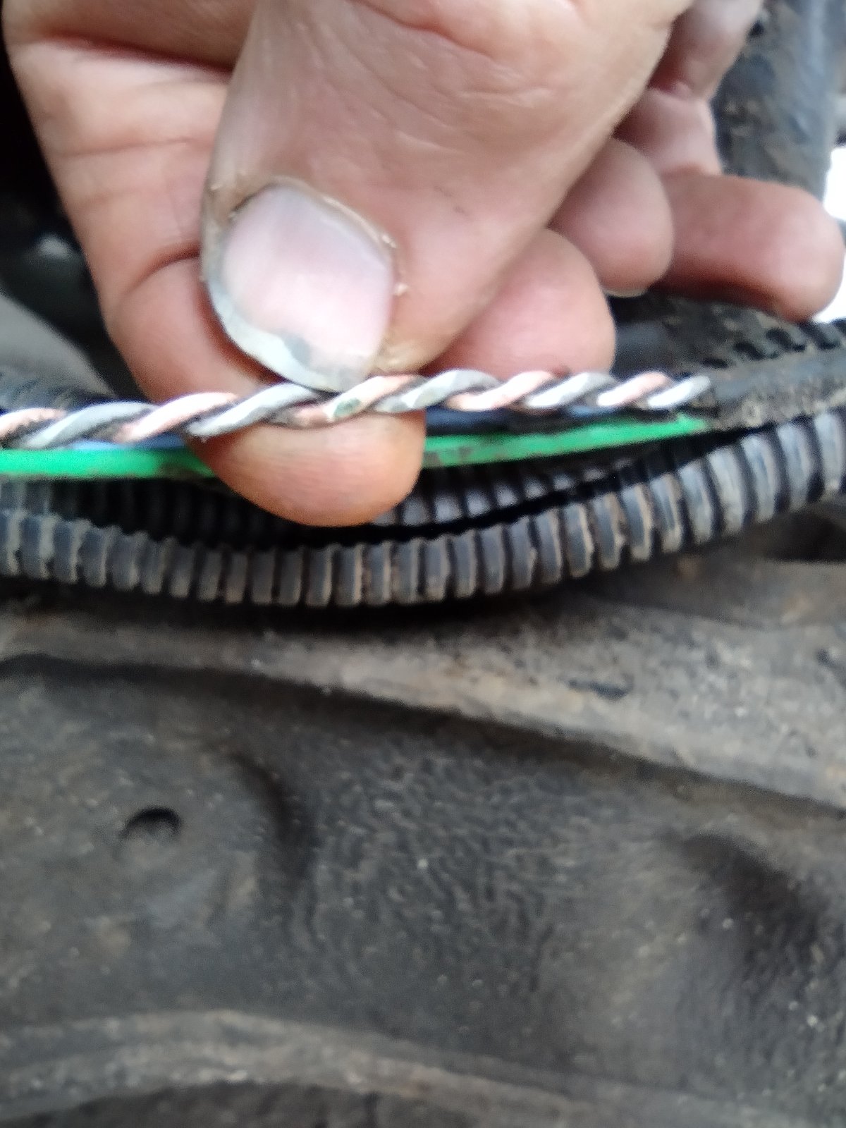

Do you only get this light? These have a common problem that the wiring to the rear ABS sensors rubs through on the trunking and then shorts out when it gets damp. Usually this gives a whole host of errors, but I think is likely the cause of your issue. If you can get it on a diag machine it will point at the offending corner, but if not, you could pull the wires out of the trunking and look for a green crusty spot - it may well be small!

Engine faults can cause the handbrake etc lights to come on - really you need to scan it to see what it is upset about. But, if it comes on when it's wet that's a good indicator you have a wiring problem. With the wheel off you can see the trunking running along the rear arm to the ABS sensor, easy enough to remove the tape and pull the wires out. You might be looking for a very small spot, this was ours last year, duff spot is between my finger and thumb at the corner of the nail!

Oh..just put of interest,how did you repair that damage on insulation of cable??
(Just incase I find a similar damage)
Kind regards
Ian
Forum Treasurer
Posts: 12618
Joined: 07 Aug 2002, 17:12
x 1499
Re: C4 Picasso ESP / ASR fault
Unread post by RichardW »
I had to cut the wire and put a crimp connector in - I thought it was just an exposed spot and scraped it clean, then taped it up, but this resulted in a permanent fault, and when I looked again I had scraped all the copper out - it's a very thin wire!
