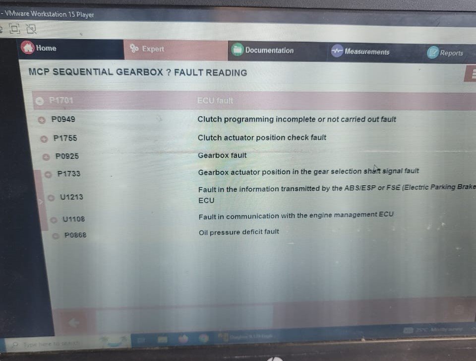

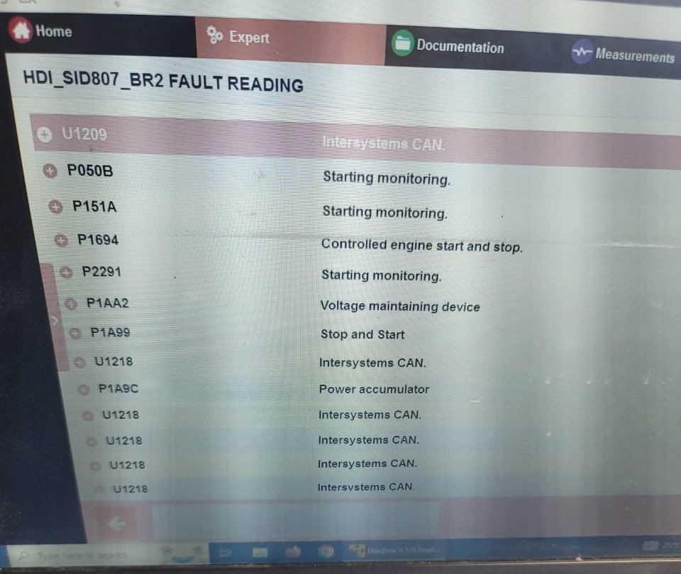

Hey my technician has since installed a replacement ECU together with BSI and car key from another vehicle. The car runs well but after some point seems to lock ABS but then later drives again well. There are several errors picked from the scanner which im trying to attach. Someone could kindly assist to decode the error that could be frustrating smooth running of the car.
