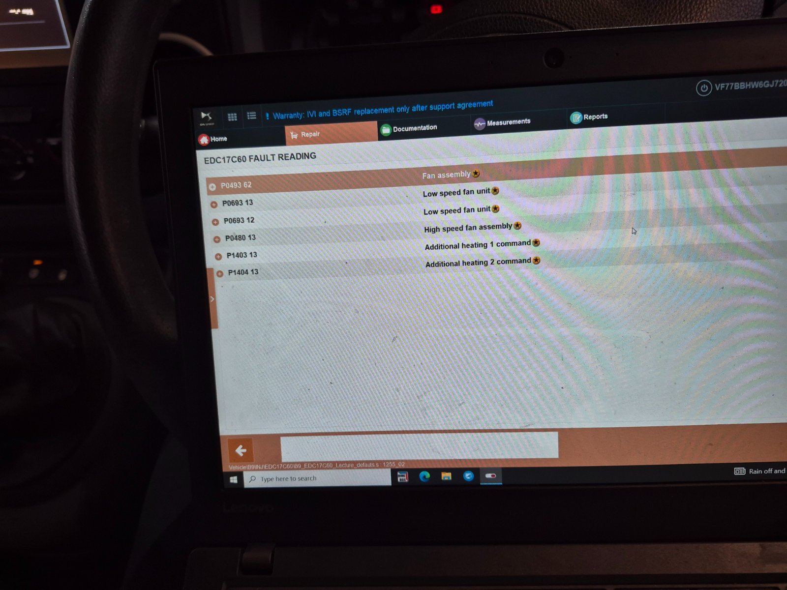

Any help would be appreciated my in-laws Citroen berlingo went into limp mode upon reading codes
We had a head of codes referring to the fan unit we have replaced the front radiator fan resistor with new oem had to change thermostat at same time so coolant temperature sensor got changed with that....

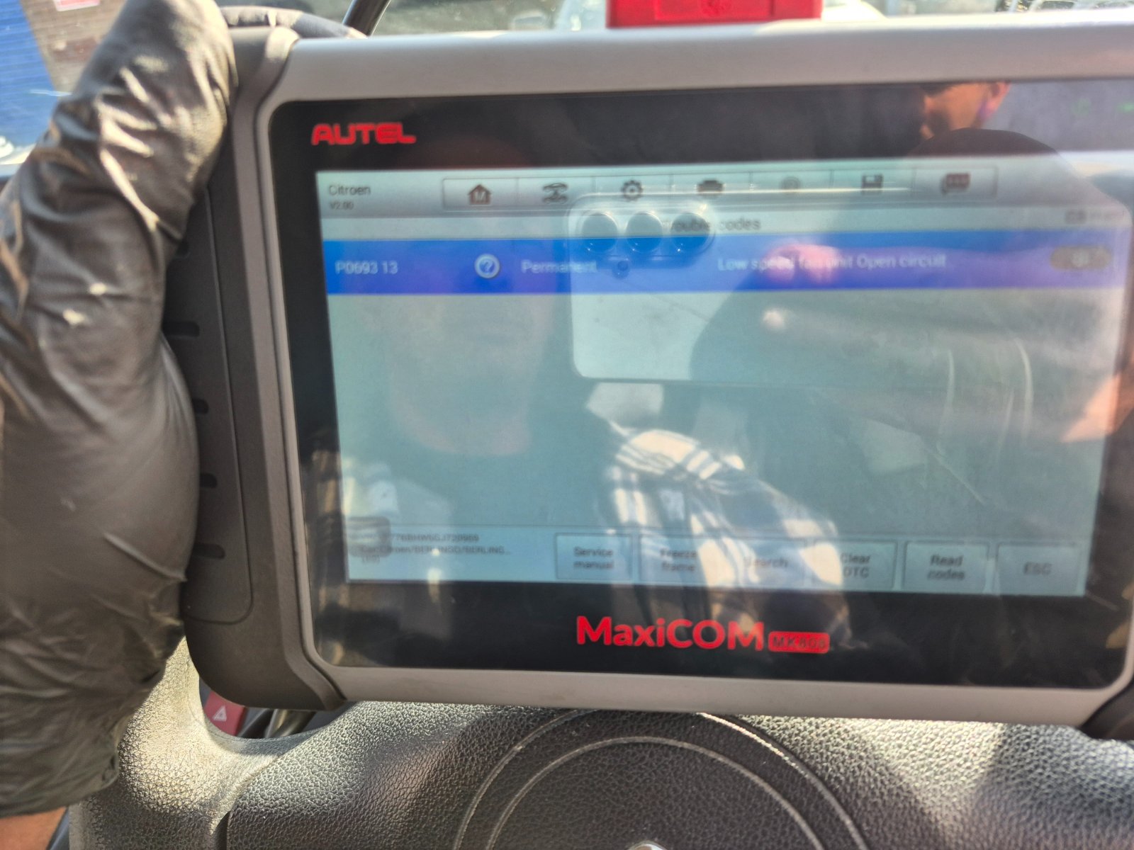

Still had open circuit code stripped loom back from the module and found a cable which was hanging on my a thread... we resoldered the connection and the van is out of limp mode now but still the code is present and the triangle warning on dash is still active
Does this need to be erased with a proper scan tool or would be best to go back and double check for split cables thanks

Looks like a hard fault as showing permanent. Could be a fault with the fan unit, or bad earth - needs a wiring diagram to see what's amiss then you can go looking for the culprit. Post up the VIN, someone may have a diagram.

Problem solved was a split cable in the loom and a faulty resistor (new one was faulty too so be careful) thanks for help 👍
