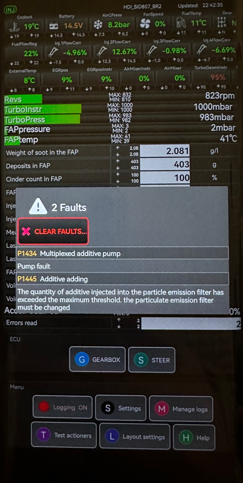

I used FAP app with an OBD2 OBD ELM 327 adapter and received the following errors P1445 and P1434. Erasing them with the app they come again up as soon as the car goes in limp mode.

P1445 is the amount of additive injected into the filter has exceeded the filter threshold. The filter needs professional cleaning or replacing.
P1434 is a fault with the additive pump. Possibly been shut down because of the first fault.
Both will definitely cause limp mode.
This happened after fueling because the additive is injected after at least 11 litres of fuel is added. Running low on fuel didn't cause this issue. Many people regularly run their cars to almost empty with little or no issues.

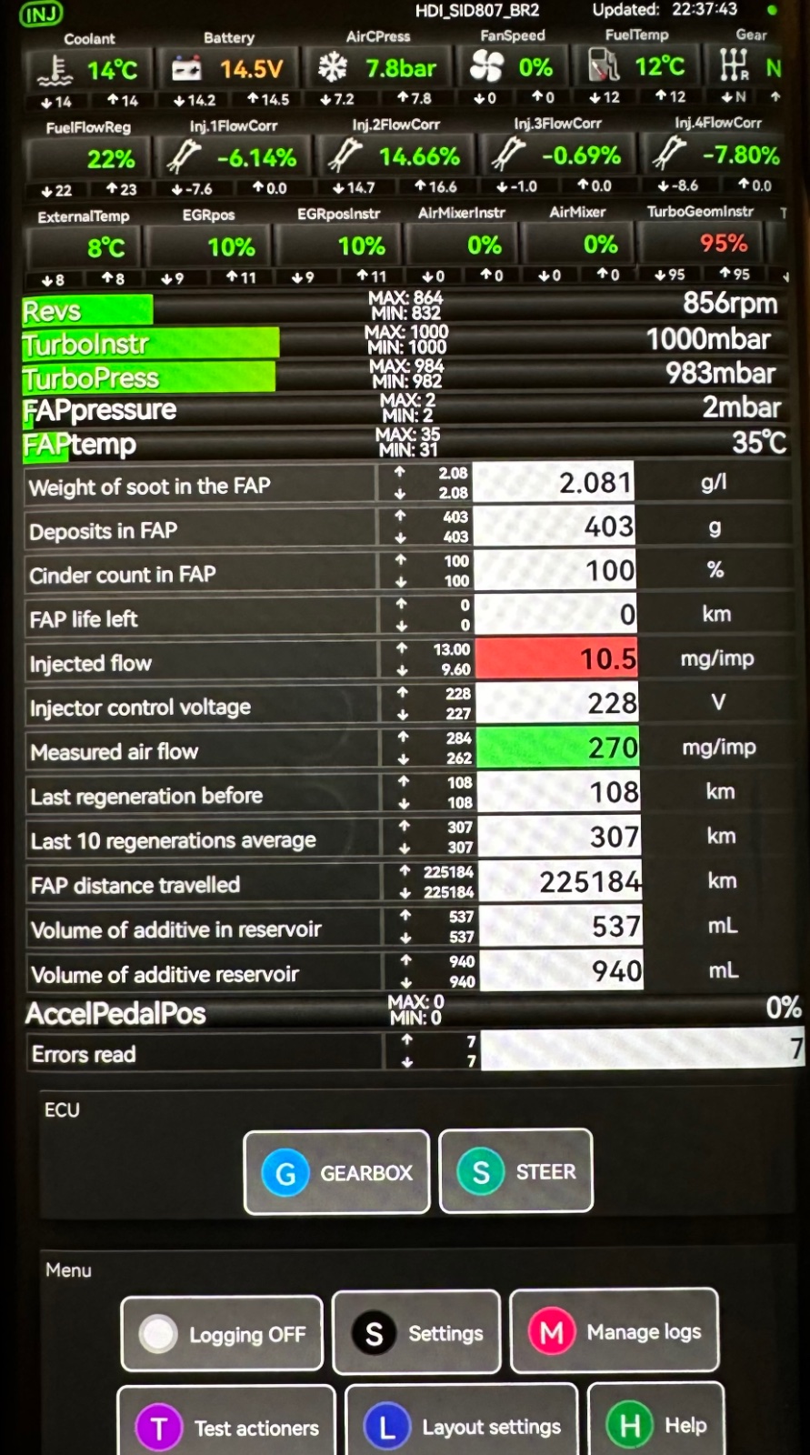

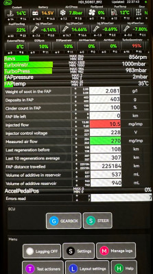

He told me that he believes the fault is in the DPF because in the diagnostic program says that there are 0 Km available and that the DPF os 100% full.
He thought about Eolys but he told me that there was still enough available (something 400ml).
It’s seems that I missed it on the FAP app (screenshot)?
FAP life left 0km!
