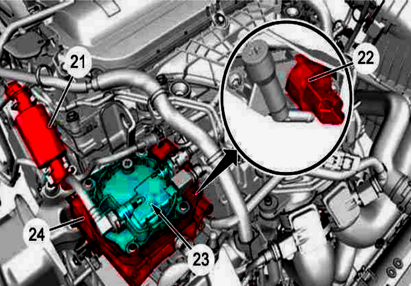

Re: Citroen C5 RDRHHA - P2265 Water in Diesel Sensor
That's because your vehicle may not have been fitted with a 'Water in Diesel' sensor and is only being picked up with the diagnostic as it's not there. Not all C5 X7 engines were fitted with them.
If you have one it will be here at (22):

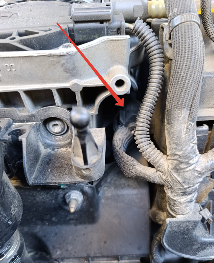

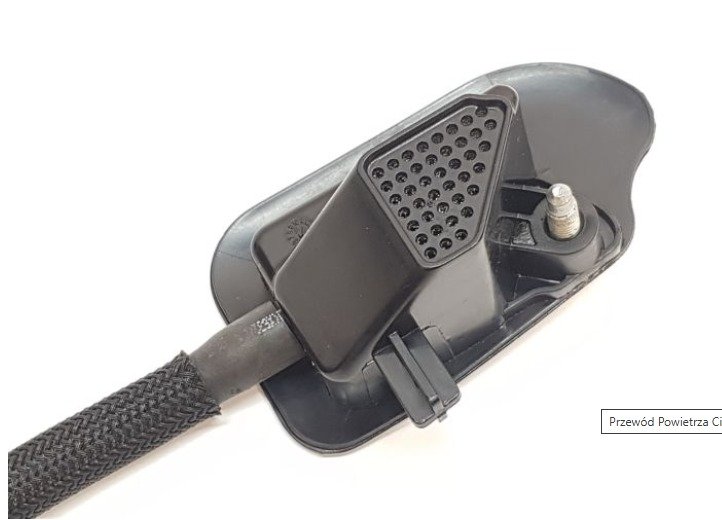

Re: Citroen P2566
This is vacuum filter. When we do smoke test there is so much smoke coming from the bottom of filter case. Is this like a breather?
