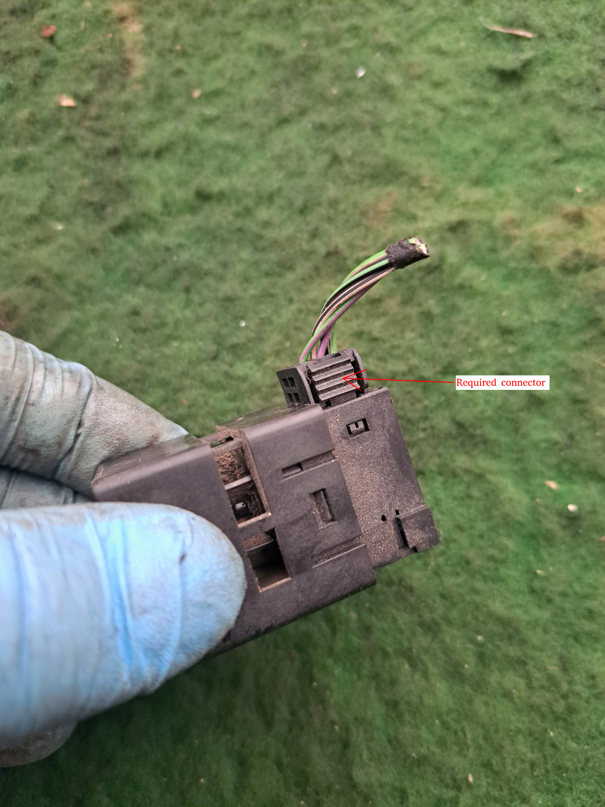

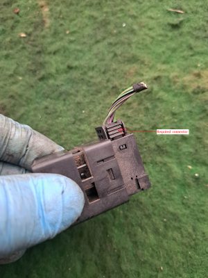

Hello.
I'm trying to find a mating part connector for the sensor 9646573380 (see photo) but I can't find part numbers or anything. Can anyone help me please?

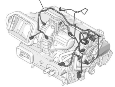

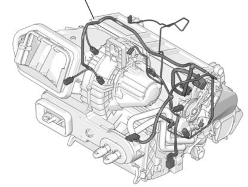

I think you'll find that's the Temperature Sensor (6445VC) and the connector is part of the central wiring harness as shown below:
As there are different harnesses for different models, you'll need to contact your dealer to see if they have a spare connector in their catalogue or can advise of the correct harness.

Can you post a picture of the connector face on with it removed from the component? how many spaces for wires is there?
x 6945
Re: Mating part for sensor 9646573380
It’s likely to be a 6 pin connector, but I can’t see anything that matches in the PSA connectors catalogue.

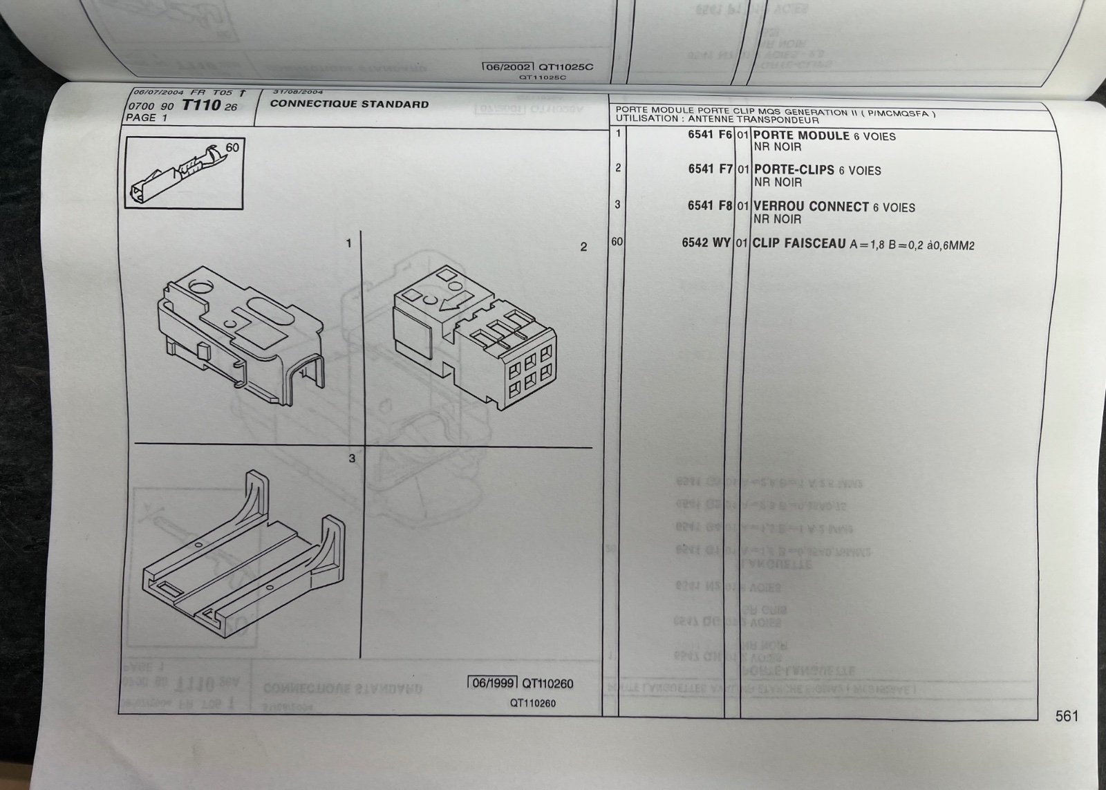

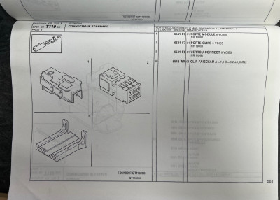

I reckon i know the connector (6vNR) but was just wanting a pic to confirm.
Looks like this one to me but its a 3 part connector 😳 plus the terminals.
You need to order the 3 part numbers & assemble it plus however many terminals you need.
